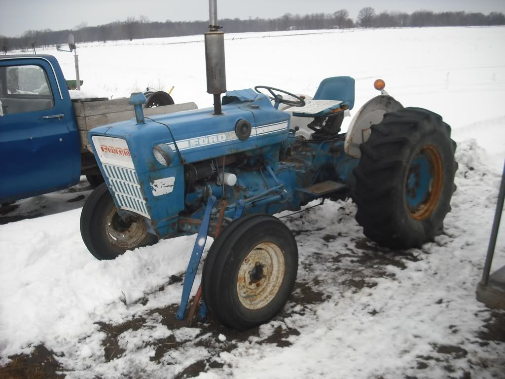

Thanks SoundGuy, that helps alot. I figured I'd put up some pics of my "new to me" 4000. What does SU stand for? Super Utility? :laughing:
I see it has a spin on oil filter. Is that an add-on or were they all like that? Any idea which filters will fit or is it a one use dealer only type filter?

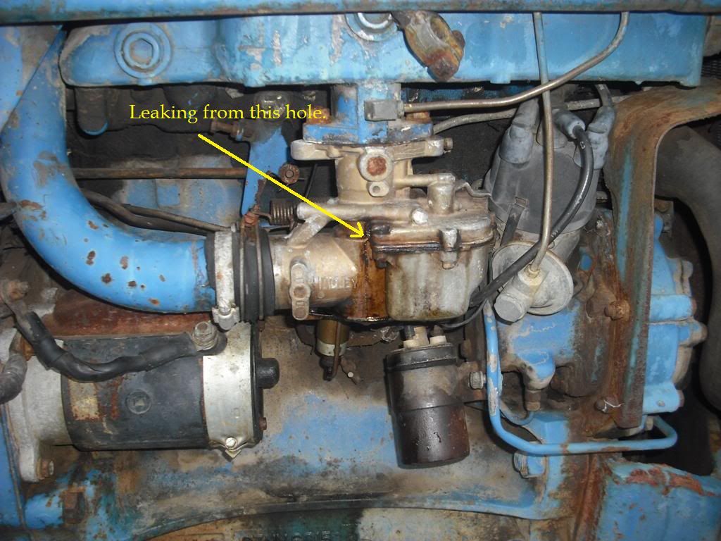

Pardon my Paint hack job but there is the leak on my carb. Am I correct in assuming that is the vent for the bowl and the float was probably just adjusted wrong? I already ordered a comprehensive carb kit and complete ignition tune up kit from ytm. I'll work on breaking down and rebuilding the carb as soon as that gets in.

yep.. the su are basically the back half of a 4000 with the good wet brakes mated to the front end of a 3000 with the weak(er) front axle setup.

About the engine oil filter:
Insert type until October 31, 1969.
Spin-on type from November 1, 1969.
There are conversion kits, so any engine may have spin-on.
Your engine was built in 1970, so it had spin-on at birth.
New Holland 4140 3 CYL SPECIAL UTILITY TRACTOR
New Holland part number for your filter: 86546614
There are lots of aftermarket filters for your engine. I understand that WIX is a popular brand in the USA. They have a nice look up function for filters:
WIX Filters : Filter Look-Up
WIX part number for your filter: 51452
You can then use the WIX number in other manufacturers cross references, like:
MANN-FILTER Catalog North America (Online)
Your oil filter is the same as on most of the 1000-series engines, so it does not matter if you search for 3000 or 4000. Generally, to be sure to get the correct parts for your 4000 SU, search for parts for model 4140.
