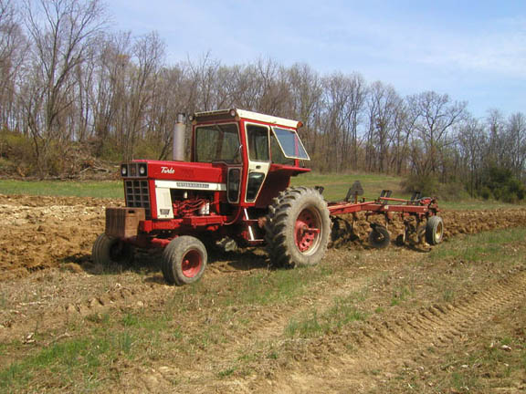

Pic of the ole boy at work.

I've always been amazed at the small rubber the boy's in Penn. have put on tractors! We run the 38" on 1066's and 20.8. The engines have enough torque on our hill's they so to speak go up in smoke!

Al----I wish it had the 38's, would give me better traction. I would leave the duals on all the time but can't plow with them, they are definitely needed when pulling the IH 18 ft disc. It is a heavy old brute.
