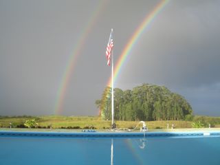

We fly the flag on a steel flagpole here in Jersey. I was looking for some ideas for the Maine place.
Not wood, but you might consider this for the Maine place.
I fly mine 24/7 (lighted) and like that fact that I can raise or lower according to wind conditions. It would also be very easy to remove when you aren't there.
