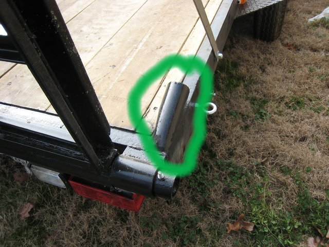

What does this do?
   / A flip up ramp design #4
I am guessing it had a rail at one time and has since been removed and that is whats left of it.

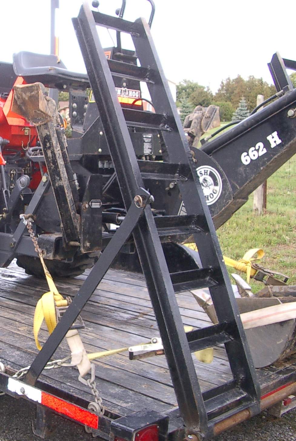

very similar to the way I built mine,they work well. Gary
Chris
Exactly right. The trailer was originally built with rails. About 15 years ago my father had the rails cut off and reattached sticking almost straight out to make it easier to haul hay bails two wide. The rails sticking out made the trailer more than 8' wide.
He sold the cattle about 10 years ago and the trailer has sat in a field rusting since. All of the rust was removed, additional supports were added across the frame, the ramps were added to replace ramps that had disappeared, the legs were added at the back and new wood was installed.
