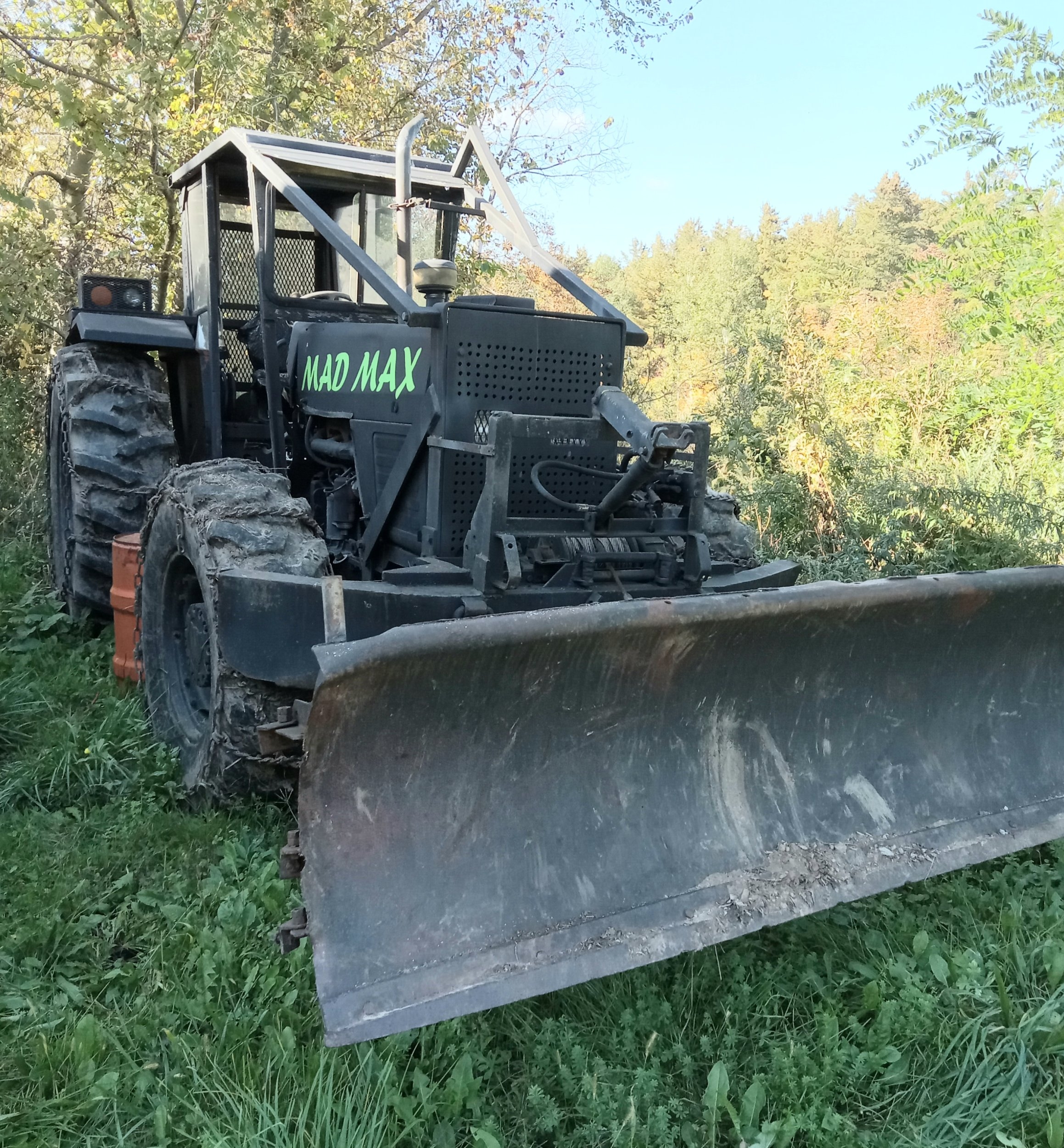

I beg to differ.
This is MAX. 399 Massey Ferguson, 4wd, full forestry package, 50 ton winch on front, 9ft heavy duty blade on front, 7 or 8ft bushhog and 7 ft snow blower set up for front or back. I used it as dozer leveling gravel many times including most recently my 26 x 48 garage. Of course it is set up with a frame that transfers the load from the front to rear axle.

I beg to differ.
That’s a beast love it!
