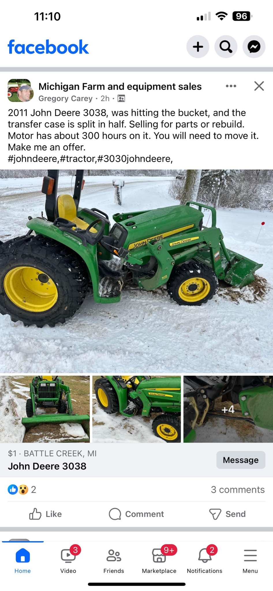

What looks odd, is.. it’s slippery thin snow, so he couldn’t get much force forward, plus there’s no peeling out marks in the snow either.
Some have figured it's photo'd where it happened, but maybe not exactly when it happened.

That's what the first pic looks like to me, the bucket is digging into the ground after going off the driveway. I'd guess he had a good head of steam going, (maybe the tires are loaded as well which would increase the force), had the bucket angled down which then plunged into the ground when it hit dirt, dug in and stopped the tractor cold.
Exactly what I was thinking. The tractors forward momentum would be a frontwards force acting on the bottom of the loader masts. The stopping force would be an opposing backwards force applied through the loader arms to the top of the masts. The tops are not anchored and the masts become levers wanting to rotate towards the rear. The loader mount would resist that movement by transmitting the rotation/torque directly to the mounting bolts and casting. The weakest link was found.

They left the most important character off that model number. It's not a "3038", it's a "3038E", the "E" meaning "Economy". These low-end machine's are Deere's way to try to not lose every customer looking for a more budget-minded machine, but they really have no business playing in this market. Deere makes some great machines, but they're just not going to beat Asian brands when competing for lowest cost/price.
I looked at a few of the 3E-series machines, when I was shopping in 2018/19. No way in hell was I buying one of those economy machines. At least for me, it was 3R-series, or another brand.

I was thinking about how those JD's are designed and if it is like the 3025E, mainly it just needs the hollow cast iron 'spine' casting replaced- probably some new lines and a drive shaft.
The rear section holds most of the good stuff other than the engine.

Might could be welded back together ...
Might/could, but usually cheaper to just replace castings on still-current models. Fixturing that up right for a weld is probably going to cost a lot of hours, and these parts are still readily available.
The first photo was likely taken at the scene within a day of the accident, where the accident occurred. Notice the crisp tread marks going under the tractor, and the bucket in the ground, and the mailbox indicating likely a driveway.
Other photos were likely done after the tractor was moved, and could be several days later. Note grass around the tractor, and bucket no longer stuck in the ground.

Just can't believe there was enough traction on snow to do this. No chains? My tractor starts spinning its Ag tires on dry ground when I dig into a solid bank or ground. Or I blow a hydraulic hose. But the tractor breaking in half? Call me skeptical.
I suspect a pretty good running start was involved.

That's why a sub-frame will make a huge difference!
I noticed that as well, the sub frame transfers the load to the rear axle, not the transmission housing.
