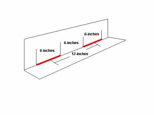

Thanks Mark for your reply, especially to a 'newbie' like me, but I didn't understand anything you just explained.
Do you mean to tack flat bar just around the perimeter of the entire gate and not add anymore vertical angles?
Yes...or you can get creative. Whatever you add, don't solid seam weld it unless you like dealing with metal distortion. When I say "tack", I mean 1 inch welds, multiple, all the way around about every 6-8 inches.

Thanks, but seems like overkill to me. In talking with a couple neighbors today with similar situations they have welded angle vertically, directly under where the tires travel the ramp, and they have held up and been fine for years. As my welder can't weld anything over 3/16" I think I'll weld 2 angles back-2-back under the 'tracks'. I will keep your suggestion of using mutiple short welds to ward against distortion in mind as I progress with my skill, or lack of it. KW
6 on 12 is a very common weld in the fabrication world. That is 6-inches of weld with a 6-inch gap between them. Or 12-inches center to center of the 6-inch weld. But you can substitute the 6-inch weld of 2-inches, 3-inches etc, etc.
