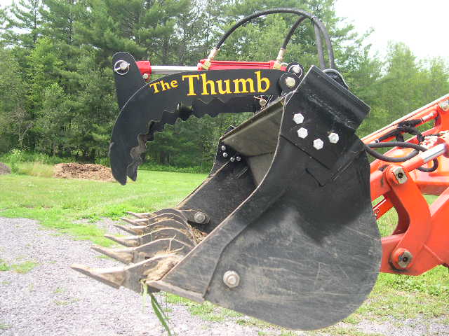

Thanks for the complements Mike. You had a lot to do with it’s success. I am very pleased with the way it turn out. The joystick control gives me the same control as the one you built. I like having everything on the joystick.
The bucket on my CK30 is 54” wide. My choice, I could have gone wider but I like this bucket. So I went with a grapple I found on eBay. It’s made by Green Machine called “The Thumb” and is basically a bolt on. It is 18” wide and divides the bucket into thirds. The top of the factory bucket is not strong enough to support the grapple so I built a frame similar to the one in your project. I used a 2X4X1/4 tubing for the cross piece. If I had to do it again I would use a 4X1/4 channel and save some weight but better over built than rebuilt.
Right now I am trying to get around the fact that the grapple does not close all the way. Not good. I think I am going to have to go with a longer throw on the cylinder to get it down farther. Time will tell.
I tried it out a little yesterday it and it is an awesome addition to the bucket even not closing all the way.

Got the grapple mounted and .....................it won't close all the way /forums/images/graemlins/confused.gif
Whoa, I have just encountered the first bump. I’m going to have to look at how the mounting bar is installed.
It’s going to go a little slow because I am going to be gone for a while, but any suggestions would be welcome.

Al normally it's best to mount the grapple to your mounting bar to get the correct angles before attaching the mounting bar to the bucket. It sounds to me like it (mounting bar) needs to rotate forward a bit to take care of your problem.

After using one of these bucket grapples my take is that I would rather have it close all the way down than open all the way up.
Most logs that we pick up can easily max out our loader which is rated at around a ton. Have not grabbed one with yet with to large of a diameter that could not be put in the bucket using the grapple. Sometimes however you will want to grab something smaller in diameter and you will need the grapple to close down a bit more to do so.
Still think it would be easy to remove some of the bolts on each end, rotate the mounting plates to get the correct angle, then re-drill the end plates to mount the grapple in the correct position.

Mike, I did just that. I put two bolts in the bottom front holes and rotated it forward. I think it may be enough but I won’t know until Saturday. If so I will fill the other bolt holes and drill new ones for the other bolts. You are right in that if I had mounted the grapple FIRST I would have known all this and saved myself a lot of work. But in truth it is more fun than work so I plow on undaunted.

Nope not cigarettes but most of the brush we are removing is under 3" in diameter so closing all the way or at least close is kind of important.
