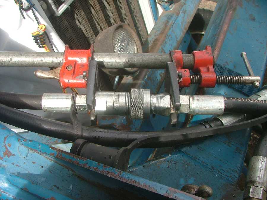

Good idea KC, the only way I could screw that up is if my QC were to bind somehow and the tool would continue to force it together.
Might mess up the retainer balls, what ya think ?

Will, I don't think that you would mess up the retainer balls if a you use common since in putting the coupler together.

I think the tool you made will serve your purpose well.

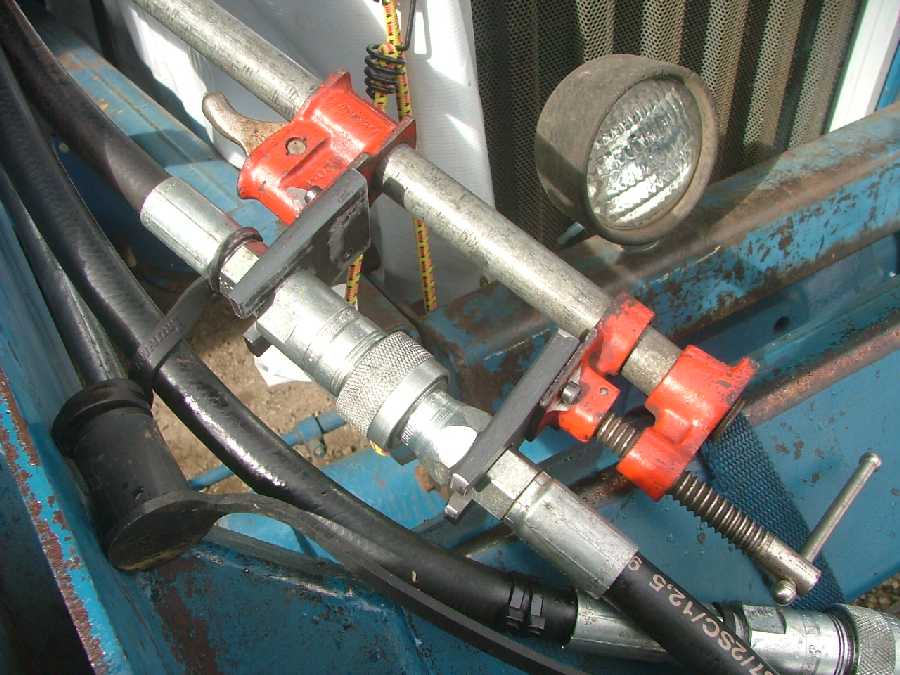

John, here is the tool in place. Man, with a arm like that you sure could use a tool that would help put those couplings together.
Sorry I forgot the pictures.
   / A home made tool
#28
Here they are. The second pic I have a little squeeze on the coupling.

I'm new to hydraulic couplings and have struggled with mine. I think this tool is just what I need, but in reading your reply, I realized that I didn't know this, nor have I tried it. I usually cracked the hose connections to release the pressure.
With Spring here, I'll be putting my grapple on pretty soon and will try your method first. If that doesn't work, I'm gonna make me a tool with one of my pipe clamps.
Eddie
Eddie, the times I had to do it on my Kubota FEL, and my neighbor's hay equipment, it was always quick and easy and just almost no loss of fluid. I never loosened the hose connections, and I think I learned that little trick here on TBN, but can't remember who posted those instructions first.
