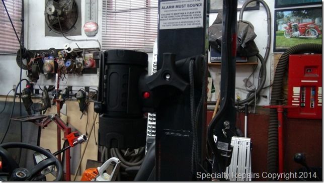

Well my friend for this Click Bond mod I used the two 2" base studs on the FEL and one 1" on the left side of the ROPS. Last evening I made a dolly for the OEM bucket and mounted a new led flash light on the ROPS stud.
This Click Bond product opened up a whole new way of doing things. Hope you had a pleasant flight. Man you sure get around.:D

Now before you get all offended I have always left you great praise for the Mods you do, I just don't get this one.
Why mess up your Rops? The stud system is ok, but really? for a flashlight your never going to use and when you do finally need it, the rechargeable battery will be dead. Unless you take it apart and charge it every week. Or wire it up so it's always charging, but I would bet you have to unplug it after charging, either way it's going to be a pain in the *** You have flood lights all over that tractor why do you need to bolt a flashlight to it.
Why not just get a Surefire or something that takes a 10 year shelf life battery and just put it in one of your two side tool boxes. If you ever need it. It's there and ready to go.
Why fool with that large plastic knob to take it on and off, besides I see one of two things happening, the knob loosing up and falling off or you crushing the plastic handle that you drilled a hole though trying to keep it tight. What happen to the rubber quick straps you use for your snow shovel? I think that would work better then a quick stud epoxied to the side of the Rops. You did a good job with the quick studs on the fel to hold the hoses but that flashlight?

I believe that light to be extremely bright and thus useful and I totally get the need to have a powerful portable light that you can direct specifically at a target. A lanyard on the knob should quell any issue with losing it.

Hey Wax, I'm rereading your post and I don't get it. You say, 'why mess up your ROPS?'. How did he mess up his ROPS? He did not remove the OEM paint as I understand it... and the Click Bond studs are removable if you know what you are doing. The beauty is that one does not have to drill any holes or weld and alter metallurgical properties to install these studs so the substrate does not get structurally compromised. The Air Force, Navy, Boeing, Lockheed and many others with much more at stake than a tractor guy, have blessed this method and process. And yes... if you have flown on an aircraft most likely you were at the mercy of these little parts. Just curious as to what is your issue... the choice of flashlight???

I don't think the bolt on (rechargeable) flashlight attached to the ROPS was a good install, practical or needed. Do you? That is my opinion. Paul lets me know his opinion on my work. I usually hold my thoughts and should, but lately he has made some comments to me so I'm going to speak my mind when I see something I don't like of his. Shouldn't have to be that way but that is the way it is.
I also said in the post I like what he did with the Click Bond on the fel. To me that was a good use for the Click bond product. I like a lot of the work Paul does, and say so, many times, more then most here on TBN but it can't be all fluff, all the time.
I shouldn't have said he messed up the Rops, I didn't know you could remove it without painting. It's better then welding it on thats for sure. No issue at all with the Click Bond system.
