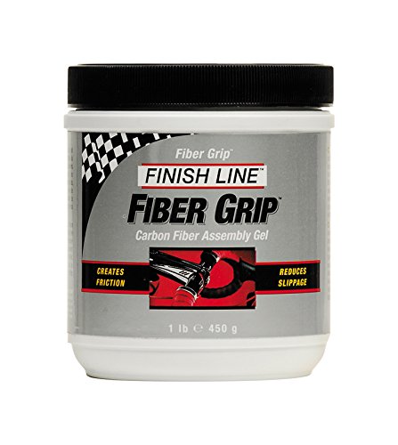

As I stated earlier, all six of the Kubota tractors I've owned use this wheel nut design and I haven't seen this problem. My father in law did have it happen though. He had this wheel movement problem on one of his tractors. He referred to it as "wheel shift". I don't remember which tractor it was. He had several Allis Chalmers and John Deere at the time. This sounds like a crazy idea but he solved the problem by thoroughly cleaning the mating surfaces of the hub and wheel. He then applied a paste containing a fine grit to increase the friction between the two surfaces. I don't remember what it was called but he said it was a product used for, among other things, bicycle seat posts to keep them from slipping when clamped.
I don't know about tractor wheels but this stuff works perfectly on the seat post of my bike.
https://www.amazon.com/gp/product/B0013VDRZU/ref=ppx_yo_dt_b_asin_title_o06__o00_s00?ie=UTF8&th=1
The product is safe for carbon fiber components and it works on steel as well. It doesn't seize and the parts are easily removable.
I'm sure there are similar industrial products on the market using the same friction principle. Might be worth a try.
