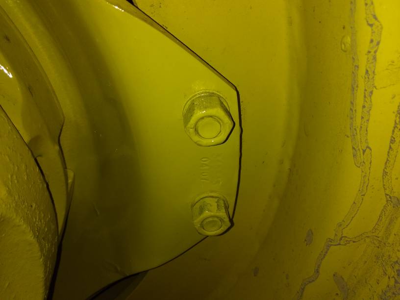

So the lack of flat washers is the key. The other day I spent a couple hours snow blowing and today I did everything I could to put as much stress on the wheels as I could. Monday I removed the broken stud and put the belleville washers on both studs and 2 of the 4 bolts (the bolts are just barely long enough to catch all the threads in the axle so I wanted to have at least two still catching all the threads) on the bad wheel. I did things like skid a few trees and broke some trails that have been covered in snow (this puts lots of sideways stress on the wheels). I even did something I almost never do, I went down to an icy spot on the driveway and used 2wd to spin the rear tires so the chains could rip up the ice. It wears down the spikes on the chain and I'm not sure how good it is on the differential so I try to do it with it locked. After about 4 hours of use the bad wheel didn't move a bit and none of the bolts loosened up.
I got an email saying the bolts I ordered have been shipped so hopefully by next week I'll have them. I'm going to pick up some 5/8 grade 8 flat and lock washers and I'm going to do both wheels with both. The bolts are long enough so I can put nuts on the backside but I may not bother. Here's a picture of the good wheel from a little further away. The dark streaks are from water/ rust from where the center of te disk makes contact with the hub on the axle. Sometimes after snow blowing there's snow that will melt on the wheel. As it runs down it'll leave steaks like that. I'm assuming that the rust is from the paint being removed from the wheel moving over the years.
