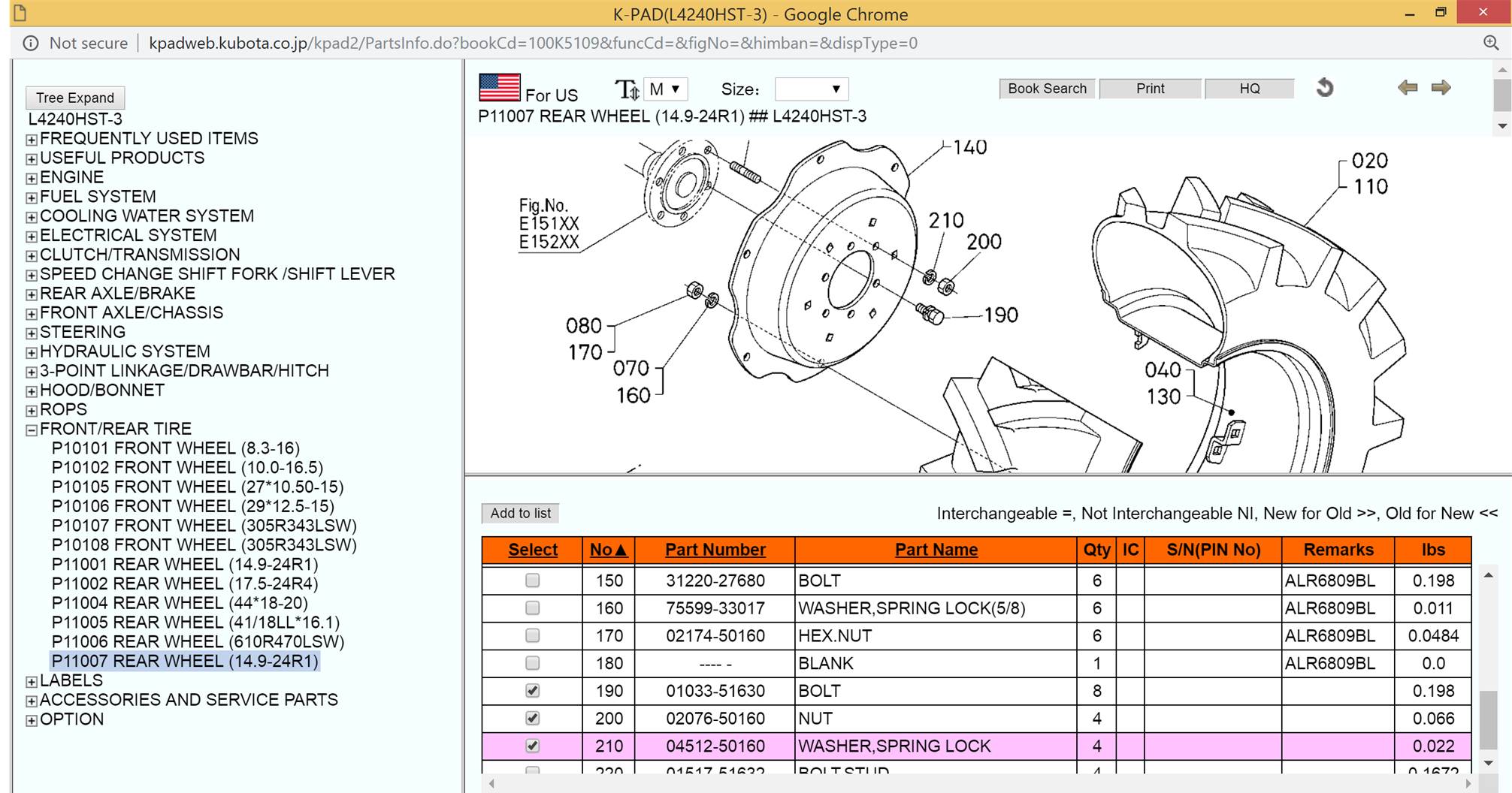

No. I didnt miss it. I addressed it earlier. The fasteners were likely damaged by the wheel movement. Check recommended torque on Class 10.9 M16 fine thread. I find figures for coarse thread cluster around 250/260. Fine thread will typically accommodate about 10% more. So ~275/285
Torque to yield figures are up to 40% higher - - - ~ 380.
Well if you didn't miss it, you certainly don't understand it. Quote from crazyal:
I made the mistake of going a little past the torque for the bolts and broke one of the studs (which is why I'm posting this).
No matter what torque figures YOU came up with, crazyal said he broke one of the studs just by going a little past the torque for the bolts. And the original torque value stated was only 160 ft-lbs.
   / A little disappointed with Kubota #75
If the studs are damaged put new ones in, that design looks flawed bolts are too close to hub to get large thick flat washers under. New hubs will have same problem, only solution is making you own washers, to increase the clamping area.

as has been stated a couple of times, the lug nuts are supposed to be conical, like car and truck nuts, somebody rigged this for failure, maybe they were just too lazy to get the proper nuts, and used flat nuts, thinking it'll work.. who knows what the original owner was thinking before the OP bought this..
   / A little disappointed with Kubota #78
You don’t know that the hardware is supposed to be conical. Until the OP posts a pic of the wheel with a bolt removed I’ll say you are wrong about this application.
   / A little disappointed with Kubota #79
Based on description, I'd say there is no doubt he is wrong.
Kubota DOES use lock washers under the FLAT nuts, on a FLAT dish. Nothing conical on the rears of either Kubota I have owned.
   / A little disappointed with Kubota #80
All one has to do is look at Kubota's Illustrated parts to see the proper fasteners consist of lock washer and conventional nut for the studs and bolt with lock washer for either R4 or R1 rear wheels.
It would be really nice if people would verify info before they post information and state it as fact.
Good luck to the OP in resolving the issue.
