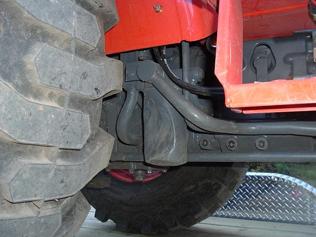

Well folks, not sure how it happened but in the attached picture you can see a crunched Hydro filter. I noticed no difference in operation and the other filter didn't heat up. As soon as I noticed it I headed for the trailer. It appears that the damage was not from below but rather from the side and above so a skid plate may not have helped.
So now at 46 hours I will go ahead and do the 50 hour service.
My dealer is about 1.25 hours away and I have a good NAPA dealer close by. My question.... what are the filters? Does anyone know the wix equivalent? For all three? I plan to find some hydro/trans oil for the tranny and delo400 15-40 for the engine oil. Anything else?
Oh and I plan a filter autopsy to see if the filter media ruptured and spilled the trapped dirt into the hyd fluid.

I just did one similiar to yours and it created quite a hyraulic leak.....and might I add in not a real accessable spot! My filter crash forced an early 100 hour service along with a second hydraulic fluid change........ /forums/images/graemlins/smirk.gif
See Hydraulic filter crash
I saw no reason for my filter to restrict flow but I didn't cut it in half. The dent on mine appeared deeper but not quite as wide spread as yours.

A little searching on this site found that as compared to NAPA the Kioti OEM filters can be had for about half. The crushed filter was reported as 40$ at NAPA and if the above is true then my fuel is paid for to go to the dealer with just that one filter.
Now I am worried about getting what I pay for. Is the Kioti filter inferior. I mean, I don't want to be putting some FRAM equivalent in there when a Baldwin is available.

Well I picked up the filters today at the dealer. I got two of the filter that I crunched. About cried when I saw they are 40$ apiece. That ain't cheap. Now for oil which I know is cheap and local.
