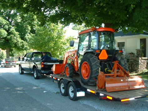

I have had my CCM tiller for almost 2 years with no problems. My local TSC store sells KK but the fit and finish on the CCM is far superior. It is gear drive and has a slip clutch.

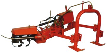

If there are trees in your field, to clean the vicinity of trees, you need a tiller with a "tree sensor" like mine in attachment. Mine is 20", but it's available up to 30". I bought it from a manufacturer here. Requires 20 hp. I believe this is just for the compacts.

My tiller also has a tree sensor. Sits on the tractor seat and just plain evades any trees in site. /forums/images/graemlins/grin.gif /forums/images/graemlins/grin.gif Doesn't cost any extra either. /forums/images/graemlins/smile.gif /forums/images/graemlins/smile.gif
Egon /forums/images/graemlins/grin.gif /forums/images/graemlins/grin.gif
