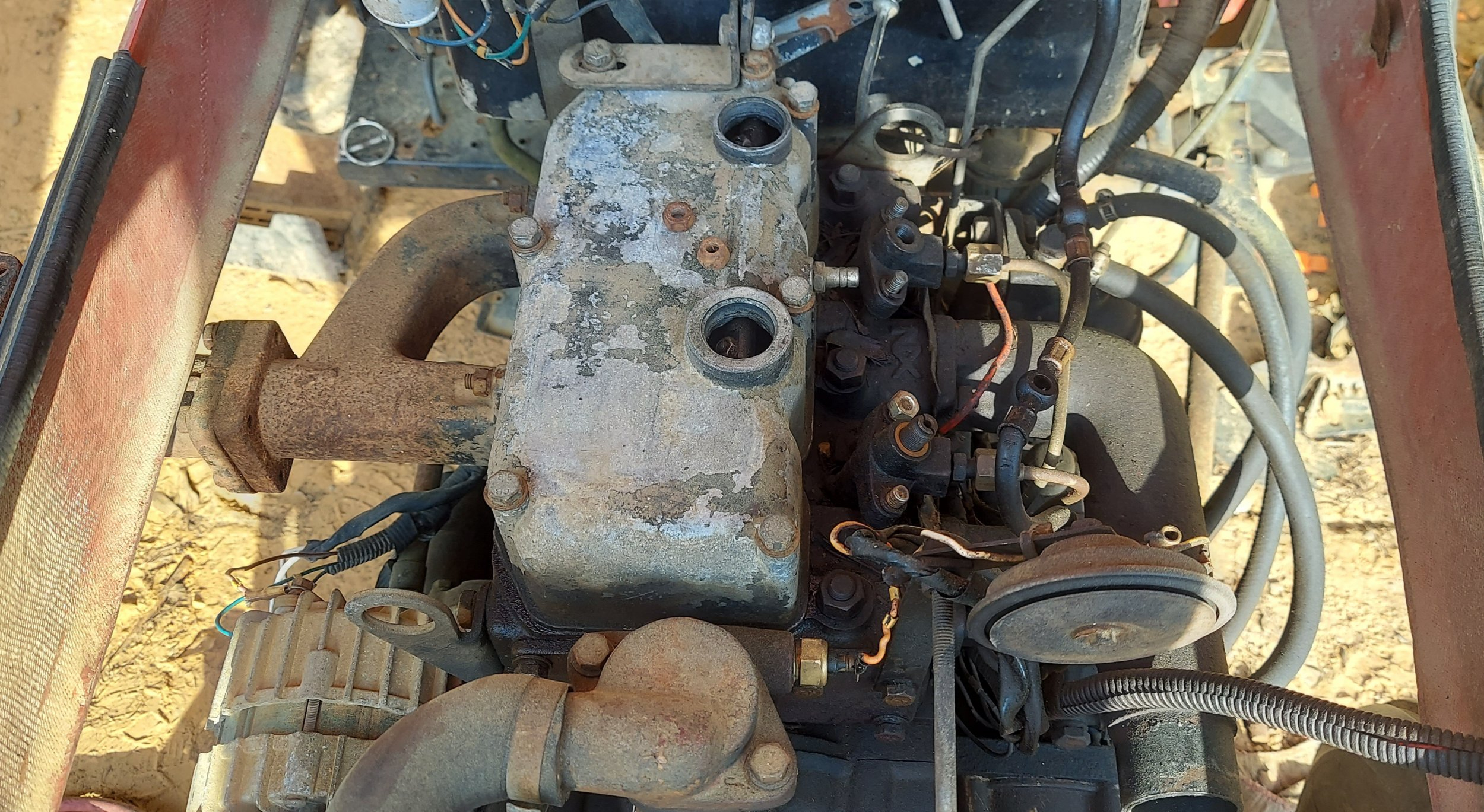

Hopefully im putting this in the right place but here we go. So im getting around to fixing up my deceased fathers old tractor and its missing a bunch of parts its a 2003 ish Homier FarmPro 2420 2wd with 212 original hours, someone tried to steal the injectors by unbolting the nuts off the studs but they also pulled the fuel return banjo bolts off the injectors so im missing those parts as well and cut off the battery terminals, the cooling system is also trashed any tips on what all needs to be done just to try to get it to run for a short time.

Glad to see you want to get it going again. It will take a lot of TLC to get her started but it can be done. I would start by making sure the engine turns free and is not locked up.
/ A little tractor project
It still spins over with a breaker bar and the oil is black but looks good my father got his moneys worth out of it while he had it but its been sitting for the last 8 or so years non running

I have looked around online but most of what im seeing is the entire injectors instead of just the banjo bolts and what not for the return sides of the injectors if I can get those bits it could run.
I did find 1 piece which can be seen someone dropped it onto the top of the injection pump so I threaded it back in

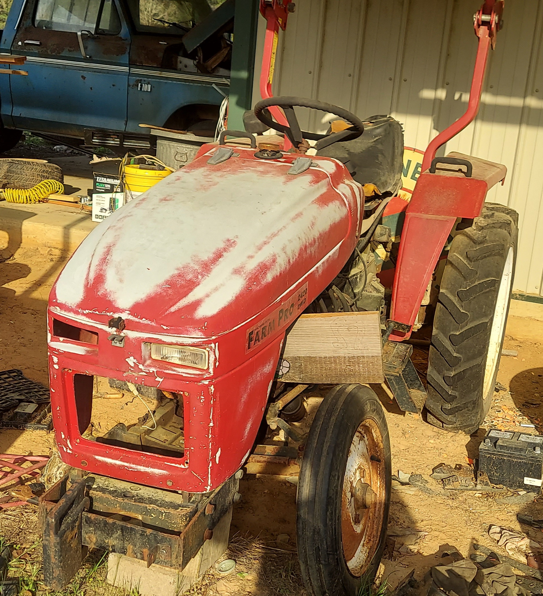

Update for anyone following along so for a while ive been saving up a bit of cash to put towards the tractor and so far things are looking up eventually gonna order the new injectors water pump a full gasket kit for the engine and a starter simply due to both starters I have are junk hoping to have the tractor operable for hunting season this year but im not 100% yet. Also had to move it to the back of our property due to storage issues so its in the weather which sucks.

/ A little tractor project #17
(y) Nice to see your breathing new life in iron some would have given upon.

I would worry that debris found its way into the engine. Do you have it turning freely. You might want to flush it out with diesel fuel - both top flush it out and help it spin freely.
