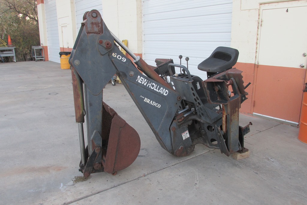

Well, look what showed up Tuesday!!
I kicked the bucket off and chained it to the QA and the tractor will BARELY lift it... Actually, the loader lift got it really light, but not off the ground. I could curl from there though, and the loader didn't settle and the BH lifted... So I was able to move it up to the shop with the tractor from where we unloaded it with a forklift.
It's in workable shape, but it does need some TLC... And I can see a couple of repairs already, including one of the bucket pins being welded in, and some plating at the top where the cylinder attaches to the dipperstick. It could also use a new seat, as the one that's on it is pretty rusty underneath.
I'm about to order some hydraulics to get it to work, and I'll get to building it a subframe as soon as I get my trailer done.

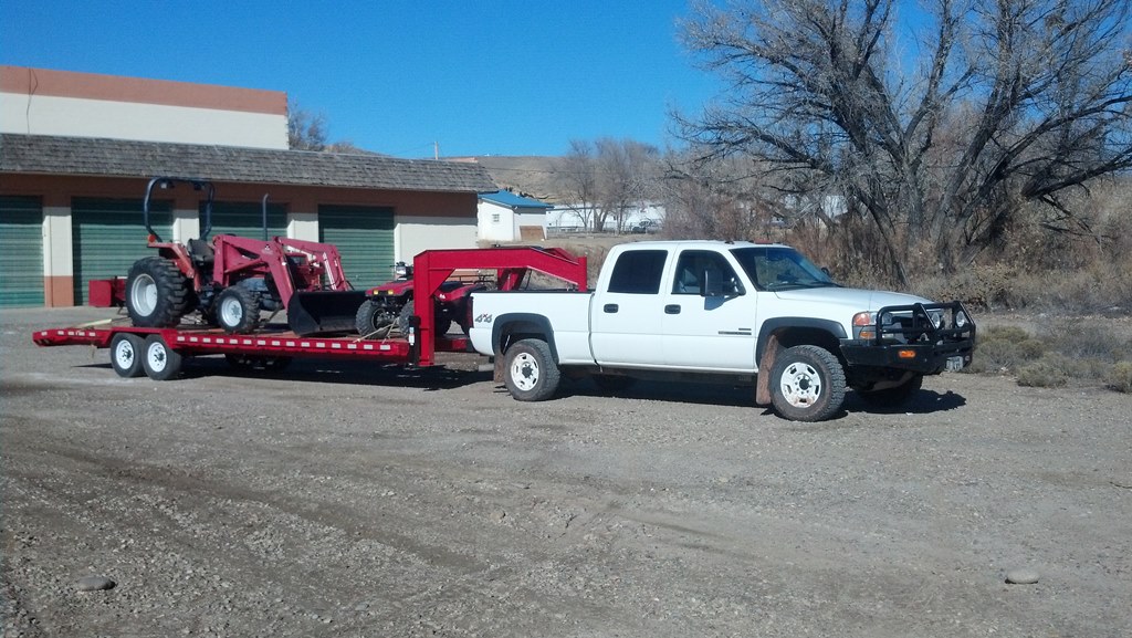

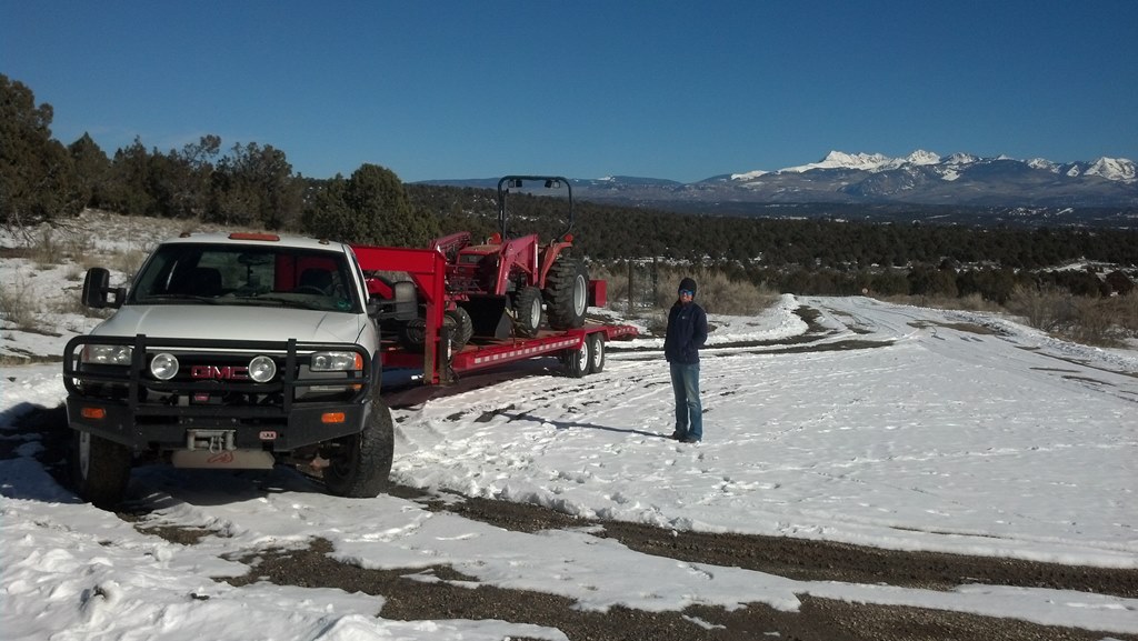

It's been a while since I posted much about the tractor. That's because I was building a trailer. :)
This past weekend we used the new trailer to haul the tractor up to our property in CO and start the process of putting in a driveway.
There was about 6" of snow on the ground when we got there, and I was quite impressed with the tractor's ability to get around, and get things done. R4's are not known for their snow performance, but they seemed to get around fine. It probably helps that I'm a firm believer in running the "correct" tire pressure for the job, which in this case is much lower than "recommended". (I think I'm at ~20 front and 6 rear, and get decent tire flex, and hence good traction.)

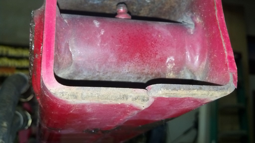

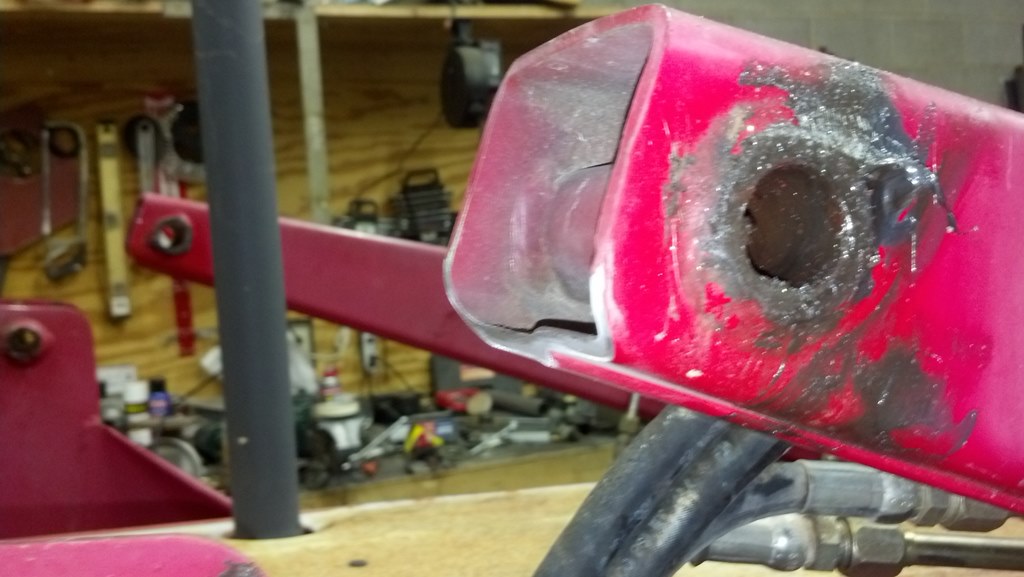

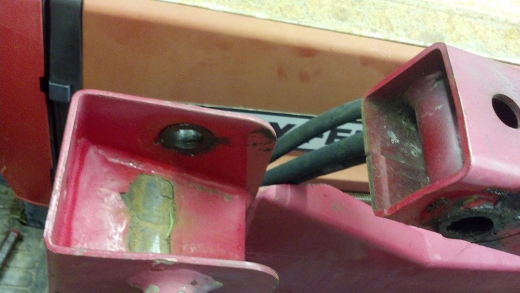

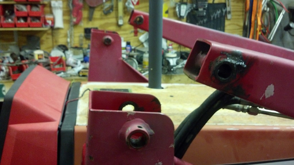

First, the loader makes a horrible screeching noise when it's most of the way up. Makes it on the up, and then on the down too... It was pretty dry when I bought it, but I've greased it plenty now, and it still squawks... Last night I took to inspecting it a bit more. Turns out the back of the loader frame was pressing into the uprights as it pivoted up!!
I pulled the pins and fixed it...
Before:
Scrape marks on the frame:
And witness marks on the loader arms:
And after I used my trusty HF Porta-Band to 45 the lower corners:
I rounded the corners and painted it with some red Rustoleum red that was sitting around. Scraped the rust and loose powder coat off the uprights and painted that too. No more squawking!!

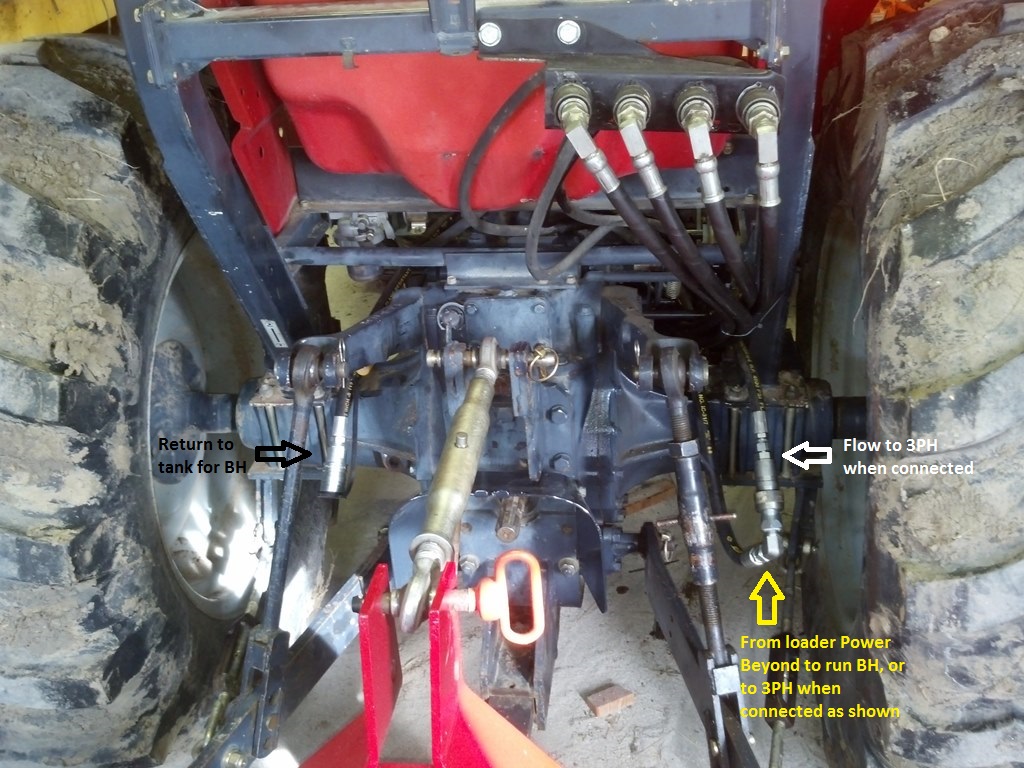

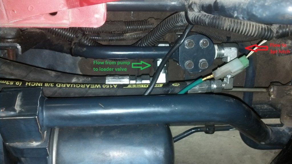

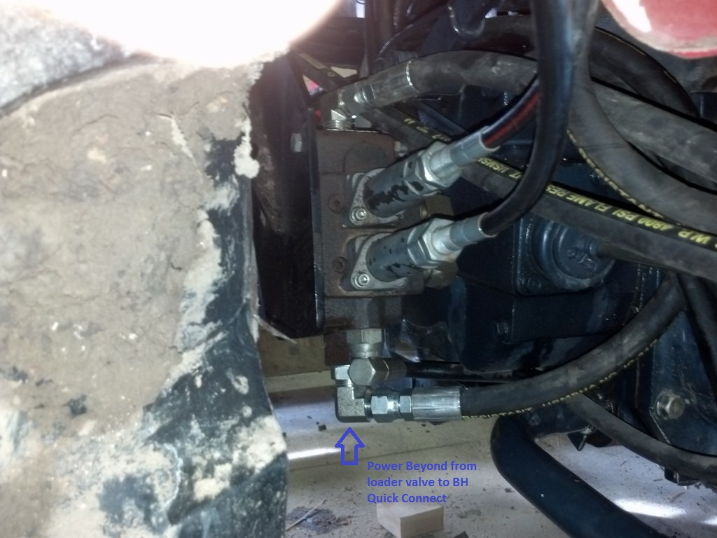

Second, I finally got the fittings I needed to hook up all the Power Beyond hoses for the backhoe, and I took the tire back off and plumbed all the lines.
I used larger hose and fittings where it made sense, hoping to get better flow to the BH. The hydraulics now run the loader via larger 1/2" hose, then out the Power Beyond on the loader valve to the BH quick connect, again in 1/2" hose. If the BH is plugged in, it dumps right to tank through 1/2" hose, and the 3PH is disabled. If the BH isn't there, I plug the quick connect back into the 3/8" hose that feeds the 3PH, and everything works as it always did.
The added bonus of having it this way is that the 3PH is disabled when the BH is mounted, so even if I move the lever, it won't do anything.
I still want to add brackets to each side to hold the female quick connects to the ROPS uprights. I used fittings with double acting sleeves, so if mounted by the sleeve, you can connect/disconnect one handed, and if you forget to disconnect and drive off, it just releases. Genius!! :)

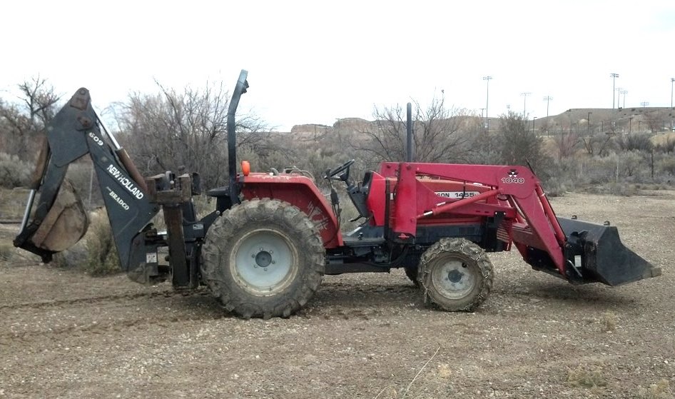

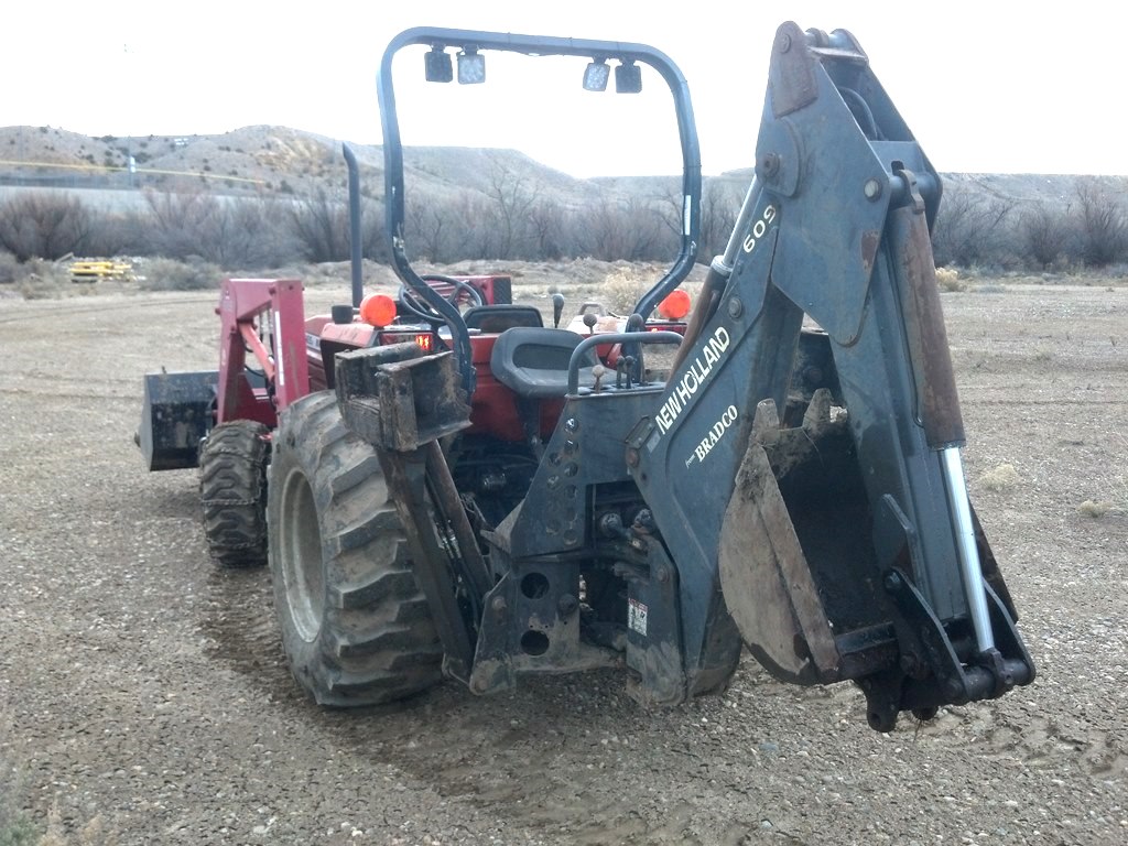

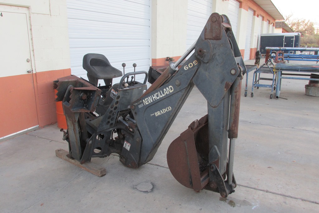

Backhoe mount finished!!
Well, I got the BH mount all finished, and even used it this weekend. It worked great, aside from a badly leaking bucket cylinder. I have seals on order, and will re-seal it myself next week when they arrive.
For those interested in the mount, I did a writeup here on TBN: http://www.tractorbynet.com/forums/build-yourself/373738-4pt-mount-bradco-609-mf.html
A few glamor shots of it here at the shop today:
It's a pretty powerful backhoe... I was thinking the 24" bucket would be too wide to be any good, but it powers right through stuff. I removed three stumps, and dug a sizeable hole before the cylinder started leaking so bad that I had to stop. If I build another bucket, it'll be 12", for trenching, or digging out stumps, but for digging holes, the 24" bucket seems fine. :)

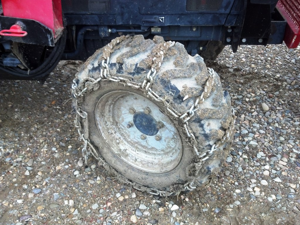

I also made up a set of front tire chains from some chains I had laying around. They were originally for a semi-truck, and I cut them down and shortened the crossbars so they would fit 235/85R16's. I don't have that tire size on anything anymore, so I pulled one cross bar and they were a perfect fit on the tractor!! Helped greatly with driving around on frozen ground and in mud this weekend!
