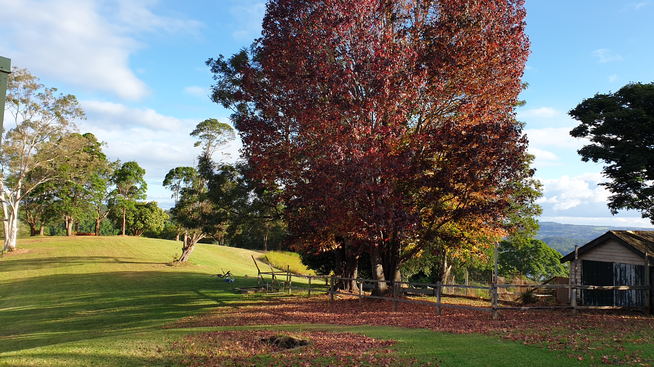

Thank you for this valuable information. I have many more questions and more time this afternoon to ask them. I am going to leave you with two videos from youtube that I found yesterday and a picture of my only relatively flat land. I'll take some of the slopes and send in. I want my land to look a little like the videos and yes my slopes are just as extreme but planted with Setaria grass/ Lantana which is tall and just awful. Call me crazy but I am thinking a front mount mower with dual wheels is perfect for my hills. I'd keep the tractor for the utility jobs and accept it lacks just enough power. What are your thoughts? Even JD is a 20% cheaper than Ventrac and much more powerful. I am yet to find out what kinds of attachments can fit the front mount mowers.
Modified John Deere 158 - Steep Slope Mowing clip 2 of 2 - YouTube
FarmerTorque - Mowing a Mountain! - Ok, a Very Steep Hill!!! - YouTube
The only flat spot:
