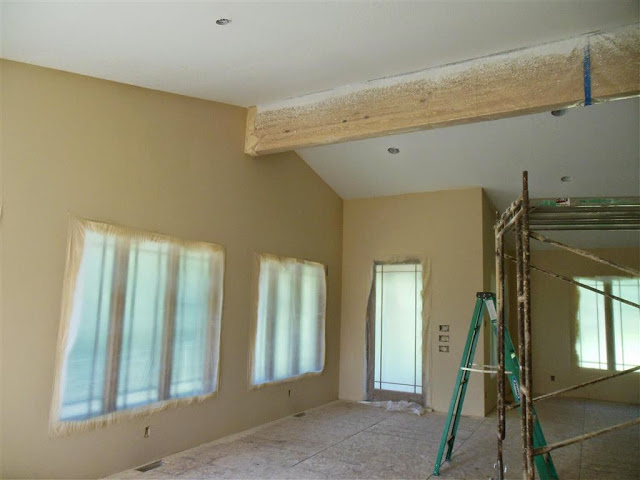

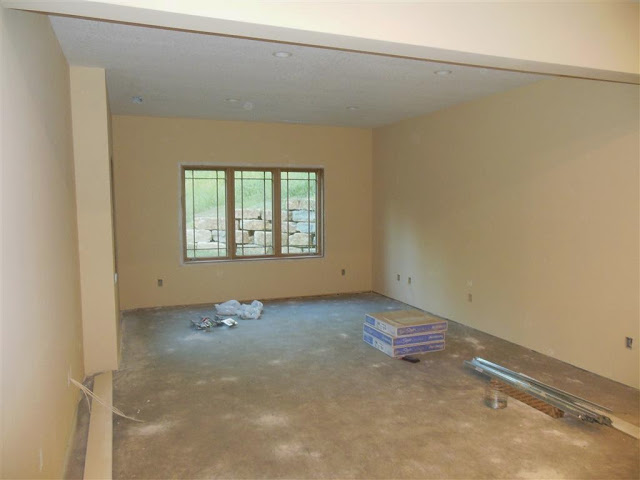

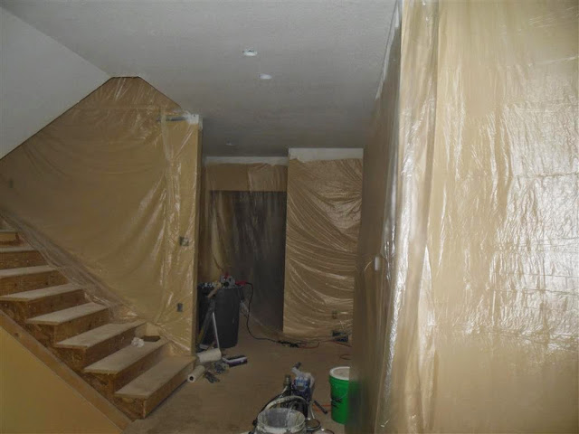

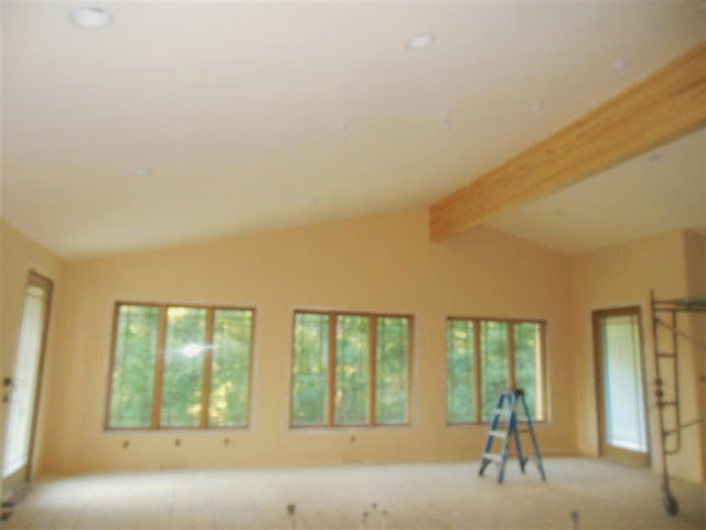

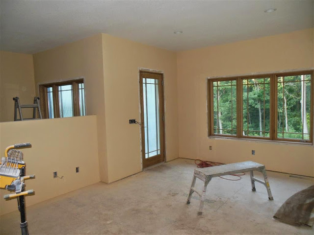

After drywall fully wrapped up, and the subfloor was in, the next big item was interior paint. That sucked up over a month total. We started by spraying the interior walls and ceiling with a coat of primer. That took something like 45 gal of primer, and was mostly knocked out in a day or two. The next item was the walls. Since this is a very open plan, the thought was to spray the walls with the final color (2 coats) since it covers a lot of area and then mask the walls and paint the ceilings. The ceilings are a good item to spray as it goes fast and covers well on the textured surface. We had the drywall guy do knock-down texture on the ceilings. The walls were a little trickier as we found we really needed to back roll after spraying to make it more uniform. This was not an issue on the ceilings due to the texture, but it cost time on the walls Basically this means you spray the walls first, then come back with a paint-moistened paint roller and go over it again. This helps even things out, and gives it a little texture. It takes a little extra time, but not too much as you can lay a lot of paint with a sprayer and then just smoothing it out with the roller goes reasonably fast.
So here are some interior photos of the painting. We covered all the windows first.
Main level:

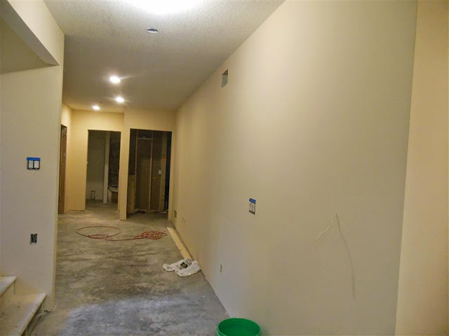

Lower level:
Lower_level_9-14%u00252520%u002525281%u00252529%u00252520%u00252528Medium%u00252529.JPG
Lower_level_9-14%u00252520%u002525282%u00252529%u00252520%u00252528Medium%u00252529.JPG
The lower level BR is getting a suspended ceiling for better access to the mechanicals above it, which you can partly see the framing for that going in here.
Lower_level_9-14%u00252520%u002525283%u00252529%u00252520%u00252528Medium%u00252529.JPG

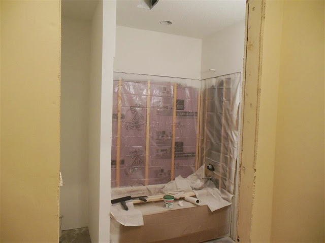

Lower level bathroom. Still need tile in the shower.
Lower_level_9-14%u00252520%u002525284%u00252529%u00252520%u00252528Medium%u00252529.JPG

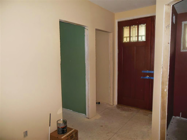

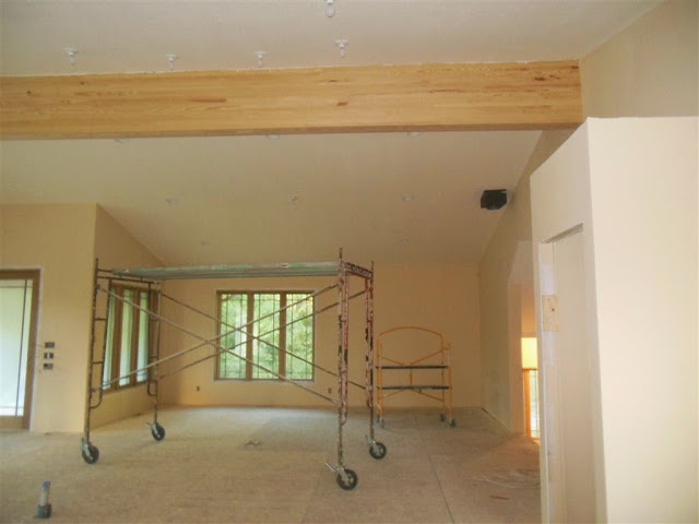

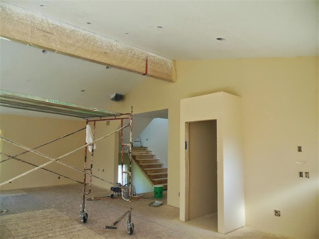

Great room after getting the color settled. Our designer had told us to use a light green for the ceiling as it would look great, but we really did not like it, so she ended up changing it to a cream color. We like that a lot better, so that is what we have. Would have been nice to save the time and only do it once, but it worked out in the end. You can see the Big Beam has the plastic off it finally here, too.
Great_room_9-14%u00252520%u002525282%u00252529%u00252520%u00252528Medium%u00252529.JPG
Great_room_9-14%u00252520%u002525281%u00252529%u00252520%u00252528Medium%u00252529.JPG
The office is a medium green color that we really like, and you can barely see the powder room on the right which is a dark brown/maroon color, which we also really like. Our designer was big help on this stuff as we are awful with picking colors.
Upper level.
Upper_level_9-14%u00252520%u002525281%u00252529%u00252520%u00252528Medium%u00252529.JPG
Upper_level_9-14%u00252520%u002525282%u00252529%u00252520%u00252528Medium%u00252529.JPG
Upper_level_9-14%u00252520%u002525283%u00252529%u00252520%u00252528Medium%u00252529.JPG

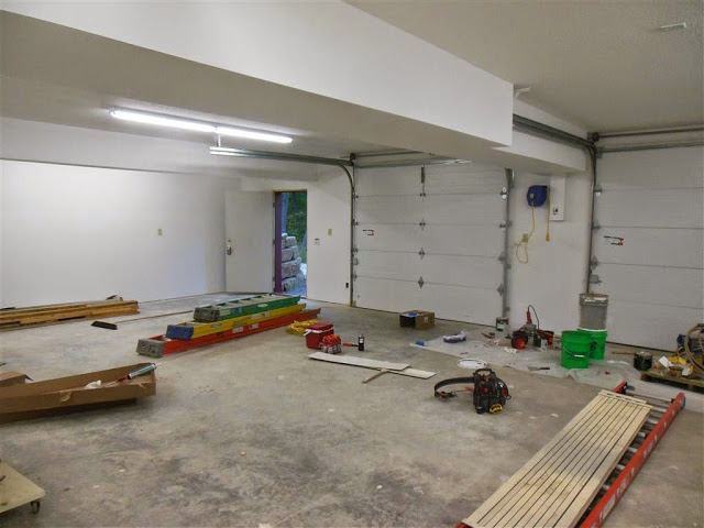

The garage is fully functional too, which is great for storage, staging, and a work area.
We sprayed the walls first, then the ceilings with the logic being that since I was covering so much area, that spraying was faster and you can mask walls but not the textured ceilings. I've never seen the show (no time for TV the past couple years...), but I am told this made it look like something from Breaking Bad:

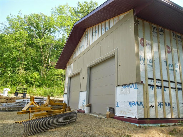

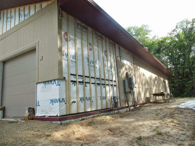

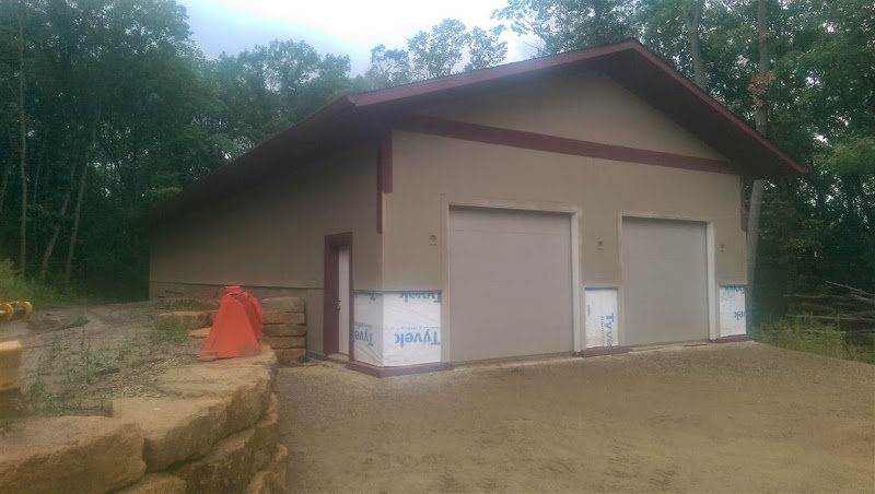

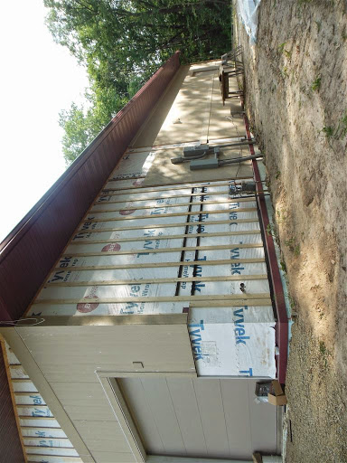

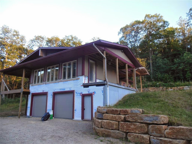

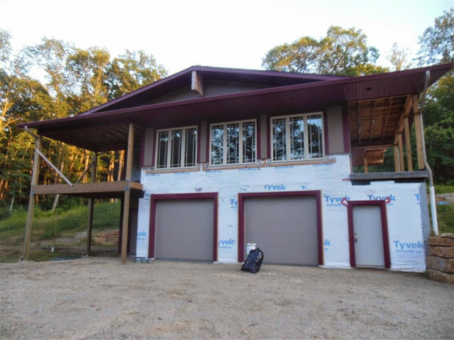

I had intended to do the siding myself, with help, but I came to figure that the task would require 2 people for almost all of it, and that was too much to ask of my helpers, so we ended up subcontracting it. As it was, it took the crew about 3 weeks to finish the job. Most of the time it was only 2 guys working, but about the last week they brought more guys in so they had like 5 guys for the final 4-5 days. This started around the end of July and into much of August.
I didn't take a lot of photos of this. The system I did was to have everything set off on 1x strapping so there is an air space behind the siding for drainage and to avoid any potential water damage. The siding rep loved what I was requesting as he said "you will never have a problem with rot, ever".
Here are a couple shots of the shop as they were doing the work to give you an idea what I mean. The lower sections that were left with Tyvek will be covered in stone next year.
Siding_Shop_9-14%u00252520%u002525281%u00252529%u00252520%u00252528Medium%u00252529.JPG
Siding_Shop_9-14%u00252520%u002525282%u00252529%u00252520%u00252528Medium%u00252529.JPG
And the house in process...

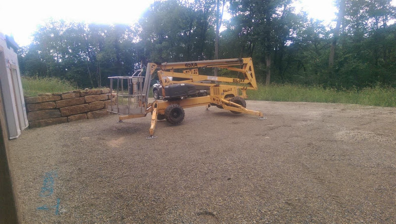

The siders finished up in mid august. In this part of the country that means you are only weeks from snow :). OK, not really, but the weather does turn fast, and getting a decent shot to paint the exterior means that I had to get on it pretty quickly. There were a number of details to clean up first, like getting protective mesh over the air intakes to keep critters out (My HVAC guy already found 2 dead birds in the furnace...). Also caulking various penetrations and getting a number of little details cleaned up. Plus before I started spraying, I had to poly all the windows and doors. I was ready to start painting near the end of august. I took the week of labor day off, plus a couple days at the end of august - roughly 1.5 weeks for paint. I spent a day covering all the windows I could reach from the ground or from a step ladder. The next day I picked up the lift. This was what made it possible to get the rest of this done in a reasonable time.
Here it is. Small enough to fit on my 16' trailer and light enough that even a half ton truck can tow it, but it can reach over 50' up, and 30' out.

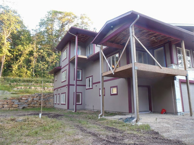

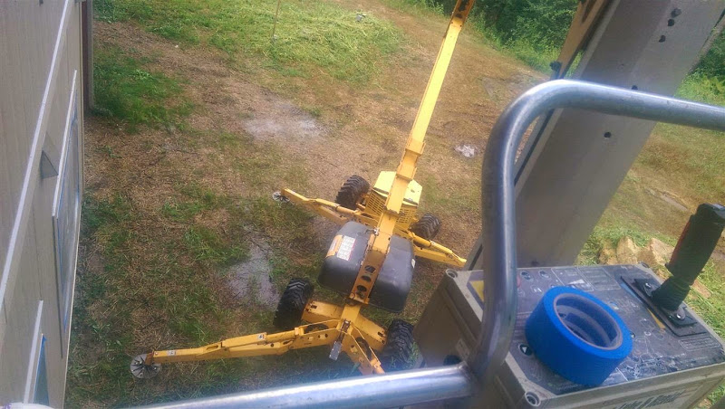

In fact, here I am 30'+ in the air and extended out 15-20' while painting the upper floor on the back side of the house. This is 3 stories on this side. You can see some standing water as we were having some wet weather while I was trying to get this done, but the broad eaves helped keep things dry for a lot of it.
Painting_house%u00252520%u002525286%u00252529%u00252520%u00252528Medium%u00252529.jpg

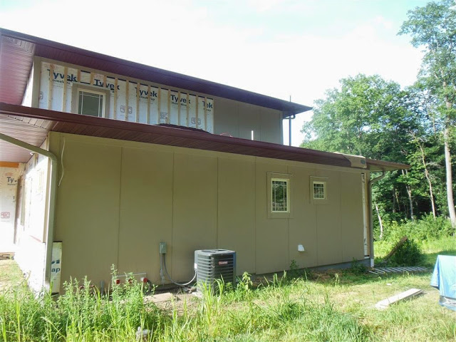

The rental time on the lift was limited to a week, so I did everything I could that needed the lift for in that time. Here you see how I did the upper sections of the shop trim first. Before any trim work was done, I had already sprayed 2 coats of the beige on the entire shop and house (with the lift too). This was complicated by the fact that the lift blew a hydraulic hose on day 2 and the rental place "fixed" it with an idiot repair that lasted about 2-3 hours. I lost time with that as it was over the weekend, but I kept going with ladders as best I could, and they extended the lift rental to compensate in the end.
Painting_house%u00252520%u002525288%u00252529%u00252520%u00252528Medium%u00252529.jpg
The house with first coat on trim mostly done.
Painting_house%u00252520%u002525281%u00252529%u00252520%u00252528Medium%u00252529.JPG
The back side of the house with trim complete. That is where I was taking the photo from in the earlier pics from the lift.
Painting_house%u00252520%u002525282%u00252529%u00252520%u00252528Medium%u00252529.JPG
