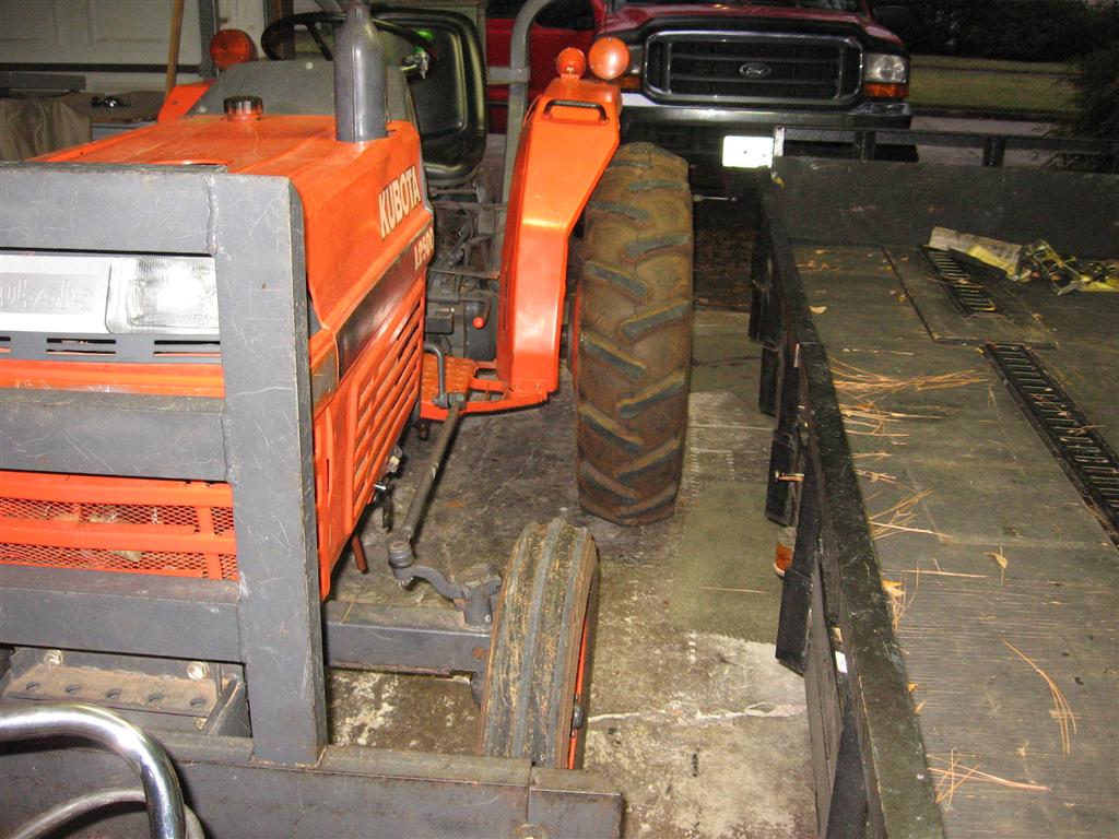

I discovered a slight problem after I took my rears all the way out this weekend. The ramps I made for the trailer are only about 10" wide. So while the backs are on the fronts are barely handing on. I do maintain a pucker factor when loading and unloading you see. I may have to make some wider ramps even thought I only trailer it a few times a year.
Another option is to make the front axle adjustable. Right now it's just a hollow tube. Probably wouldn't be to hard to cut and make an insert. No FEL so it just carries the weight of the front of the tractor. The tie rod would have to be made adjustable, but I'm not sure of the control arm. I might have to scout out some new tractors to look at the set up. Any ideas or anyone done this?

IMHO it would be much better to make the ramps wider than to make the front axle adjustable.
My reasoning for this would be the future resell value of the tractor should you decide to upgrade or need to sell the tractor at some point. Altering the axle would mean a possible problem for a future owner in obtaining parts or adding a loader, even if you can refit the axle to look like a factory axle, it would be a definite turn off to me,

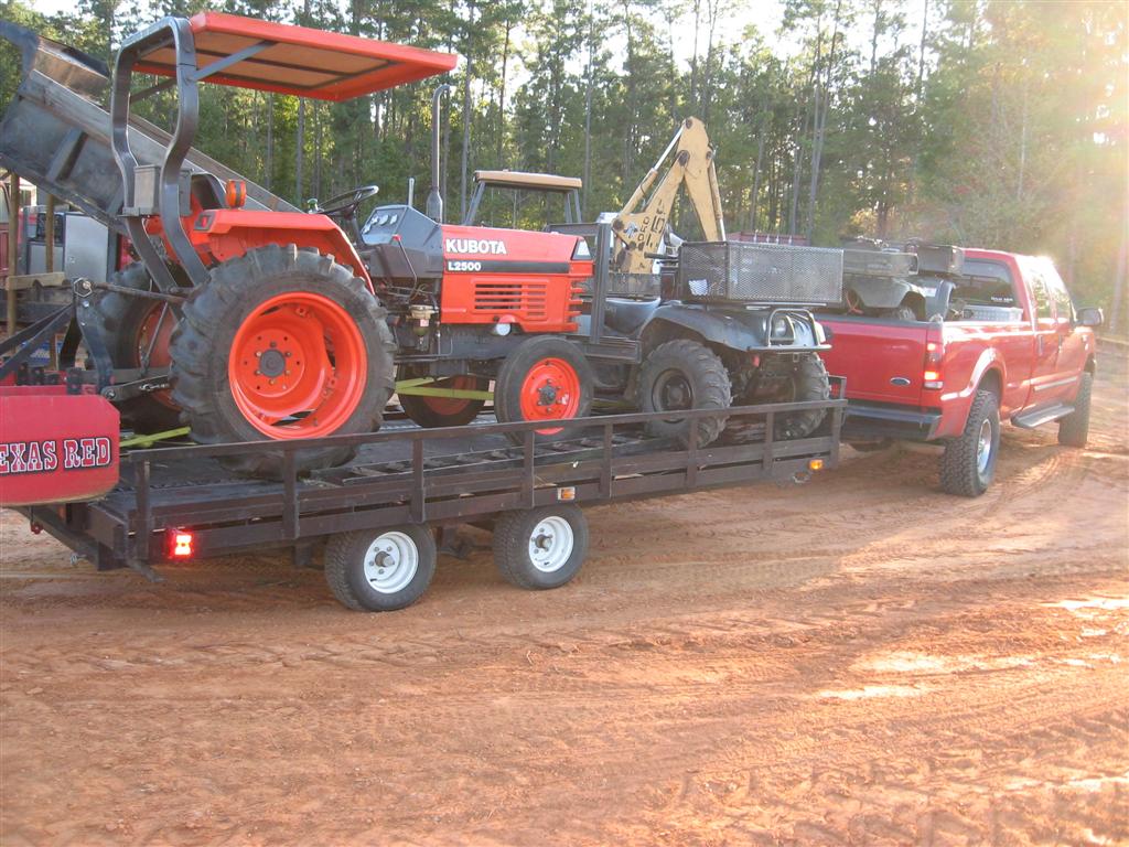

Ramps, yeah I'll probably just widen the ones I have, never liked them because they are HEAVY, about 70# of steel each. They are about 7' long because the sled style trailer I built has a higher deck than a lo-boy. the trade off is the same 5' axle yeilds me a 7.5' deck width and no fenders (in hindsight I should have gone 8', the Texas limit is something like 106"). I just looked up steel weights and rebuilding with 3" channell won't really save me that much weight.

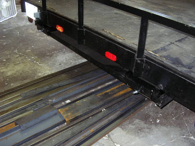

One idea is to put the ramp holders under the trailer length wise of the trailer so all you have to do is slide them out in place instead of having to carry them.

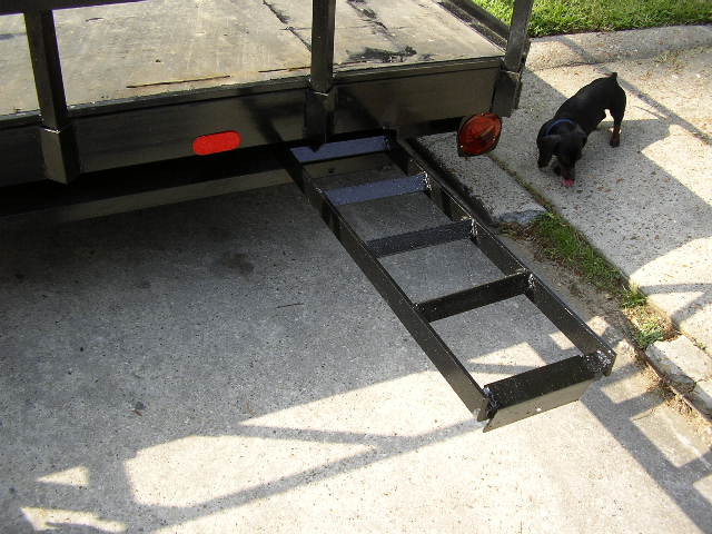

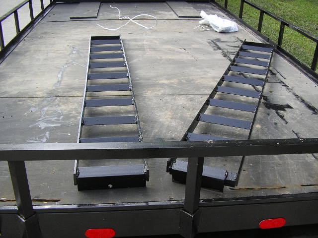

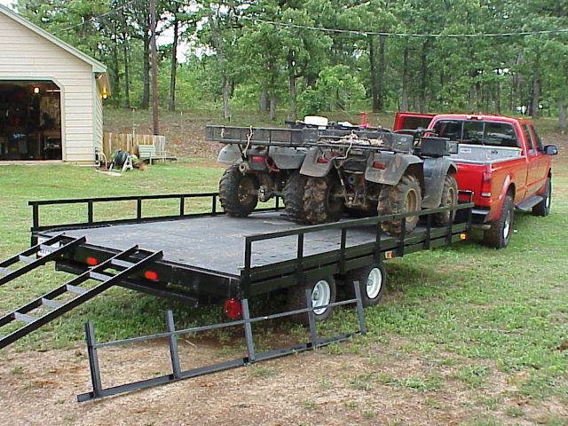

I sort of do that now, they slide under but I put a catch on the trailer so they slide in backwards. the weight is not a huge issue, I can still handle them and most of the time I keep them on top of the deck, even when trailoring the tractor. Just the idea I have to change something and it's not a project I'm really into. :( I also have to keep the ramps adjustable, I can load ATVs side by side facing front or sideways on the trailer.

Can you flip the fronts so they are out wider?
Or are the centered on the rim? Mine were dished and when I flipped them out, I gained about 4" per side.
   / A problem with widening up the rear wheels #10
I had to read every post to make sure somebody hadn't mentioned flipping the front wheels to make the front wider. Sure enough, 3RRL beat me to it again! Hopefully that is all you need to do, but if that won't work, take a disc of steel and build a spacer, rather than modifying the axle. That way you can take it out before a sale of the tractor, and it will also add to the front end weight.
