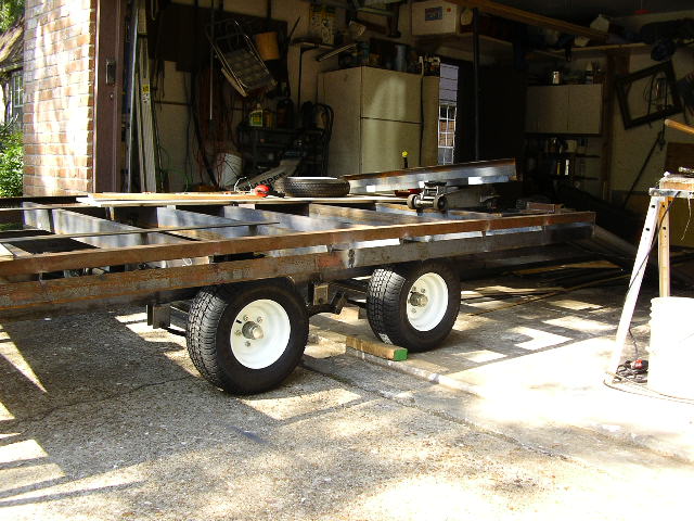

3RRL said:
Rob,
Can you flip the fronts so they are out wider?
Or are the centered on the rim? Mine were dished and when I flipped them out, I gained about 4" per side.
I think on these they are pretty centered, I'll have to doublecheck when I get home. Looking at some pics maybe an inch at best. Good thought.

wushaw said:
Oh by the way what size tires do you have on your trailer?
I think they are 20.5x8x10. Snowmobile or Sled trailer wheels.

john_bud said:
I don't think 'bota like you doing that.
jb
It's not just Kubota...using a different rim offset on any steering axle messes with the bearing loading and alignment. A line drawn thru the steering pivot point should intersect the center of the tire's ground contact point. Probably not as critical on a tractor as a road vehicle, but...

sandman2234 said:
I am pretty sure 'bota would not complain about using their wheels to offset the track of the tires, since it is a very common thing with tractors.
All my owner's manuals said don't widen the fronts, even if you have
reversible wheels. I admit I did it anyway in some cases to reduce
tip-up risks.
