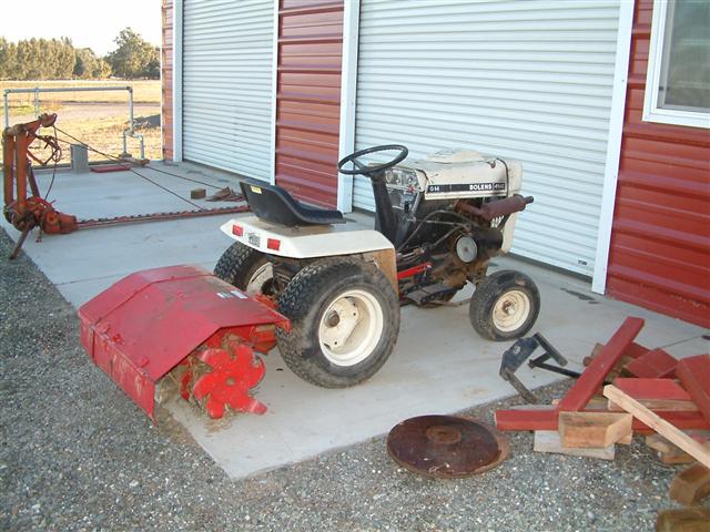

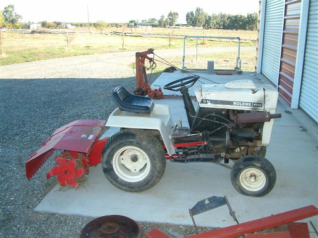

I bought a 1973 Bolens GT1453 about 7 years ago off Craigslist for $600. Included a 48" 3-blade mid-deck mower, a 34" wide rototiller.
It was powered by a 14 hp Tecumseh 1 cylinder, 4 cycle engine. When that engine bit the dust, I replaced it with a 420cc Predator engine from Harbor Freight.
