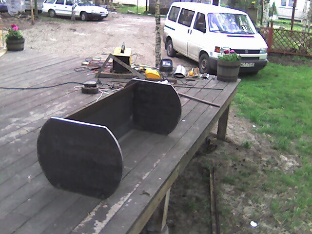

Thanks. You know I really do not have many sketches. I have one that I will scan and try to give some dimensions. I believe that mine would be adequate to 25 hp, but believe that everything could be scaled to a bit larger if you needed.
I centered my rotating pivot, but if you check posts #6, 19 you will see that rich has a Gonnon that is 40 inches wide but the pivot points are not in the center of the side plates. Probably his has a better balance and does not rotate so decisively to the ripper position.:rolleyes: Mine rotates fine, but it may be that his is better. He said that Gannon was willing to custom make him one, so that may be an option if you have a dealer near by that you should try to talk to.
I know that it was not cheap. The side plates alone cost me about $100--altogether I have about $350 in it plus lots of time. i do not know what one would cost from Gannon.

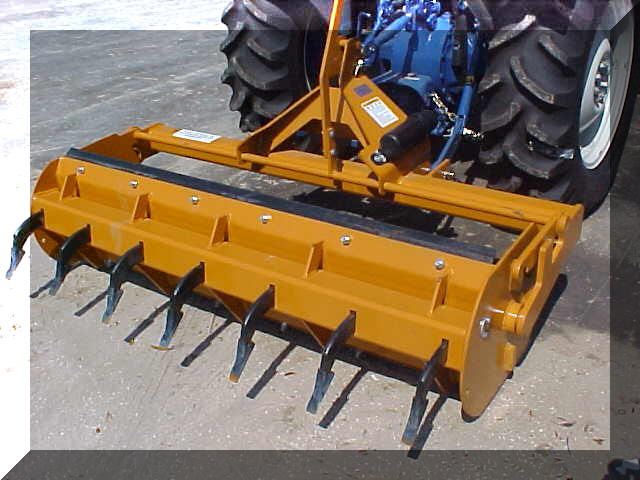

I made mine for standard Cat 1 3pt and almost slavishly copied the design of the Gannon. You can get a few pictures from the parts manual on the Woods Equipment site. Box Scrapers Operator's Manuals
Since I built mine I discovered that Land Pride has a rollover too. Land Pride Box Scraper Manuals
I noticed the main element that rotates is actually flat on the two sides to assist in its operation as a box blade pushing and pulling. The height/depth ration I figur at about 80%. Therefore, my main box side plates are 60 cm by 48 cm. The main box is 120 cm wide (outside to outside) The main beam box is 10mm box with 4mm walls. The side plates are 15mm thick and the drag links and catch arm are 10mm. (I wish that i had used 15 mm thick for side arms. A bit stiffer especially for pushing.)
If I can be of any help or if you want to know a specific dimension ask and I will find it for you. I tried to scan my sketch, but it didn' want to. I need to darken it up a bit and try again, but not tonight.

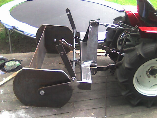

#42

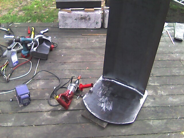

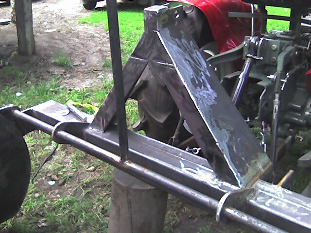

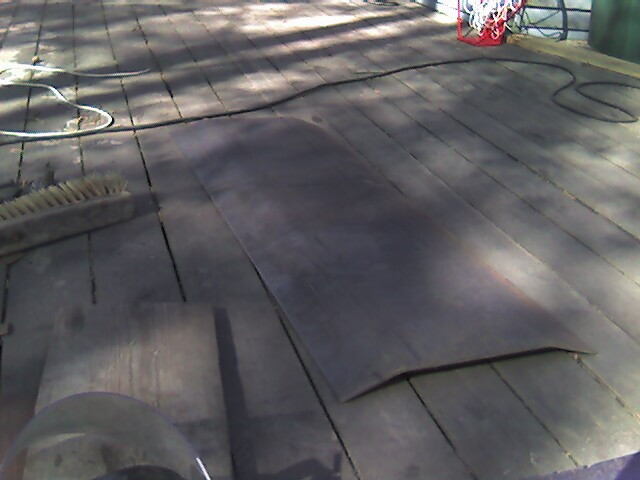

I have attached a scan of the sketch that I made for my imitation Gannon.:D I know that the quality is not the best, but it was the best I could do within the forum's restrictions. I managed to get it dark enough that you can see the squares in the drawing paper. The scale is about 1 inch per line (each square is 1 sq in.).
The blade and the top link mast were made from 6 mm (1/4) sheet. The blade was bent 20 degrees 15 cm (6 in) in from the edge on both edges.
If I can help with anything else just ask.

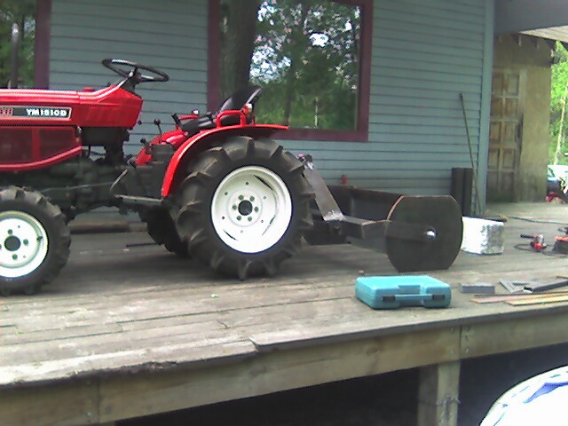

#43

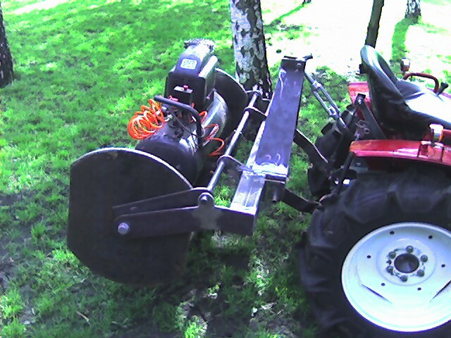

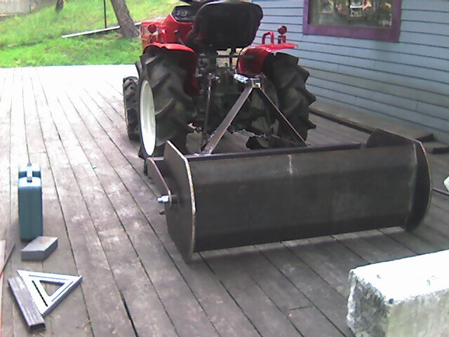

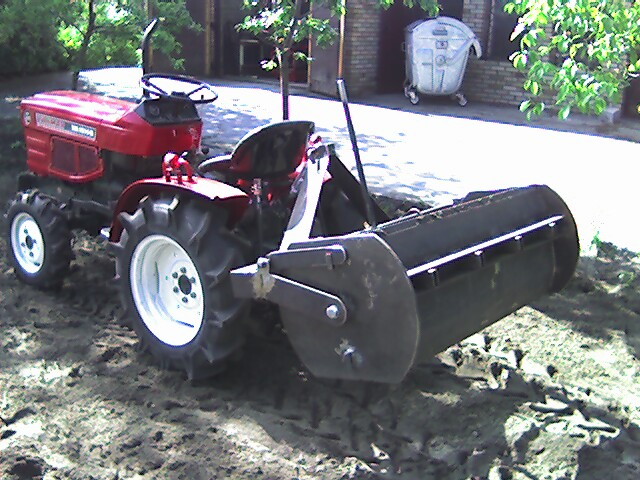

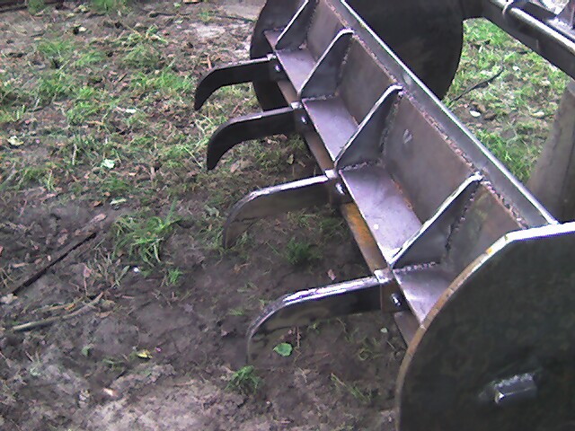

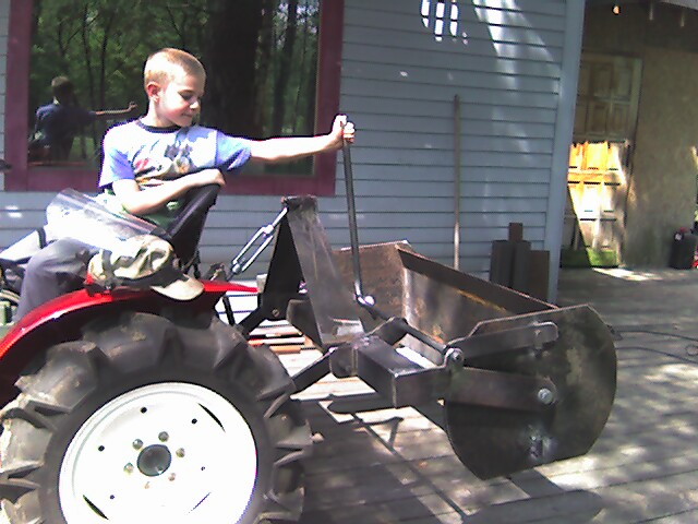

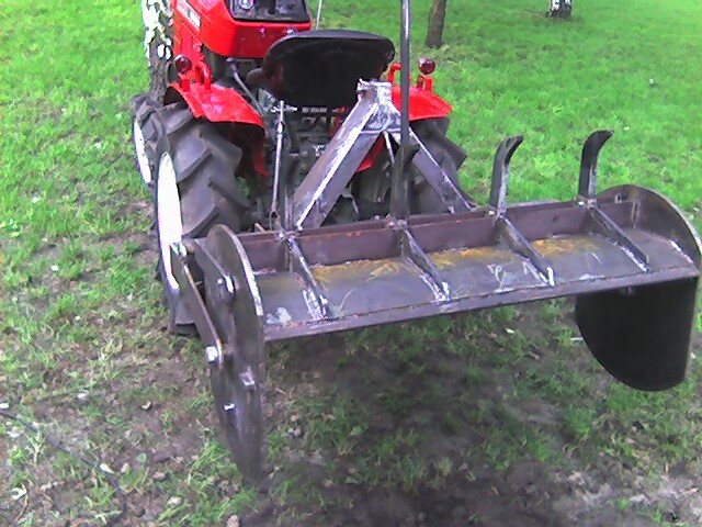

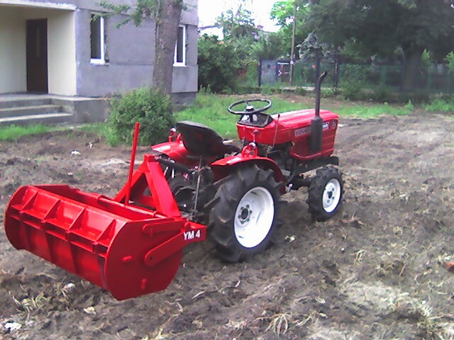

I had a day to work on the imitation Gannon this week so I took the scarifiers to a friend for some hard facing (My tiny little welder does not have the omph necessary), but I finished boxing in the 3 pt mast for strength. I believe that it will hold 50 horses and not just my 15. :D
I sanded it all with a flap disk, sprayed some primer on it and then some Yanmar Red. I even put a model number on it. YM 4R for 4 feet width and R for Rollover. (R is still in the making) Makes sense anyway to me. :rolleyes:
I am very happy with the result of my project and had a lot of fun building it--besides I have already used it to do some of the work for which I made it, as you can see in the pictures.
I hope that you have enjoyed following along and look forward to "seeing you" again in the near future. I need a small trailer to haul all my toys around on.:eek:

/ A rollover scraper with minimum #44
Fantastic job on the rollover. I also followed your dirt scoop. Great job there too. Now I want to see the trailer you are going to build to haul them. ;)
Mike

I am waiting for my welder friend to get a couple of moments to put the hardfacing on my ripper shanks. Then I will put it all together and do something drastic to test it out. I couple of ideas, but we will see. I will take a picture of things all together.
I would like to start on the trailer right away, but I have a couple of other things that are taking priority and some honey-do's.;)
I know that the scarifiers really help when the ground is hard. I could not pull it when the 4 scarifiers were buried in the packed soil.

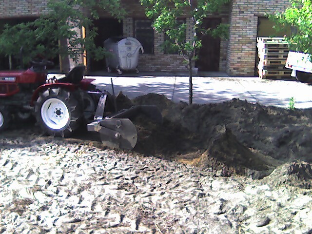

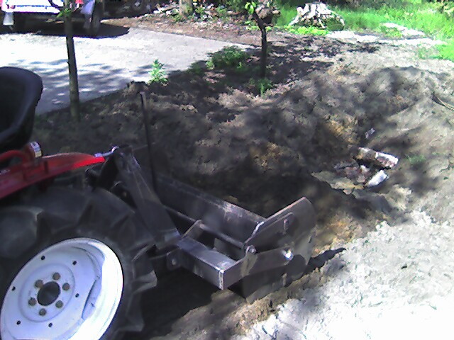

I have enjoyed using the imitation Gannon very much and it works well. I have smoothed the road in front of our church and my driveway, I smoothed the parking area at church and dug a sand pit in the back property. I have used the scarifiers to pull out old curbing and a thin poured sidewalk. I have a couple of things that I would change if I were redoing it today. 1) I found that I would get hung up with the scarifiers because I could not lift the box any higher. If I had put my pivot point a few inches further back I would have gained that much more in clearance. 2)I made the draft arms of the box (the arms that go from the square tube back to the pivot point.) out of 10 mm (3/8 ") material, and I wish that it were thicker, min of 12 mm. 3) I made my pivot point with a piece of pipe inside a piece of pipe with a back up 24mm bolt. I wish that I had used larger pipe for the pivot. I have not broken anything and I have not used it gently. So it is a success from my stand point, although it is really more blade than my traction can pull in our sand. I just run out of traction before I get the blade full or even nearly full. I believe that it could handle a 30 to 50 hp tractor.
I have done some exploratory surgery into the piles in the back, but have not fully leveled things out. I did not find anything too surprising; broken bricks, asbestos tiles, and a few pieces of rusty somethings that went into my metal recycle pile.
Mike
