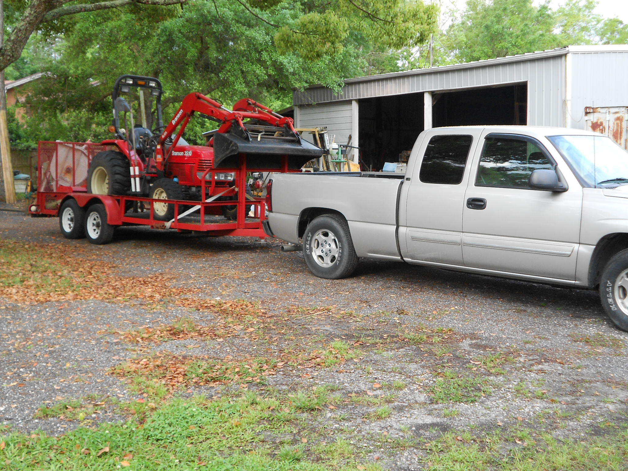

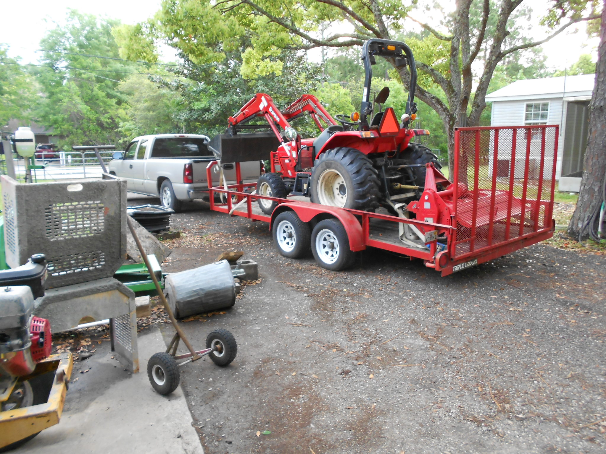

Here is my 16' trailer with my 3510 Branson. This trailer has 4 wheel electric brakes and tows like a dream!
Even if the tractor weighed less I would not think of hauling it on a single axle.
I have over 40 years experience driving semi's (and a bunch with personal trailers) so I know a thing or three about trailer handling and small single axle trailers can get squirrlie when loaded.

Greetings,
How much weight is your tractor/fel/loaded tires/ 3 pt attachment etc. ?
Is that a 7,000 lb gvwr trailer or 10,000 ?

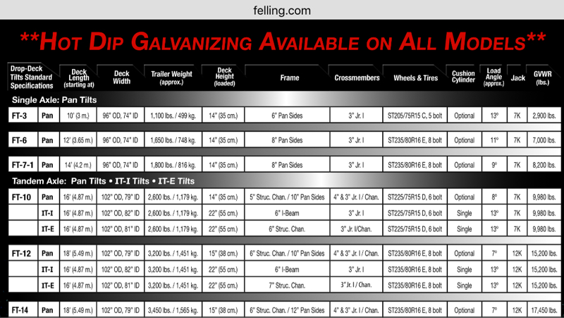

The only HD single axle trailers I've seen are the Felling FT-6 and FT-7. They are tilt deck models and have 6K or 7K axles and a 12 or 14 foot deck. I see contractors using them to haul smaller skid steers and lifts. I will attach photo of spec sheet with weights and dimensions.

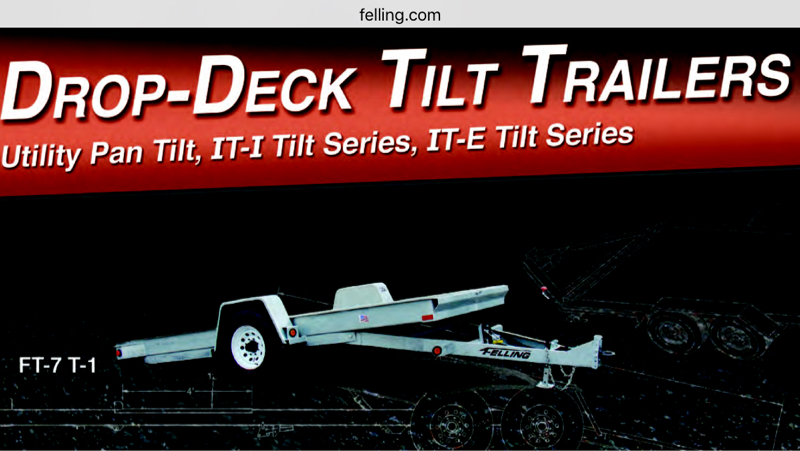

   / A Single Axle Tilt Trailer with 5000 lbs weight rating. #17
Another photo of actual FT-7
The base tractor is 3500lbs (IIRC) add the FEL and Tiller I am around 5000 lbs.
Trailer has 3500 lb axles and weighs 1400 lbs.
