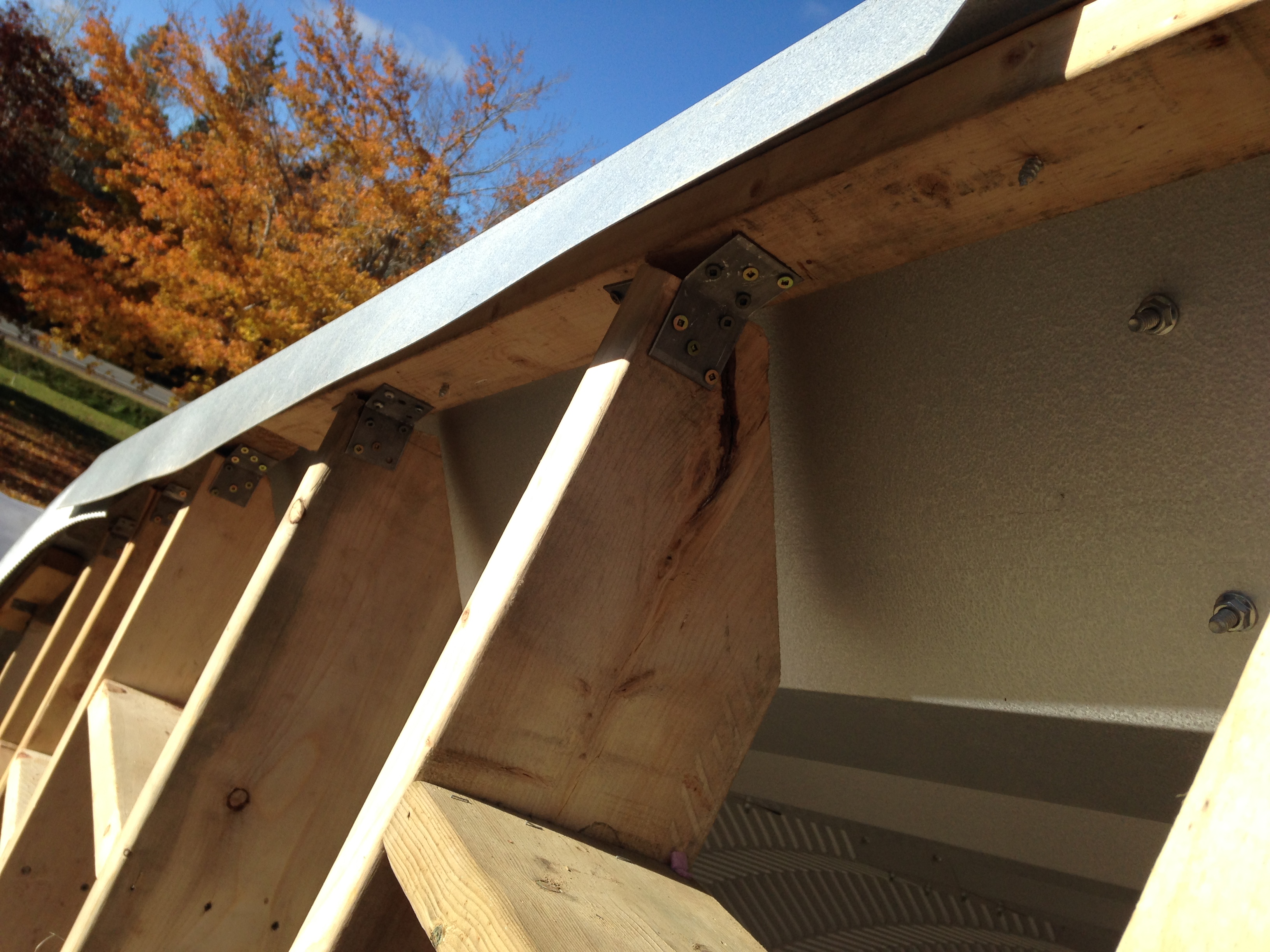

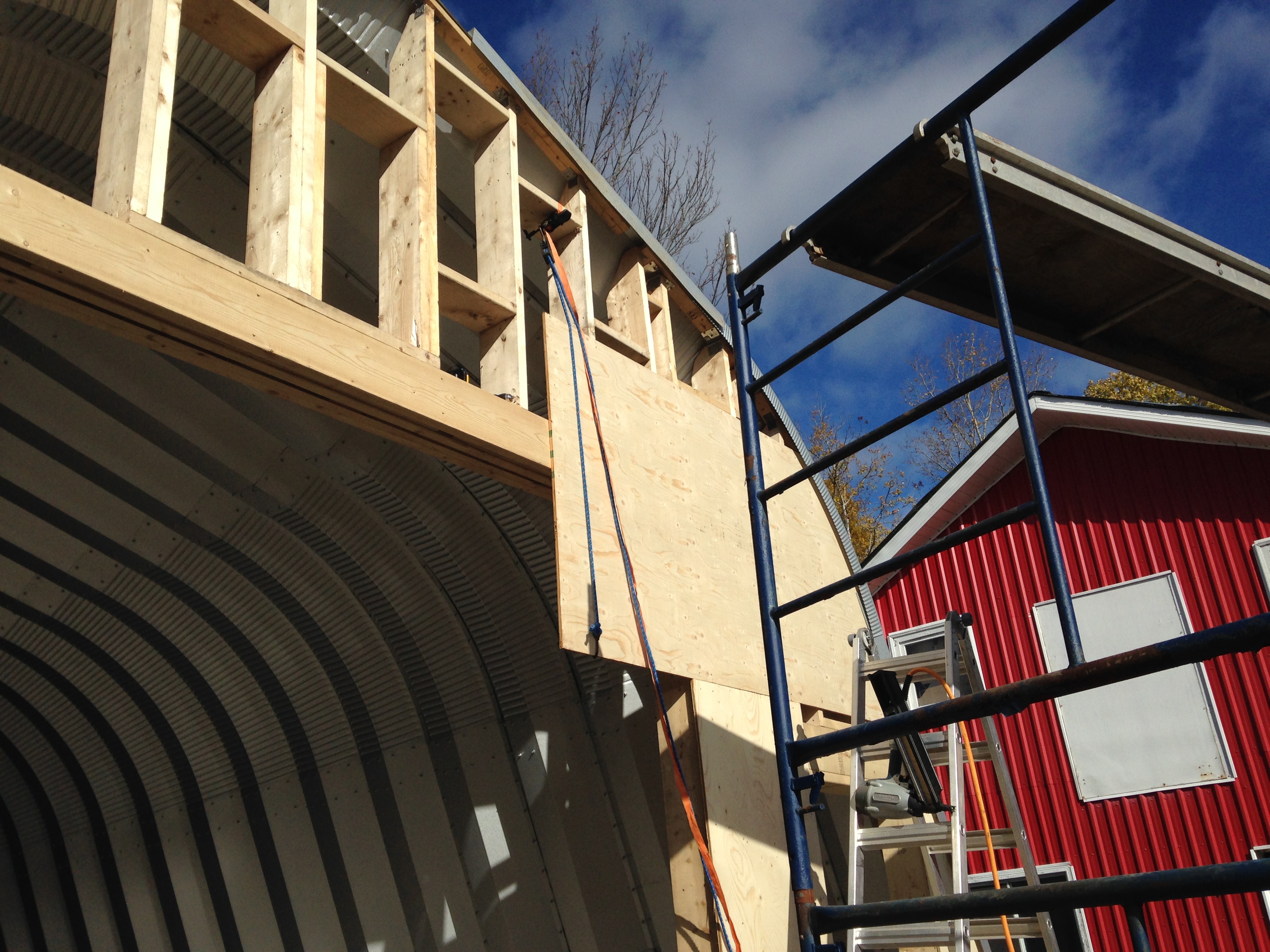

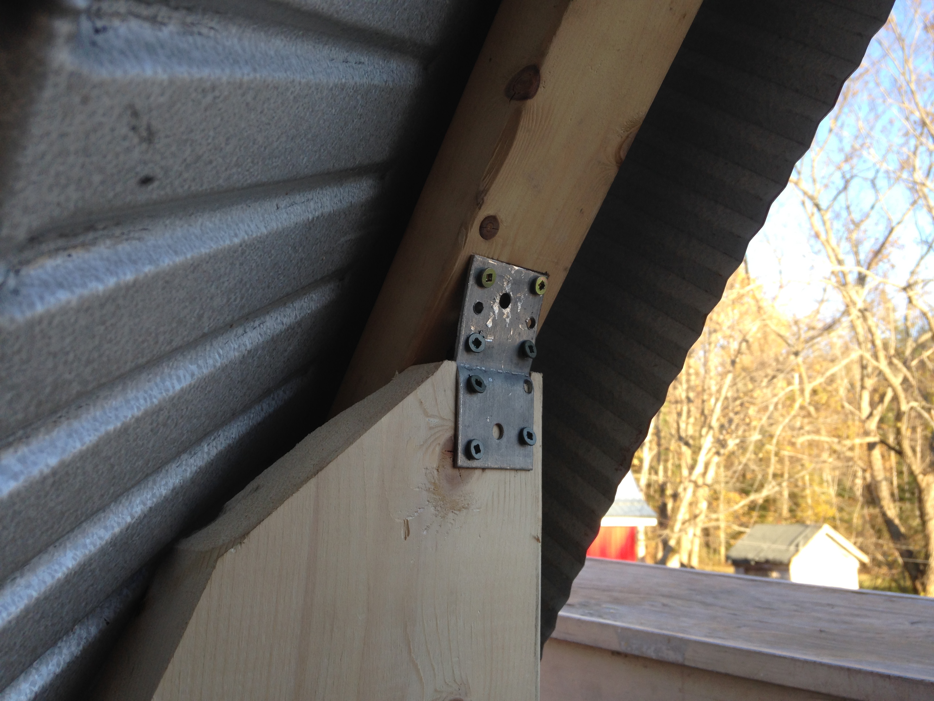

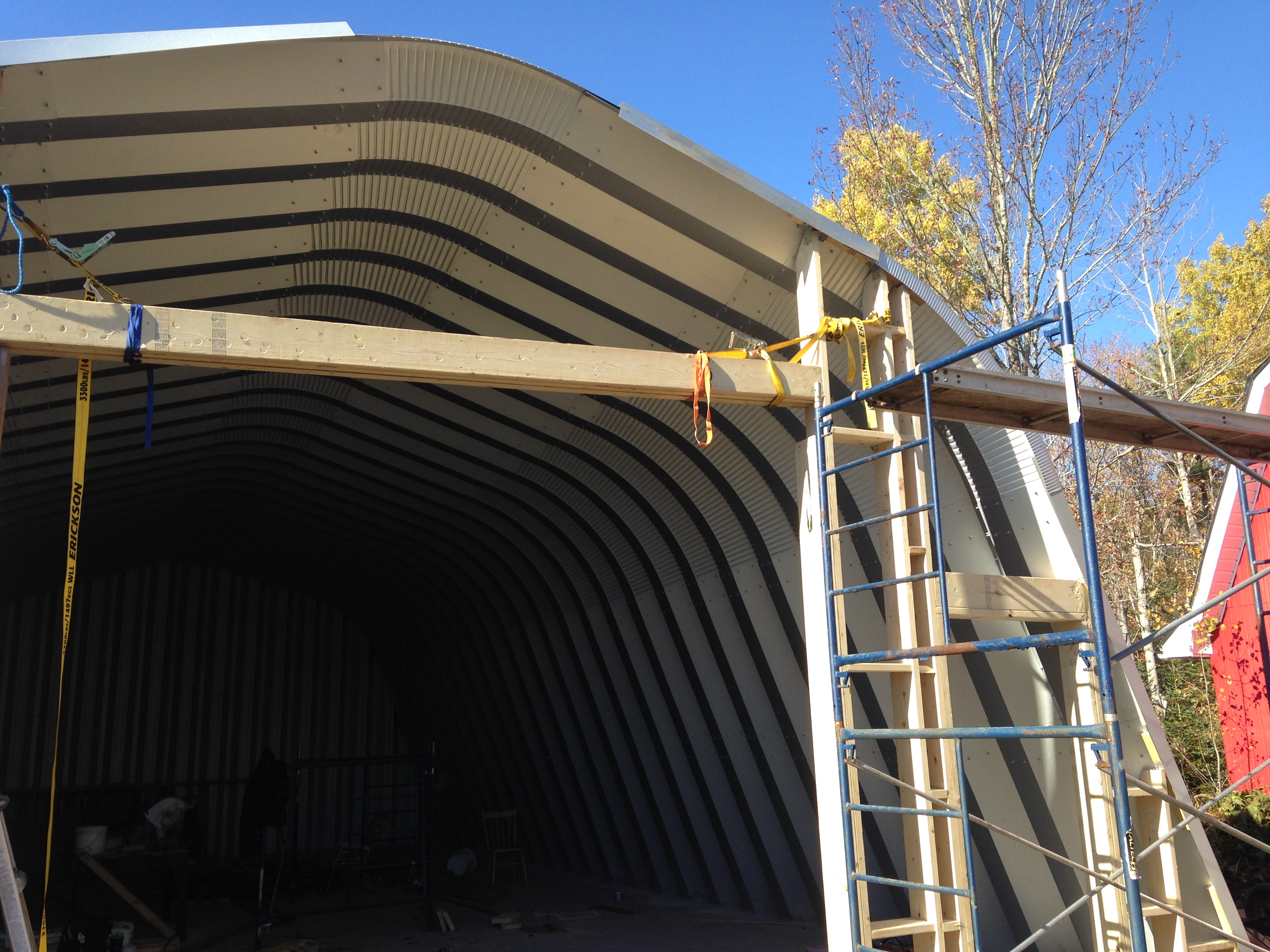

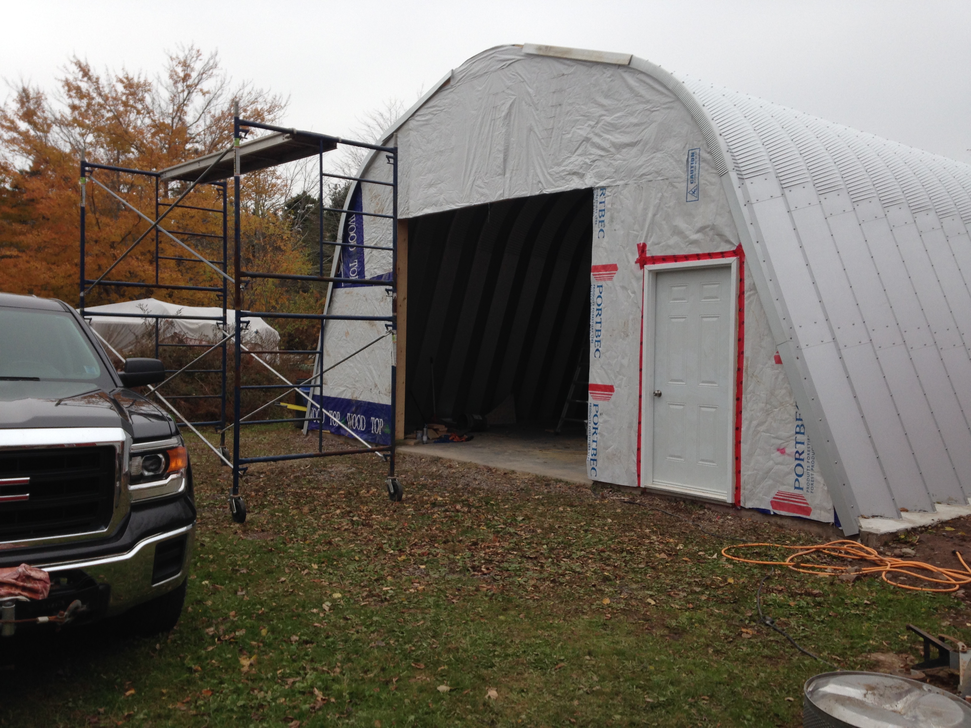

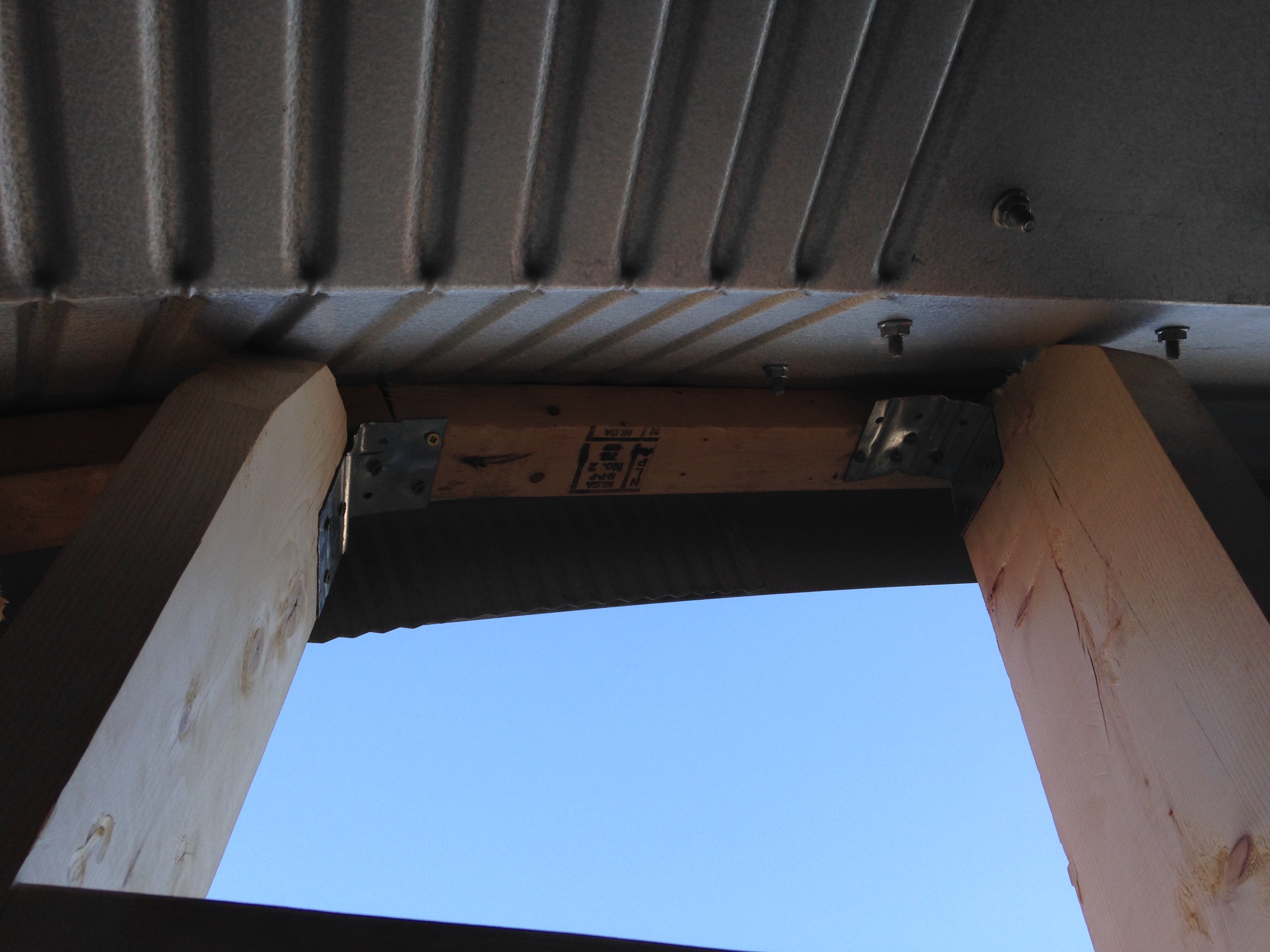

Finally got front wall on and man door in. Waiting on steel and large door. Built 4 ft walls on inside to run electrical. Have leaks on a couple seams and one bolt was leaking. Probably going to be very hard to fix considering the **** building is cemented in place!!Some of the pictures show how I raised the main header and plywood panels by myself. IMG_1280.JPGIMG_1276.JPGIMG_1275.JPGIMG_1269.JPGIMG_1268.JPGIMG_1262.JPG
