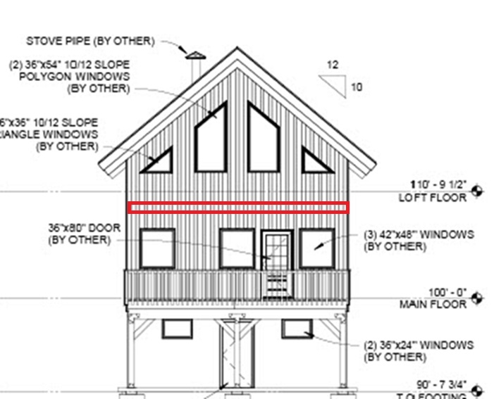

The building in place has made it easier other than the toenailing. I do measure each individual stud and fit it tight. Cut again if too tight etc. A little time consuming but has made me happy. It has also made the building windows in place a little easier. I neglected to take a picture after I had the deck door framed and had started on the last window. I've been looking online as to how to frame in triangle/trapezoid windows. I'll holler at the timber frame folks but was curious.The red box drawn in is me depicting a beam in the wall that the upper section will be framed off of. There's a very strong chance I will hire some folks for a couple days to frame this whole upper part in but I want to pay close attention. I'll make sure they get angles correctly as that is not a common window style. One online suggestion I read was frame it like a box window then fill in around it. Makes sens as your loads are getting transferred in a more proper fashion.

@caver I have lived in a few homes with similar trapezoidal windows. While all of those were framed in with wood trim, I would suggest finding a nearby window manufacturer to make them for you in a double or triple pane. You will get a one piece window that will be more rigid and easier to frame and seal into the house. The wood built in windows are, in my experience prone to leaking, especially if not caulked in place, and a lack of a continuous seal leads to leaks and rot at a really inaccessible point on the house. Plus, once a little moisture gets into the space between the windows, it hangs around and the semi-frosted/fogged window look isn't a great one in my book.
I would a boom lift to put them in. They will be heavy and awkward.

I will order windows from Andersen via a lumber yard. I got a quote sometime back.
   / A timber frame cabin memoir #117
You really shouldn't need headers on the gable wall as it is non load bearing, in almost all cases. Especially with a timber frame. The timbers should be carrying the loads, not the infill framing... Get the specs from Andersen on framing them before you get too far, as they may have some quirks due to the shape.

I agree with this.
For the top angle, just figure out what the framing width needs to be for the windows you are using. Some windows are exactly what they say they are, others are framed that size and actually half an inch smaller. It really depends on what you buy to know what your measurements are.

I have the RO measurements from the lumber yard quote.
As far as the headers, they are required on the lower section per the timber frame folks. The only difference is if there is a beam like in the picture it only gets one top plate. On the back part it will get two top plates those tie beams are not there due to the loft floor. Any opening above 36" actually gets a 2x10 header. Smaller gets just a 2x6 header. I'm awaiting a response from Legacy on the framing but contacting Andersen might also help.
   / A timber frame cabin memoir #120
I put headers in all the door and window openings of my timber frame house. Totally unneeded, but the code enforcement officer had no timber frame experience.
100% of the walls in my timber frame house are non load bearing, the timber frame carries all of the load.
