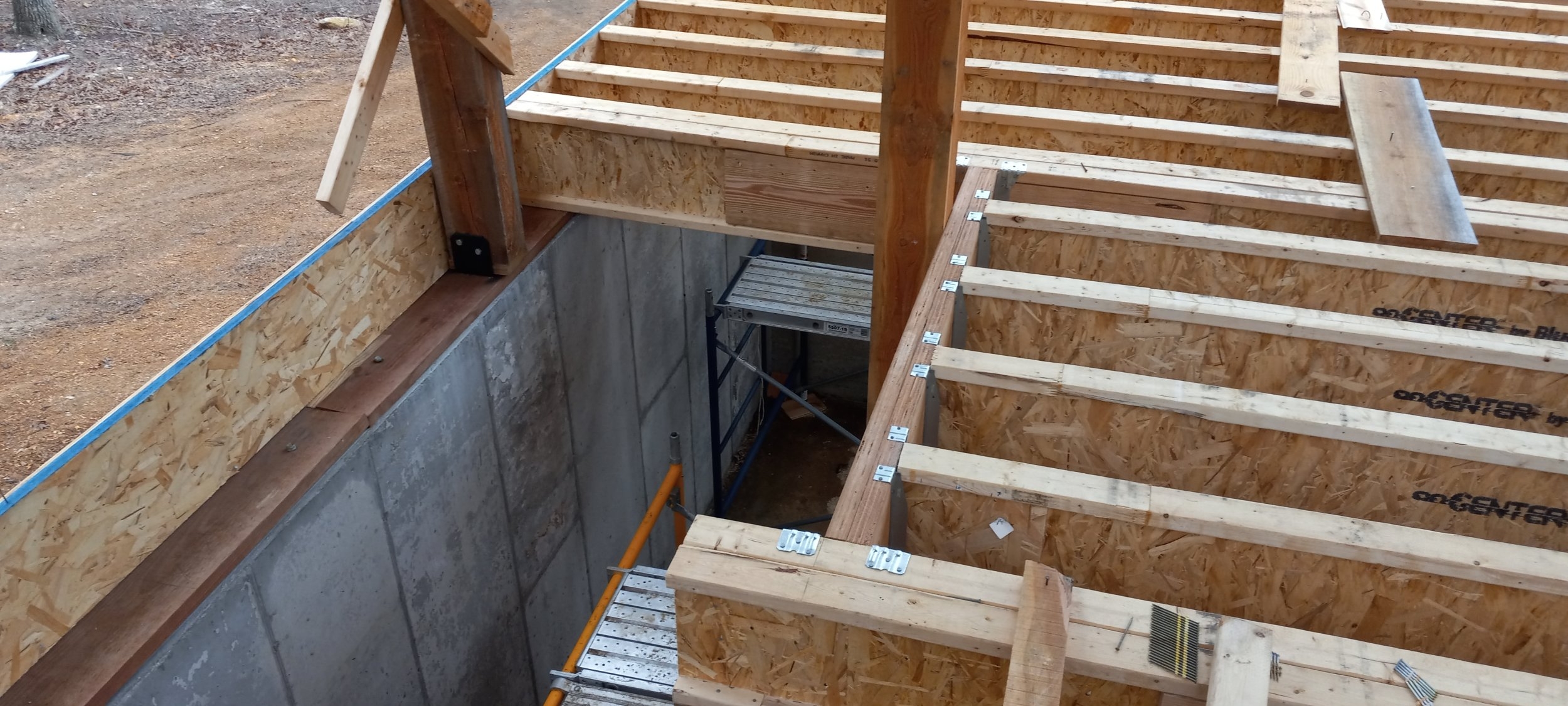

2/3rds of the joists installed. All that's left is the L shaped opening for the stairway will will require a standing post. There's a footing under the slab for it. The drawings state 4x4 but I will use a 6x8 beam that was replaced from the factory. the reason being is they anticipated 2-2.5" flanges and mine are 3.5" so when I double them up it's 7" AND an LVL comes in at the side. The last 22' joist was cut short at the plant by 3" so the lumber yard sent me a replacement they had in the yard someone else had ordered and not used. The kid shows up yesterday and it's 12" joist. The owner forgot mine were 14" I-joists. My big irritation is this roofer that seems to have flaked out on me. Our last conversation made no sense unless the guy was hit in the head with a 2x4 and has amnesia. A week later (last night) I texted to say any update?.....crickets. I may end up going with a shingle roof if I can't find another standing seam metal roofer. It's been with synthetic underlayment since mid November and storm season will be here before you know it. I will call the lumber yard owner early next week to see what kind of suggestions he has. he's been pretty helpful so far.

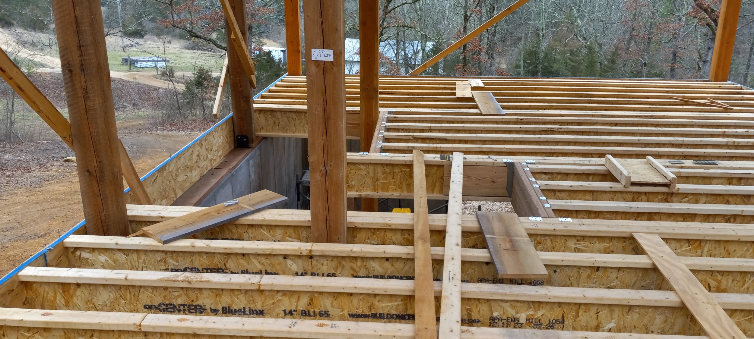

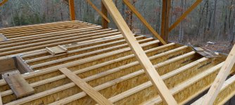

Other than one little spot I have to put in a header and some short joists, I'm done with the joists.
The last picture there will be an LVL on the left side of that post to the end of the doubled I-joist.
Questions: Is Advantech subfloor really that good? I see regular T&G plywood 23/32 for a cheaper price. I even looked at some of the cheaper OSB subfloor stuff but reviews all over the place. Before I lay this stuff down I need to insulate the north and south cavity between the rim joist and last I-joist. I left just enough gap to get my hand up in the there as I knew I would likely run wire up in one to two spots. I was even looking at a froth-pack but that stuff is pricey. I loose my rental in about three weeks so trying to take short breaks back in my current home. After that it is staying in my camper on site if I want to work there. I do plan to stop building and spend some weeks on getting my house on the market.

Advantech is better then anything else.
How far apart are your floor joists? 3/4 inch tongue and groove plywood was been the standard on joists 24 inches on center for decades. Glue it and screw it down and you should be fine. If your joists are closer then 24 inches, I wouldn't hesitate to use 3/4 T&G Plywood.
I think PL construction glue is better then Liquid Nails.

16" centers (or less). Since they didn't provide the floor, the plans were limited other than showing a few details for the stairway layout opening. They just specify 3/4" T&G. They also assumed a joist with 2-1/2 flanges. Mine are 3-1/2" flanges. The floor drawing had one joist landing right at one of the bent posts. With the juggling around of wider flanges my frame maker suggested sticking with the dimensions on the stairway opening. Well it worked out I could land one joist right next to the post yet still keep my 16OC or less. The downside was regardless of how I lay the plywood down some sheets will have to be cut a few inches short to land on center.

One of the biggest advantages of Advantech is the moisture resistance. It can get rained on quite a bit, especially compared to the cheap stuff and not swell. Remember to gap the edges per the mfg spec! In a DIY situation, time is not your friend as things take forever compared to a pro crew and exposure to the weather is basically a given. Use the good stuff.
