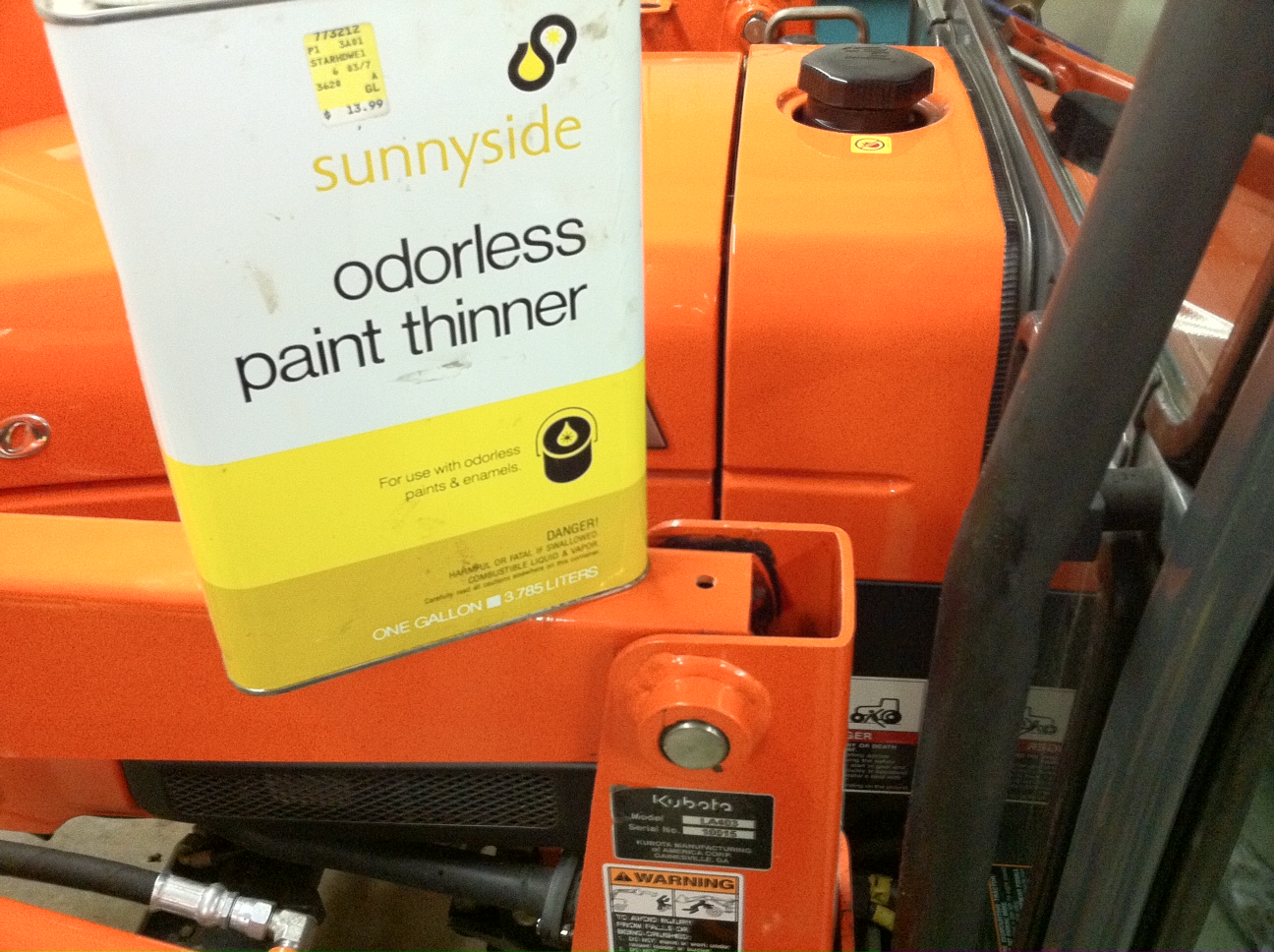

Maybe you guys already use this, but for the last couple of years I have been using Odorless paint thinner to clean the extra grease from the FEL joints. You know when you check your oil or air filter and get grease all over your shirt or jacket because we don't always have time to clean up the joints. I use Pennzoil RED synthetic grease and it is as sticky as it gets. The Odorless paint thinner removes it like wiping dust from a table.
The stuff works great just pour some on a rag and wipe the grease away. No smell either it's like pouring water on a rag. I have tried it all, diesel fuel, kerosine, brake clean.
This stuff MELTS the grease away without any odor or mess and won't damage the paint in anyway. I had some time today between storms for some maintenance. Yes it has been awhile since I cleaned and waxed my Kubota she still cleans up well. This is the only brand I have used so test what you buy first. Normally I would wipe that grease out of the inside too, but I didn't want you guys to think I was excessive :confused2: I cleaned that up after the picture.:thumbsup: Trust me it just wipes away instantly and leaves a clean dry surface behind.
