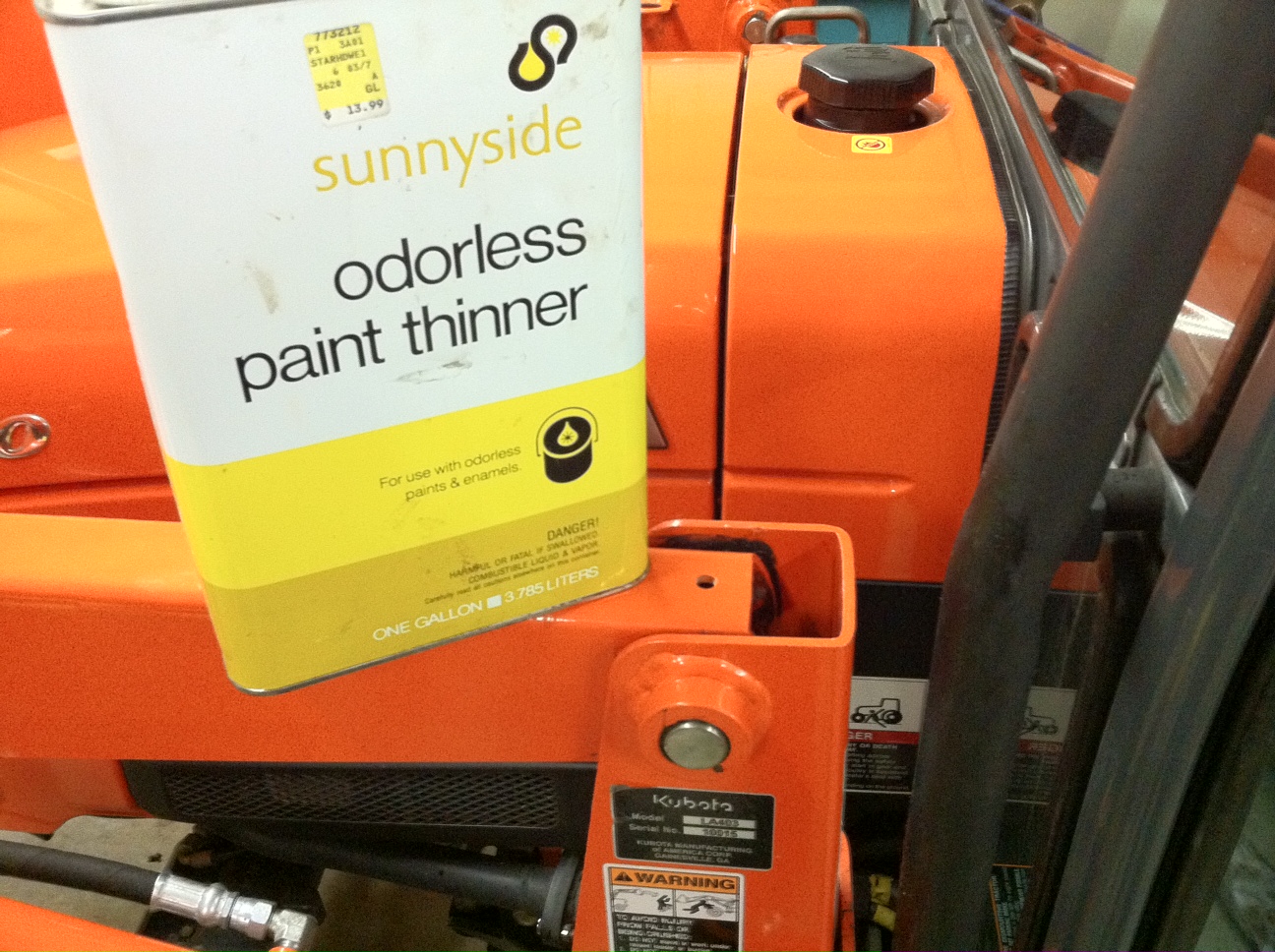

I rip up old flannel sheets into rag sized pieces and use a few of those to wipe up excess smears after greasing the dear tractor, I think I'll draw the line there...
Ok you have the flannel sheets your wiping the grease, just try putting a little Odorless paint thinner on the rag first then draw the line there. You'll see in an instant how well it works over clean dry rags.
My post was not about waxing, it is about cleaning the excess fel grease with ease. Nothing works better. I tried them all. Gunk is Overkill, makes a huge mess won't touch globs of grease and stains the paint. Green cleaner won't melt the grease without smearing it all over first, too much work.
This melts that grease right into the rag like a magnet, turn the rag wipe it dry thats it. No mess, nothing all over the ground. Just spot cleaning the grease ending up on the rag. Then with the same rag wipe all the other grease areas too.
Ready for wax but you don't have to wax it, your just cleaning the excess grease off. it's almost impossible to wipe the red grease I use with a dry rag without leaving grease residue behind that the dust will stick to. You end up smearing it all around. This product melts/ de-solves the grease away into the rag in one swipe like a magnet.
This is very mild with no odor and works very very well.
Then you can use any brand of wax you want if you want to wax. I just finished a 60 hr job greasing every ten hours and not worrying about the grease build up while working. My fel and tractor looked like a mess. You wash the tractor but you can't run the sponge over the grease on the fel it just makes a mess gets on the sponge, smears, etc. You all know what i mean if you wash your tractor with a sponge. Try this......you'll thank me for it.
Just a note I have not tried any other brand paint thinner for this. This brand has been used by me for four years without any adverse affects.:thumbsup: I do not recommend any other paint thinners that I have not tried.
Guys look at that fel joint in the picture, Does yours look like that after six greasing in a row with just a few swipes of the paint thinner rag when done with the job?
