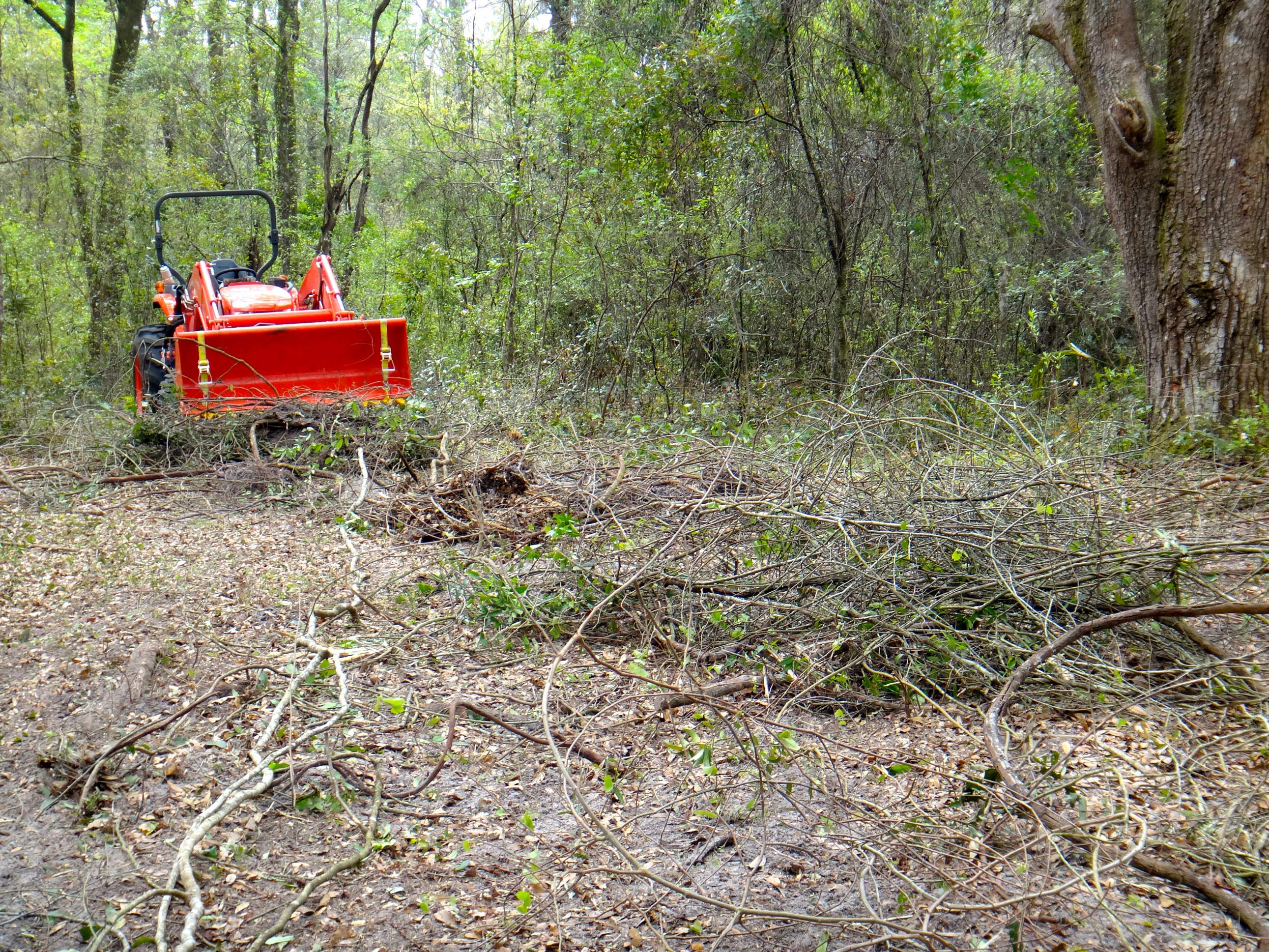

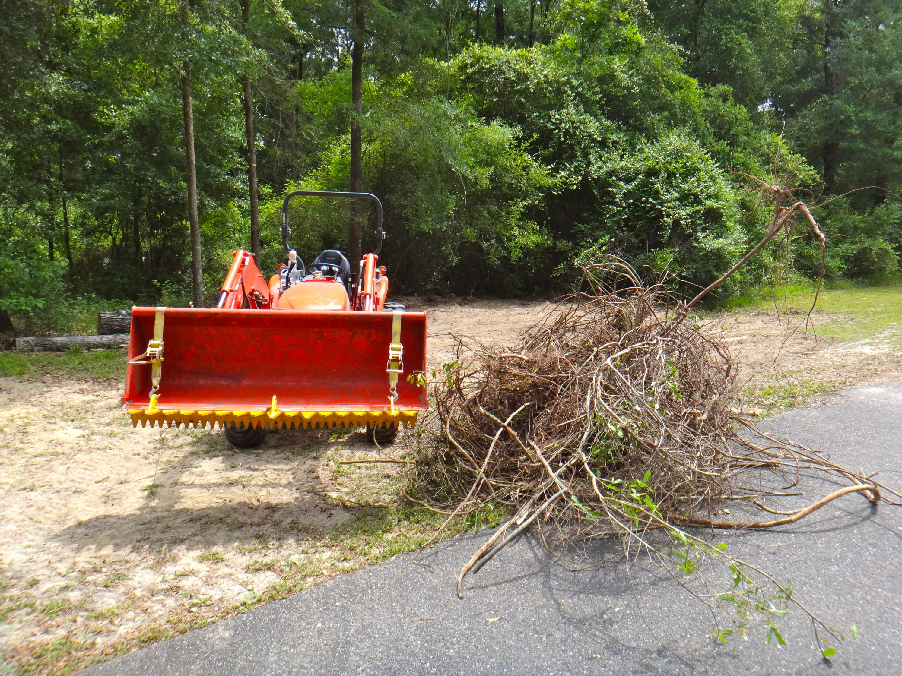

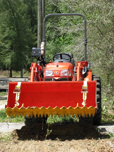

Backhoes are undeniably cool. But I would spend money on a grapple and basic to your needs implements such as a Land Plane Grading Scraper, a Rotary Cutter/Bush Hog and a Ratchet Rake bucket attachment, first. (snow removal equipment?) You really have not demonstrated a "case" for a $7,000 Backhoe. BUT it is YOUR hard earned money. Spend and enjoy.

PHOTOS: Ratchet Rake

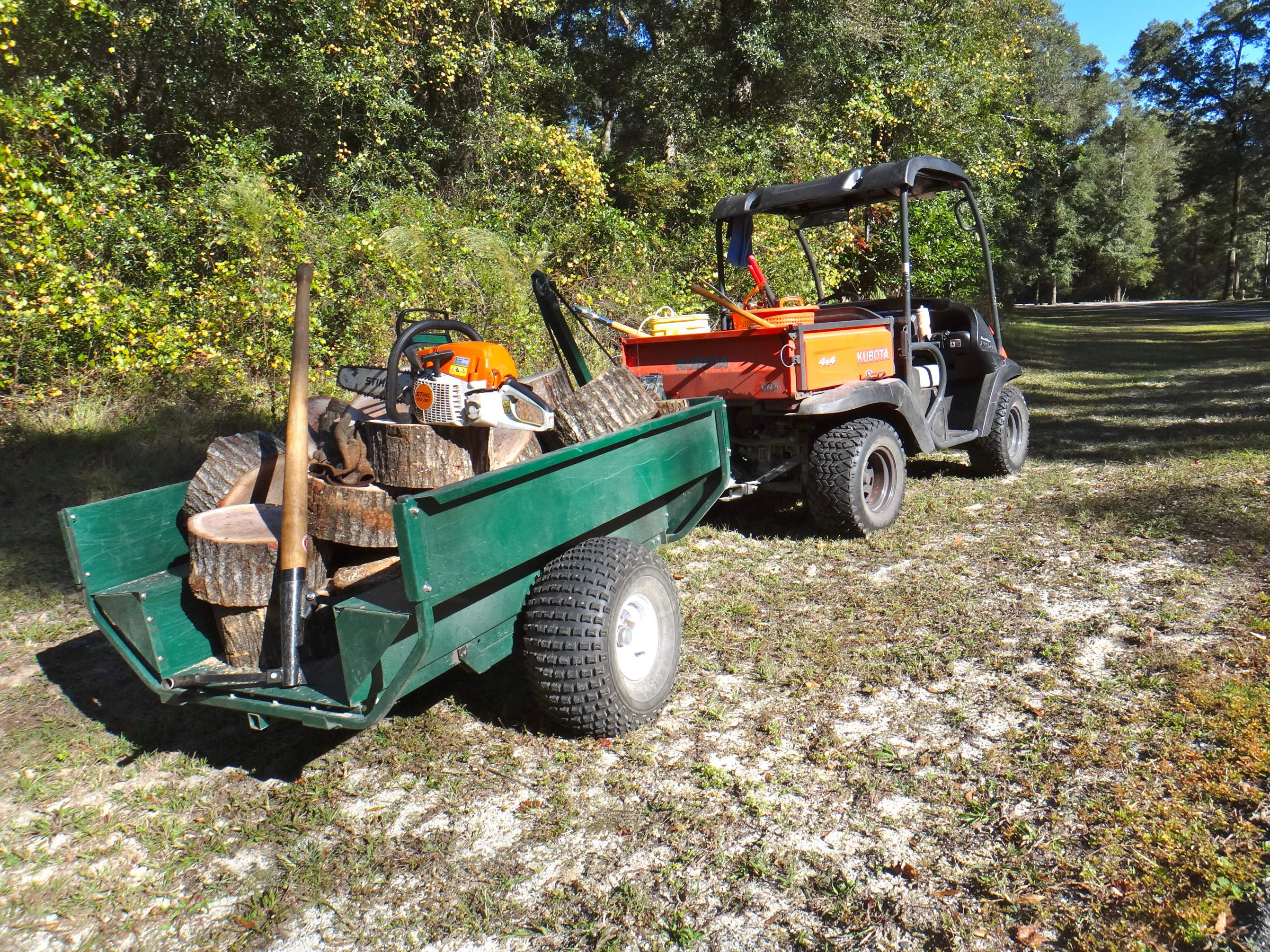

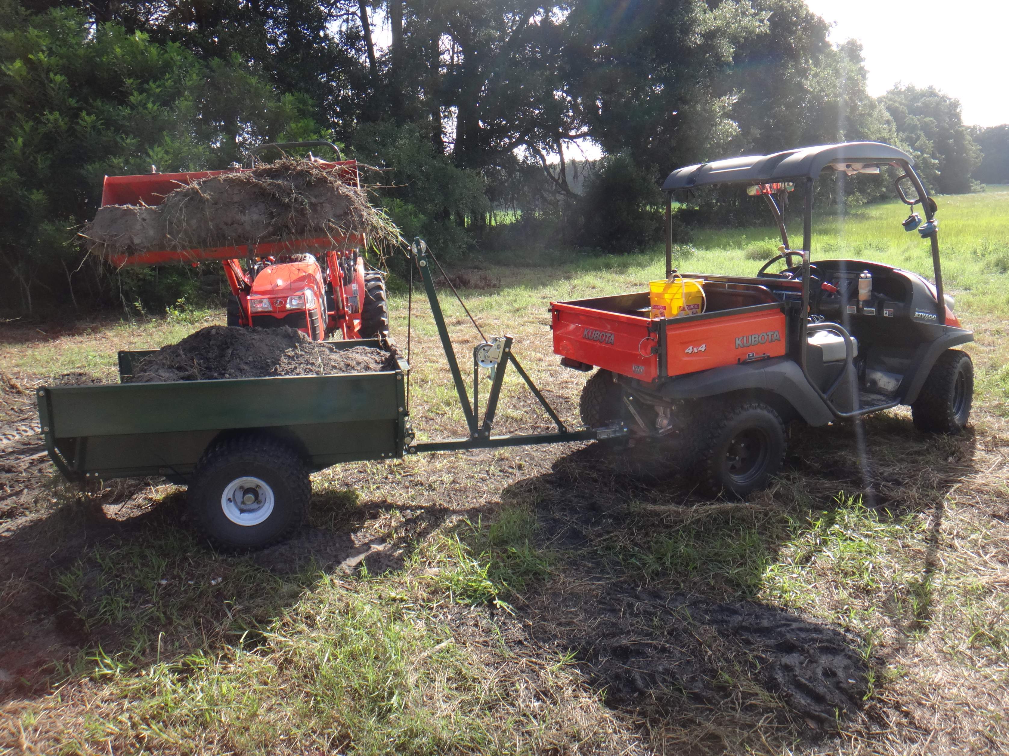

Consider an off-road trailer designed to self-load logs, such as a Canadian produced MUTS. A light tractor or my 16-horsepower Kubota RTV500/HST can handle same, loaded. My trailer is an older, single axle model, now discontinued.
MUTS is the gold standard of all-terrain trailers. When you call MUTS, Larry Edwards, the owner/designer answers the telephone. Excellent service. MUTS now has a U.S.A. warehouse.

Photo #5 Tractor Three-Point-Hitch adaptor for pulling trailers and attaching chains used to elevate and skid logs.

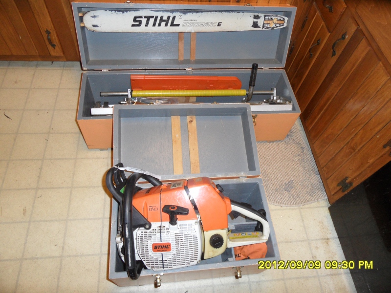

Alaskan mills are nice. I've got two. I bought one for regular price then I bought the second for $450, but the guy threw in an almost new 120CC Stihl w/ bar, chain, and boxes. :)
