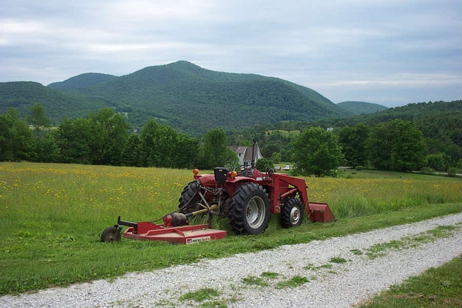

I have a 60" deck on my brush hog and am happy how that works behind by 3430.
I don't have the check chains yet and am thinking it would help how the deck goes over the small hills and valleys on my property. My point is learn about the extra bit and parts to make the brush hog shine!
Then again, looking at that photo, it could have been taken on my property. Two horses (inexpensive pasture pets) keep that better looking that I can with the tractor!!!
