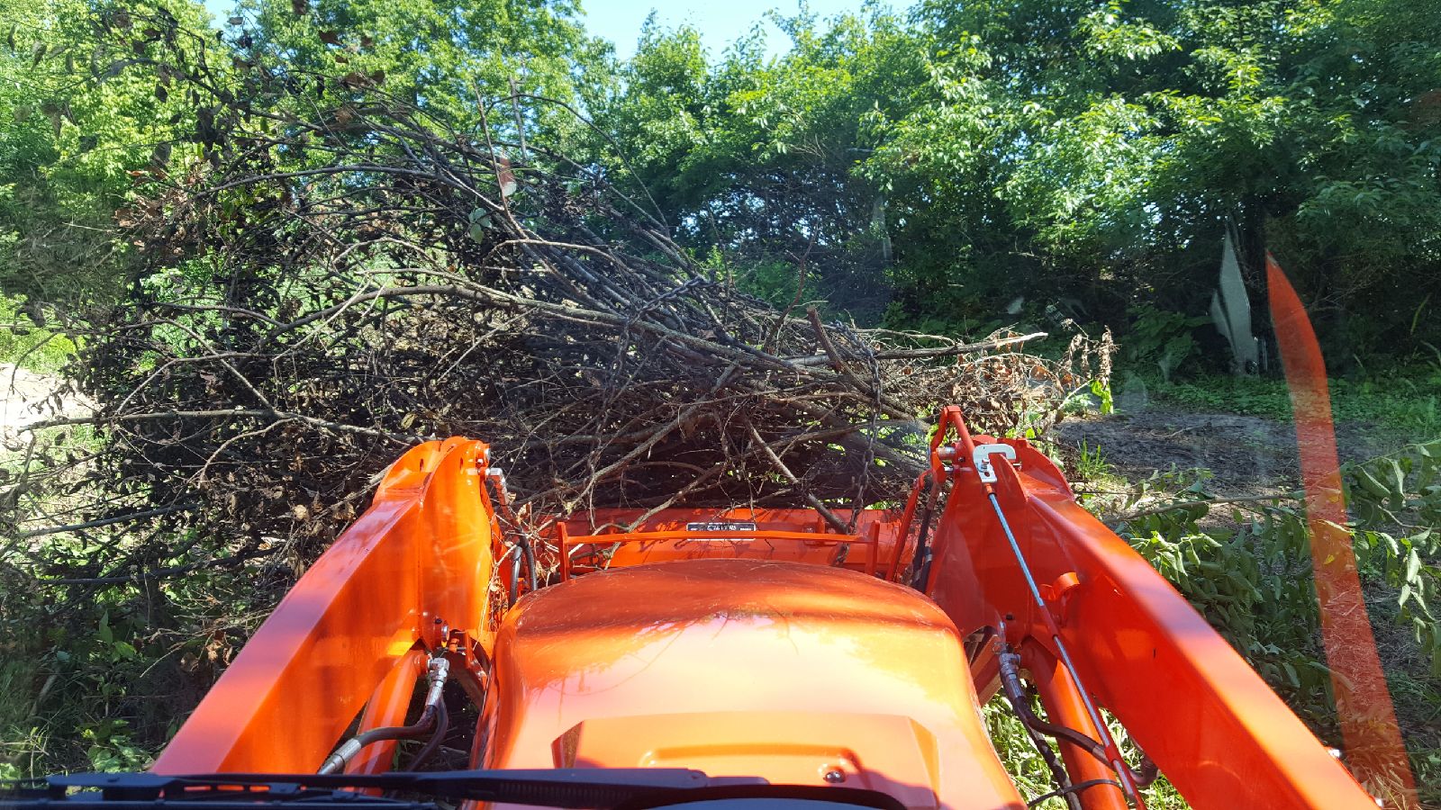

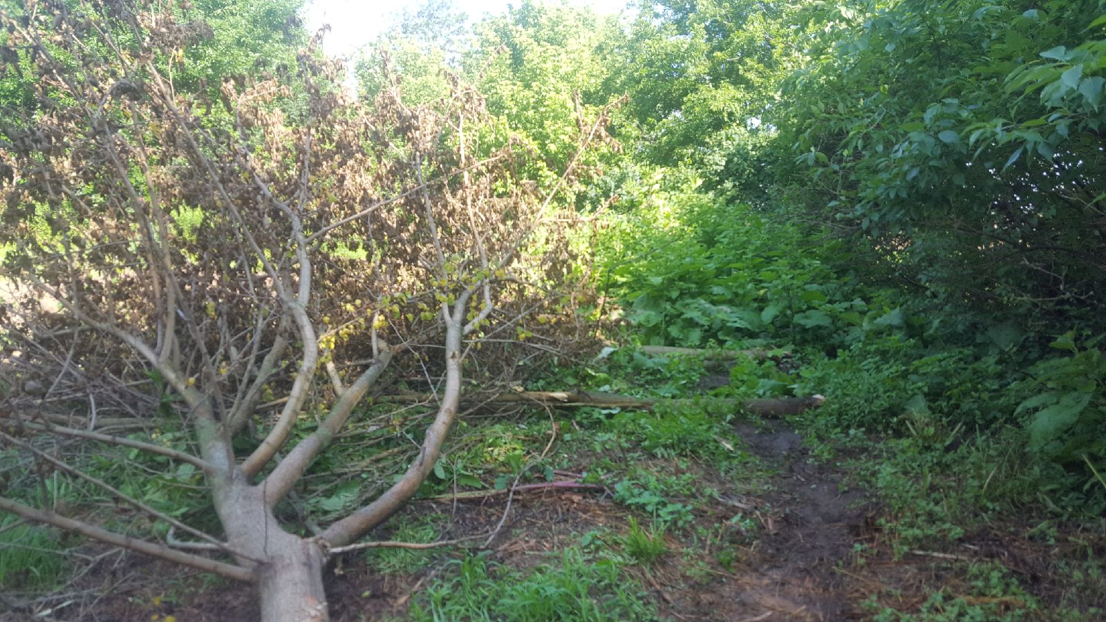

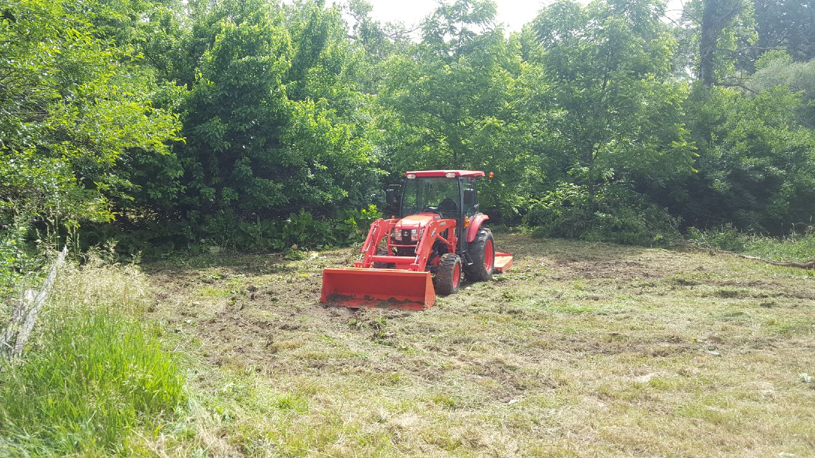

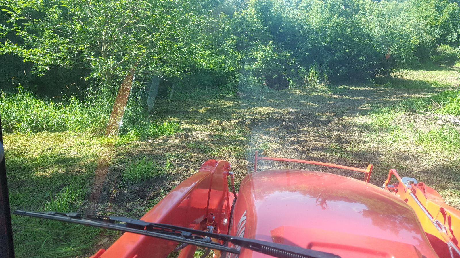

I have property similar to yours. About 45 acres, 3 acres around house the rest trees. For the past 2 months I have been making trails but I have tall trees. I rented a skid steer to see if that would work but got it stuck (10,000 lbs). I have been using a small L3301 Kubota with HST. The small tractor has been great, allowing me to move between trees and minimize my need to use a chainsaw.
/ A "which one to buy" thread #9
I've not had an issue with mine when it has coming to clearing. Although many wouldn't want a cab in the woods, I prefer the cab to take the beating than me. (You don't have to get the Grand series with a cab.)
