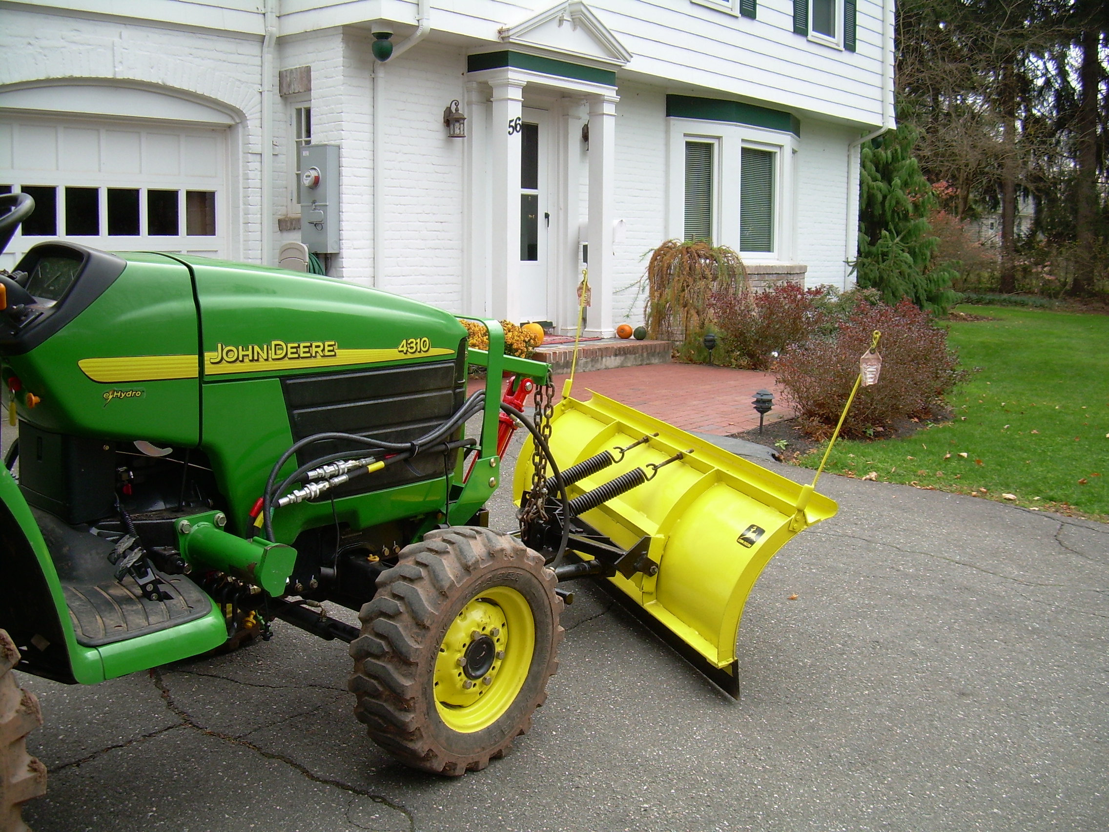

I have (Actually my 13 year old kid has) a set of different colored electrical tape rolls. comes in handy for hose ID especially when I take the loader off and put my 4-way snow plow on, using the loaders QD's
JB
