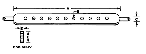

Is there any way to hook up a drawbar with the Pat's units installed - or do you have to take them off?
Are you wanting to use this type of drawbar? (See attached)
If so, no nothing special to do to use it. However it will pivot so you may need to fabricate something to combat that.

That's it. Thanks, Inspector!
Andy
PS And Rick, too!!
