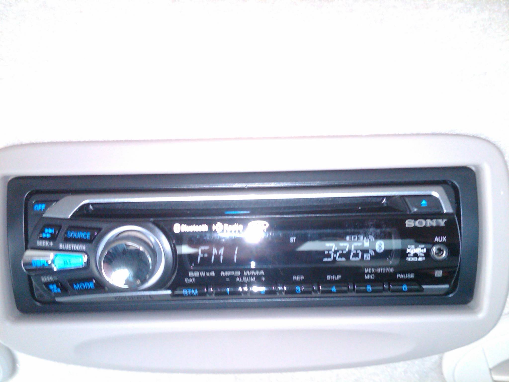

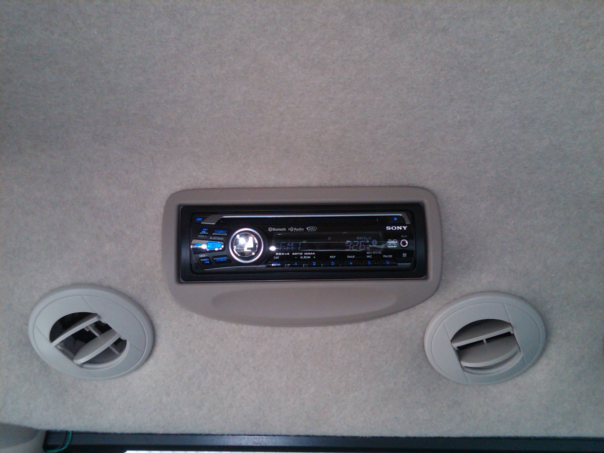

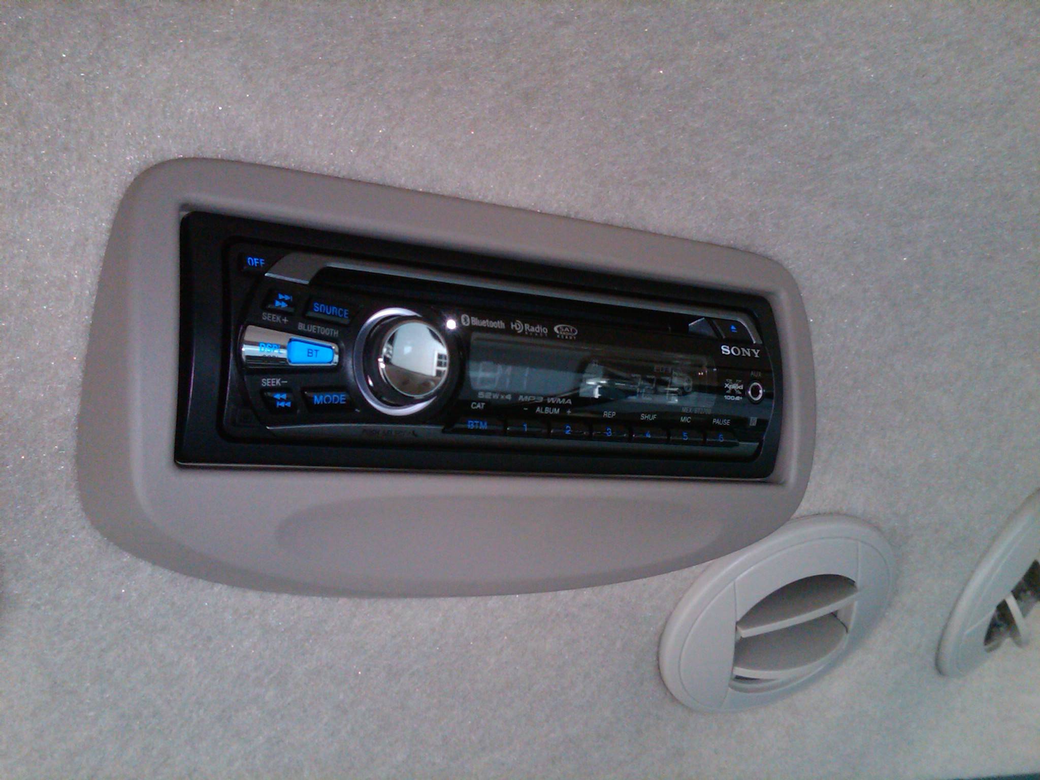

Is the radio you are installing a single DIN unit? If so, you will have no problem with the installation. There is no special adapter kit needed. If it is a Dual DIN, I believe there will be problems (not enough room). The adapter plug you mentioned is the correct one. I have attached some pics of my recent radio install. Sorry, but the pics are after the installation was complete, not as I was installing.

It looks like it is the same size as yours so I guess it is a single din. How do you like your blue tooth? Have you used it yet? Thanks for the pics and the info. :D
