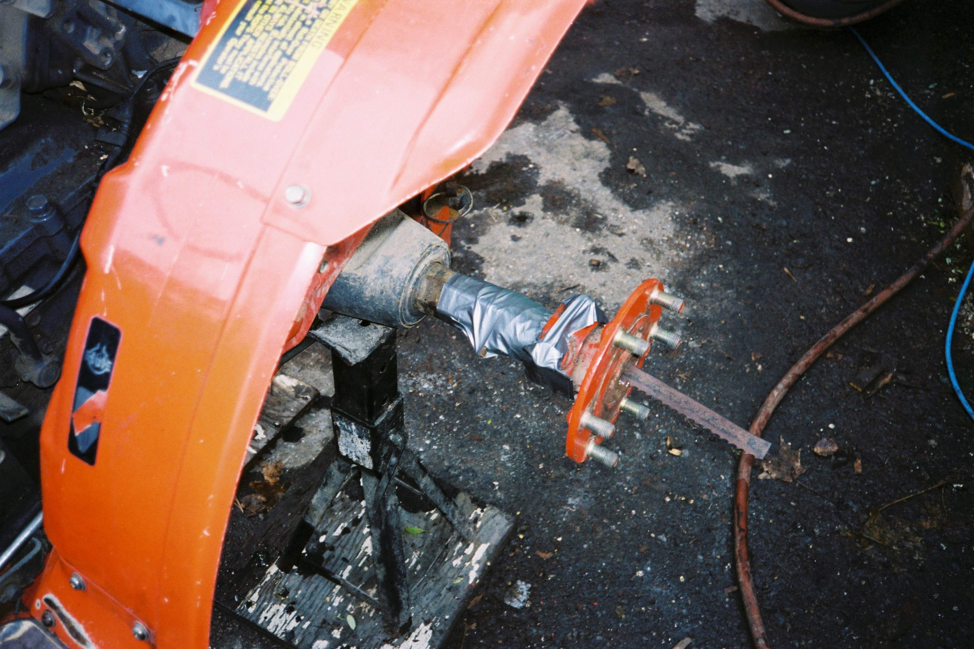

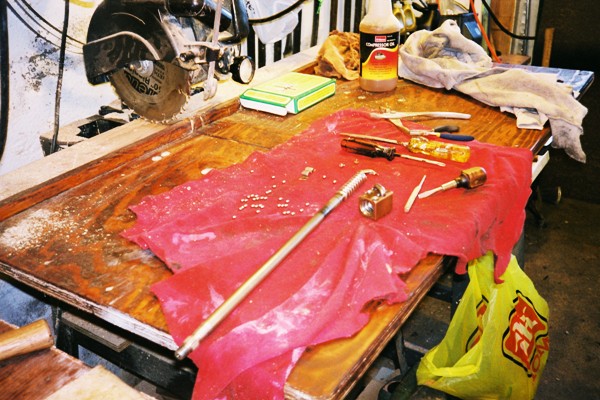

Yep, I got the slide on rims. They have some slop and I can't get them any tighter. What it cost you to replace them, and what did you go with?
I went to the Kubota dealer in town and asked them about it (the looseness).. They said Kubota had some replacement specificly for this model to correct this problem.. I think it was around 200 dollars for the set.. But WOW, it is like night and day..
   / About to buy a 1978 B7100 #23
There is a new style hub which actually works. :thumbsup:
Pic. of old style attached.
And a picture of worn out parts from inside the steering box.

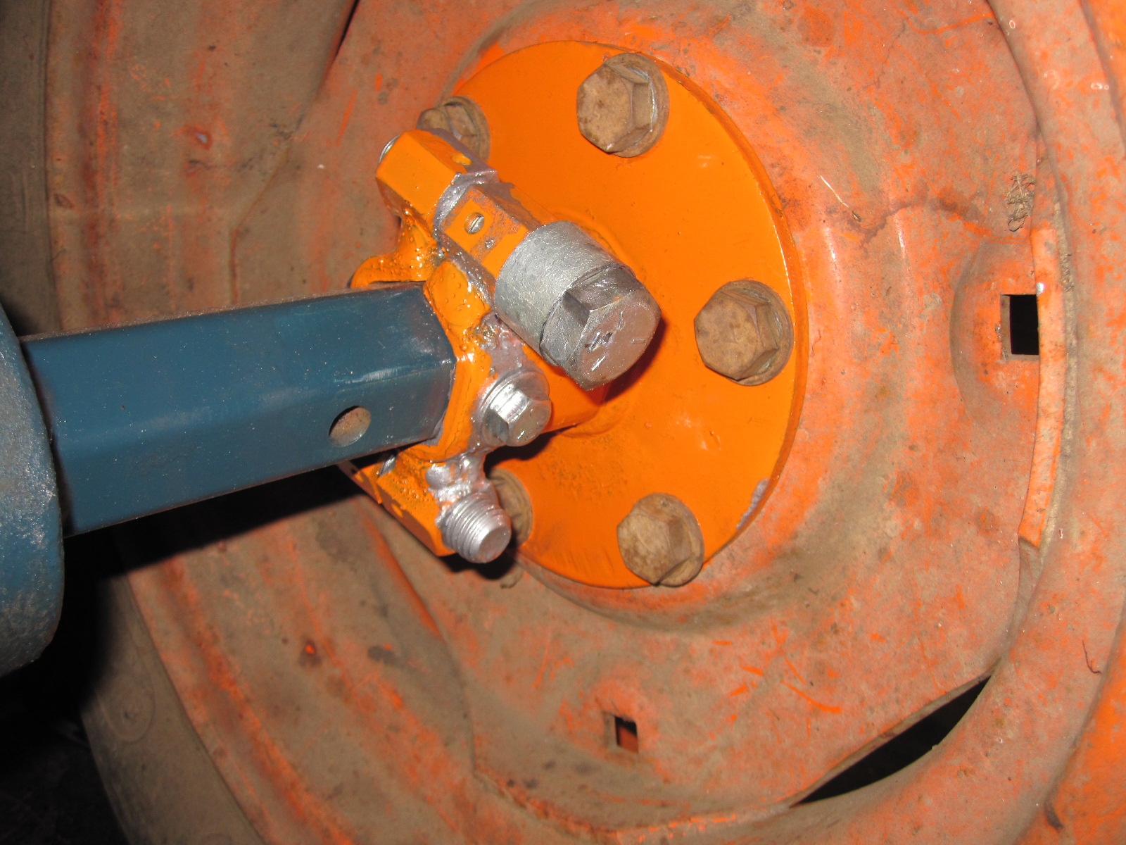

Repaired/modified the old hubs on my 1980 B7100. Been going 2 years now & still tight.
