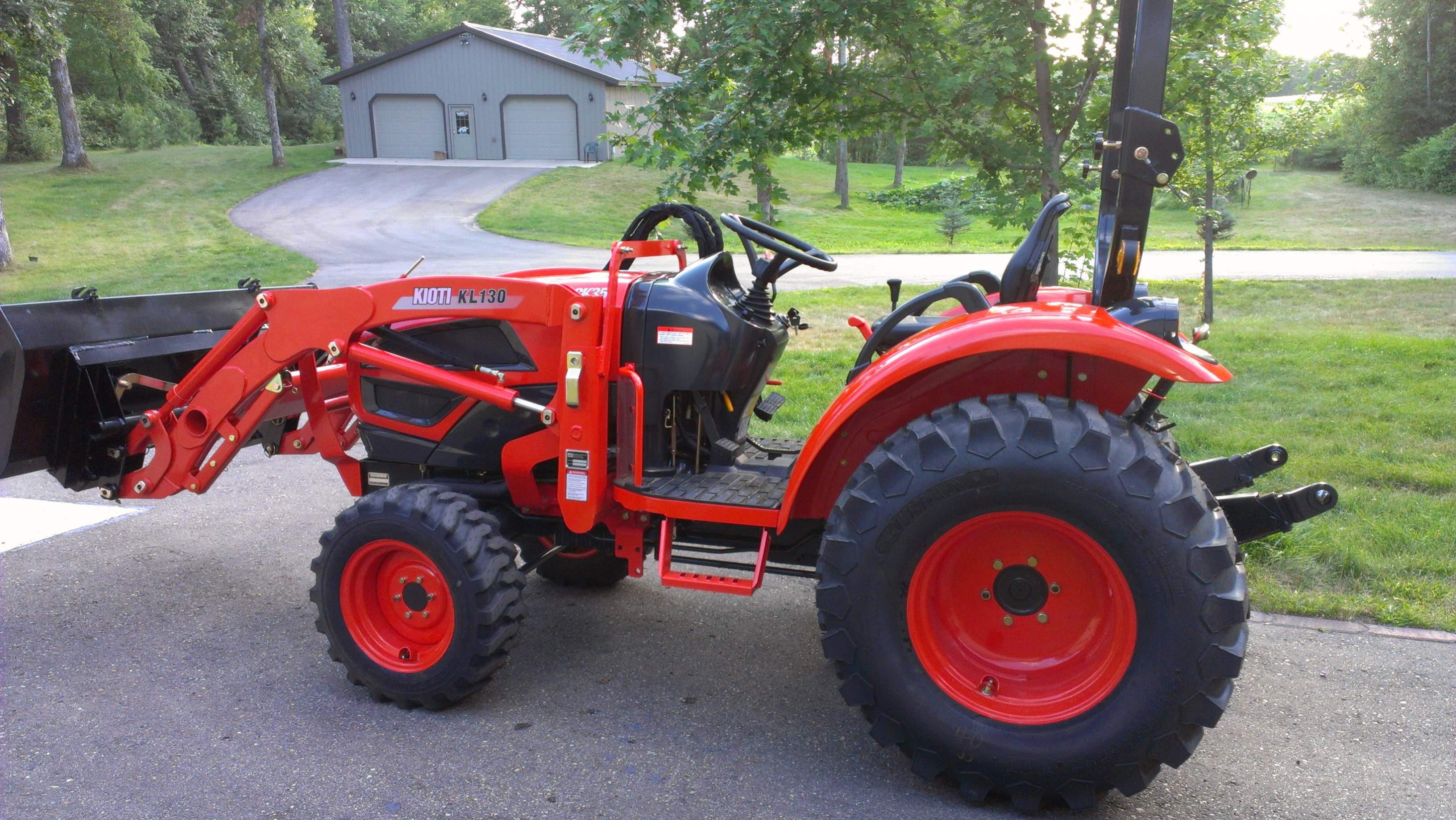

Well, after a lot of debate and some delays due to my dealer being at the Sturgis rally, I finally had my CK35 HST with Loader delivered. I came in just over $17,500 with everything outlined earlier along with three cans of touch-up paint, a tube of grease, some extra filters in addition to the 50 hour kit and a full tank of diesel. I feel that I got a more than fair deal.
Thanks to all that helped with this decision and checked my sanity. This is a great forum and I hope to be able to return some advice once I build up some knowledge. Here are some pics for your viewing pleasure!
Warming up before doing some light work

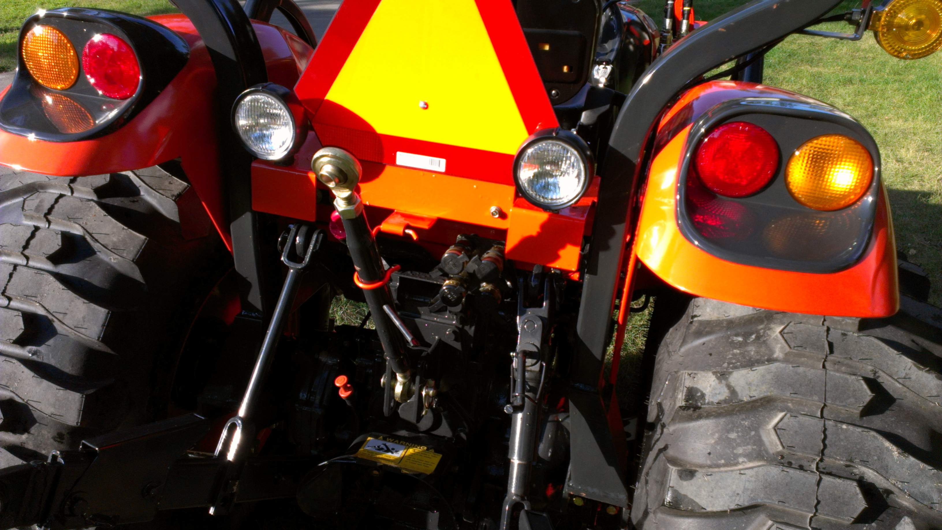

Rear remotes and work lights

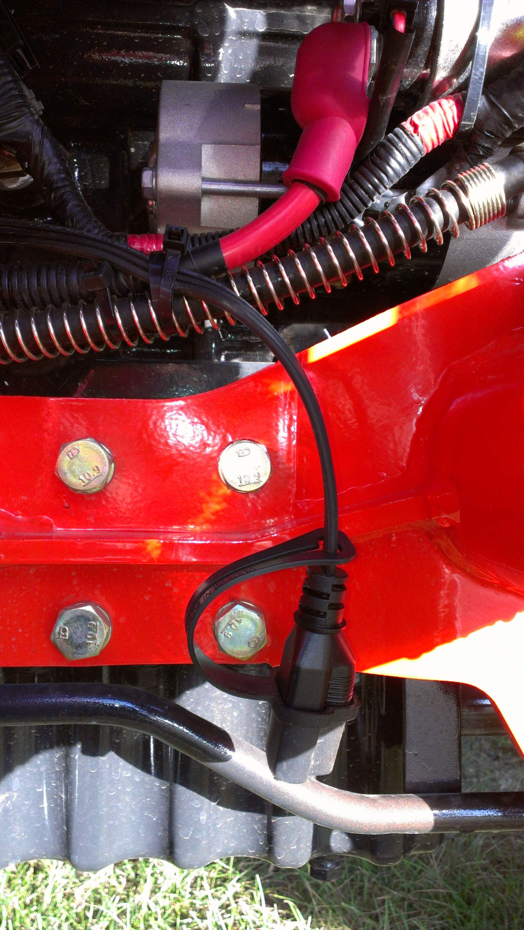

Block heater

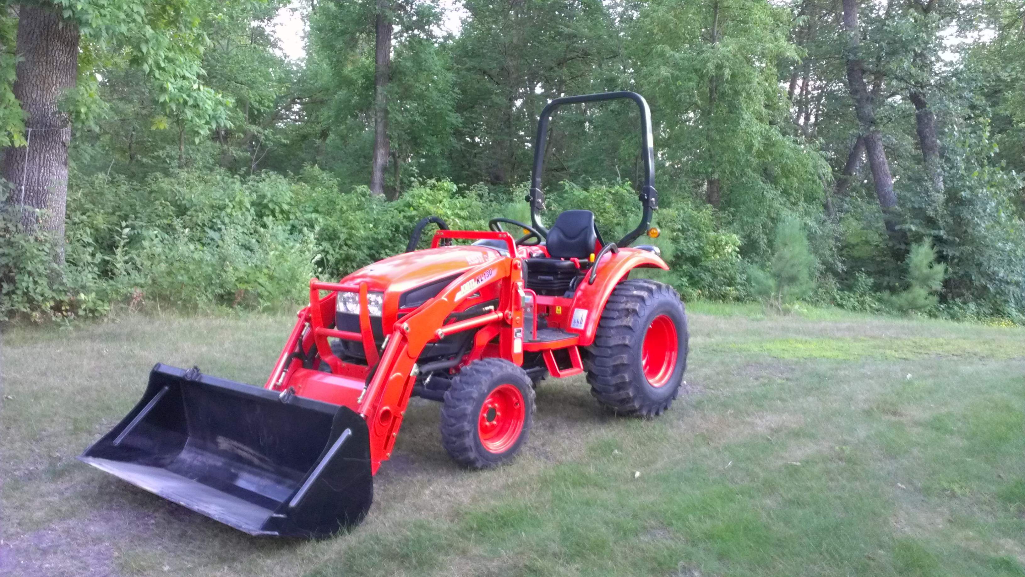

After moving some gravel, pushing a couple down trees out of a trail and overall just trying it out
