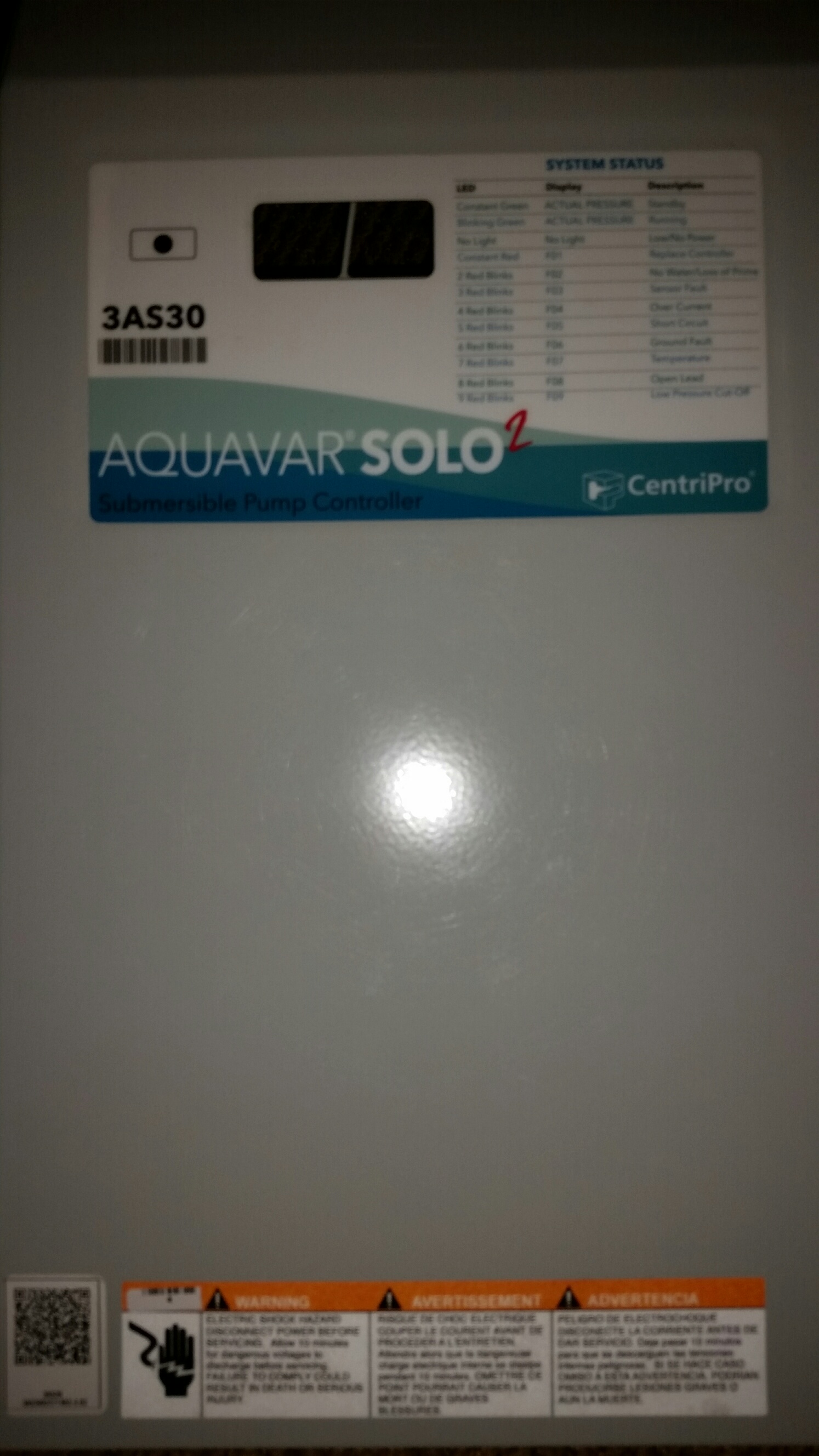

I have the Gould's 3 HP pump and I went with the VFD.
Since the pump is a 3-phase Variable Speed, no CSV setup was needed.

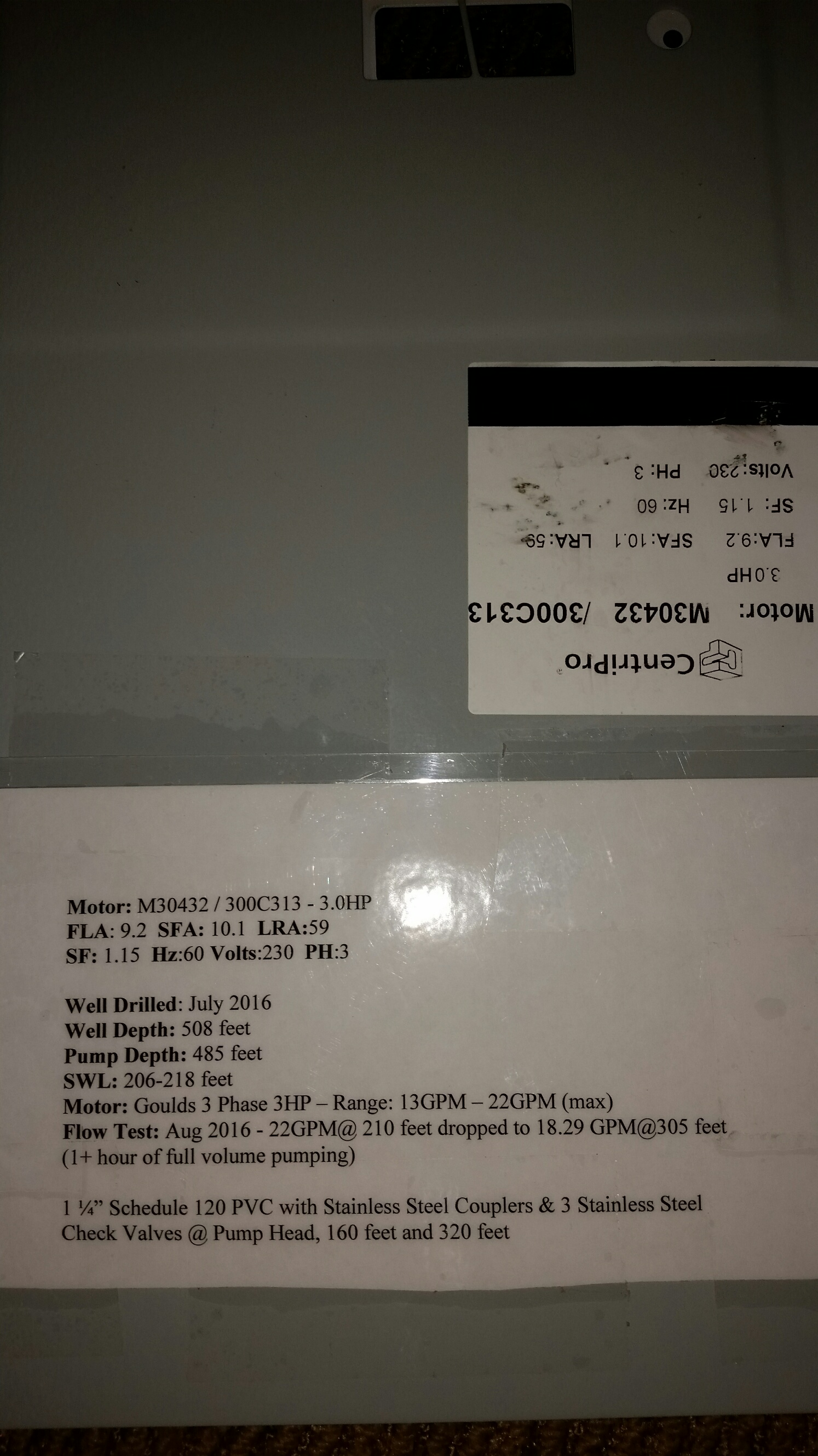

I'm glad to say I am NOT the 3/4 of people who don't write down the specs of the well near or on the control box. I am the 1/4 that does: (See below)

I have the Gould's 3 HP pump and I went with the VFD. I did it as a homeowner so I wanted to do it right. R&R is always more than doing it right the first time.
I am not rich and I don't write checks for $10,000 without knowing everything that is being installed and how and why. In the end, it's me, the homeowner who has to deal with a failed well or poorly designed system.

Here is my prediction, as I have heard this hundreds of times before. In the first 5 years while under warranty you will wake up to no water 2 or 3 times. You will be told that everything electronic has bugs and they just have to de-bug the system, and you will be back in water. They may have to replace the VFD controller, the pressure transducer, or even the motor, but it won稚 cost you (except for being out of water) because it is under warranty.
After the 5 year warranty is up, you will be out of water again. This time they will say there is really nothing they can do but replace the VFD controller and/or the motor and pump. You will also be told that the new VFD controller they are going to sell you is an upgrade, as they have solved the problems inherent in the old VFD controller. Of course the VFD controller you have now is an upgrade of the last VFD controller that had issues. Every couple of years they come out with a new version of the VFD that is supposed to fix all the problems of the last VFD. I have heard this about 12-15 times since 1990, when I was big into VFD痴.
By the time you have to purchase the next VFD controller, you will be way beyond the glossy sales brochures and have much better understanding of pump systems.
You would think the pump installer would not want to lose your business. But he will make more money selling you the original VFD system than he would have made in 30 years on a conventional pump system. So he really won稚 mind if you find a different contractor to work with, as he will be rid of a mad customer.
