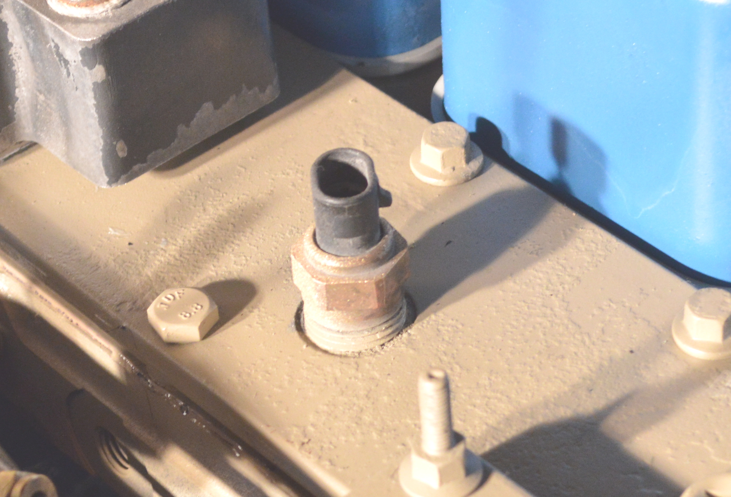

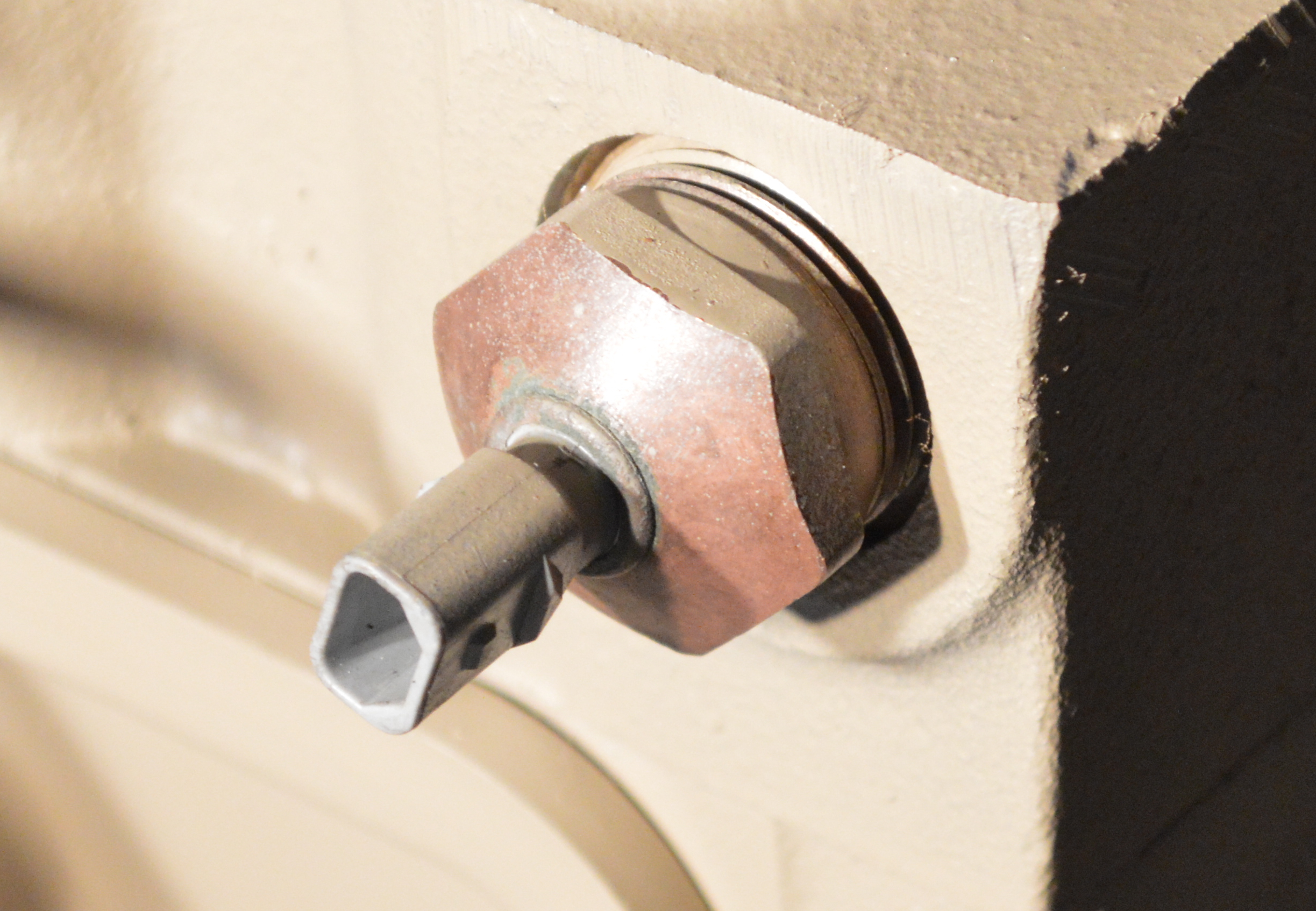

I'm going to swap my intercooler turbo duct for a non-intercooler one if i find someone with the reciprocal idea. I can buy the rpm sensor from Cummins, the one you screw into the flywheel housing almost touching the flywheel, i don't know what gauge i would need for that. There is a water temp sensor in the head of the engine, again I'd need to get a gauge for it. EGT I have never used on a car, saw a set for a small airplane and bought it for my late brother for his piper super-cub. It cost a fortune, I haven't seen an EGT port on this exhaust manifold. There's an oil pressure sensor in the block that I can tap a direct-reading or electrical gauge into. I would LIKE to find an oil gauge that shorts a circuit to ground (for a flashing red light) at a _settable_ pressure. Finally maybe a boost gauge if needed, which I doubt.

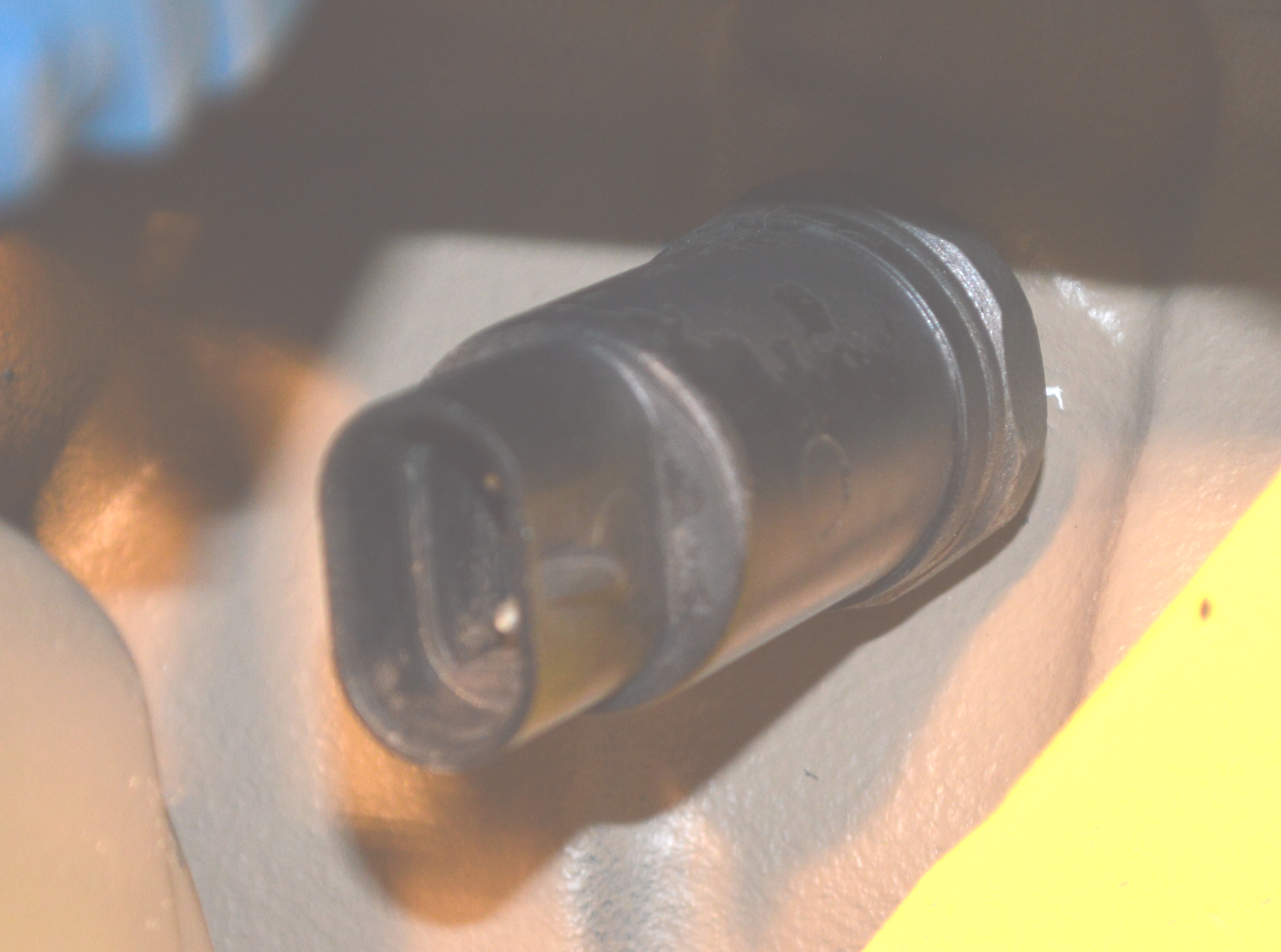

I did, thanks, that's the ballpark price. I just bought a couple of injectors from RockAuto, they also carry a long list of gauges. To begin with I'll try to make us of the existing sensors and just buy indicators for them; I need to know if any are just switches etc. The host truck was probably a '94/'95 diesel Ram. I can steal the tach sensor and gauge from the other engine.
Oil-Pr transmitter (below injection pump, 2-pin)?
Water-Temp sensor (left rear head corner, single-pin)?
Boost-Pr (top of intake chamber, 2-pin)?
