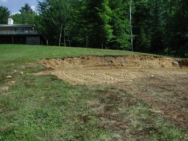

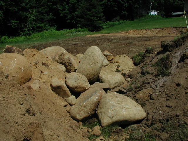

Well I have been digging and moving stones for a week now. Still have a long way to go but it is starting to shape up.David

/ Above ground pool project #23
David,
Those stones..........is that what you have to dig through to get power to the pool???? If it is, I hope you have a backhoe/w3tcompact/icons/grin.gif
