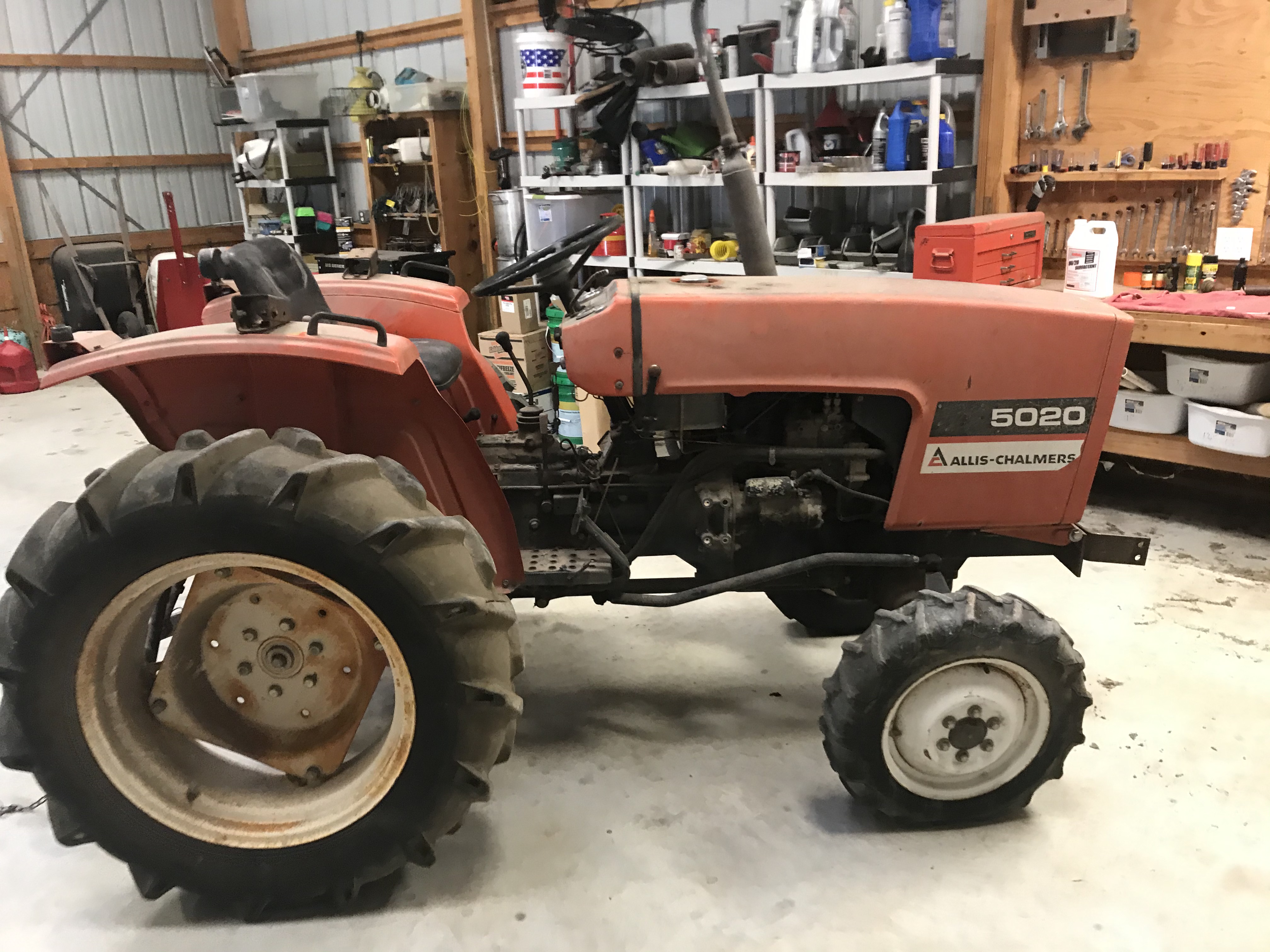

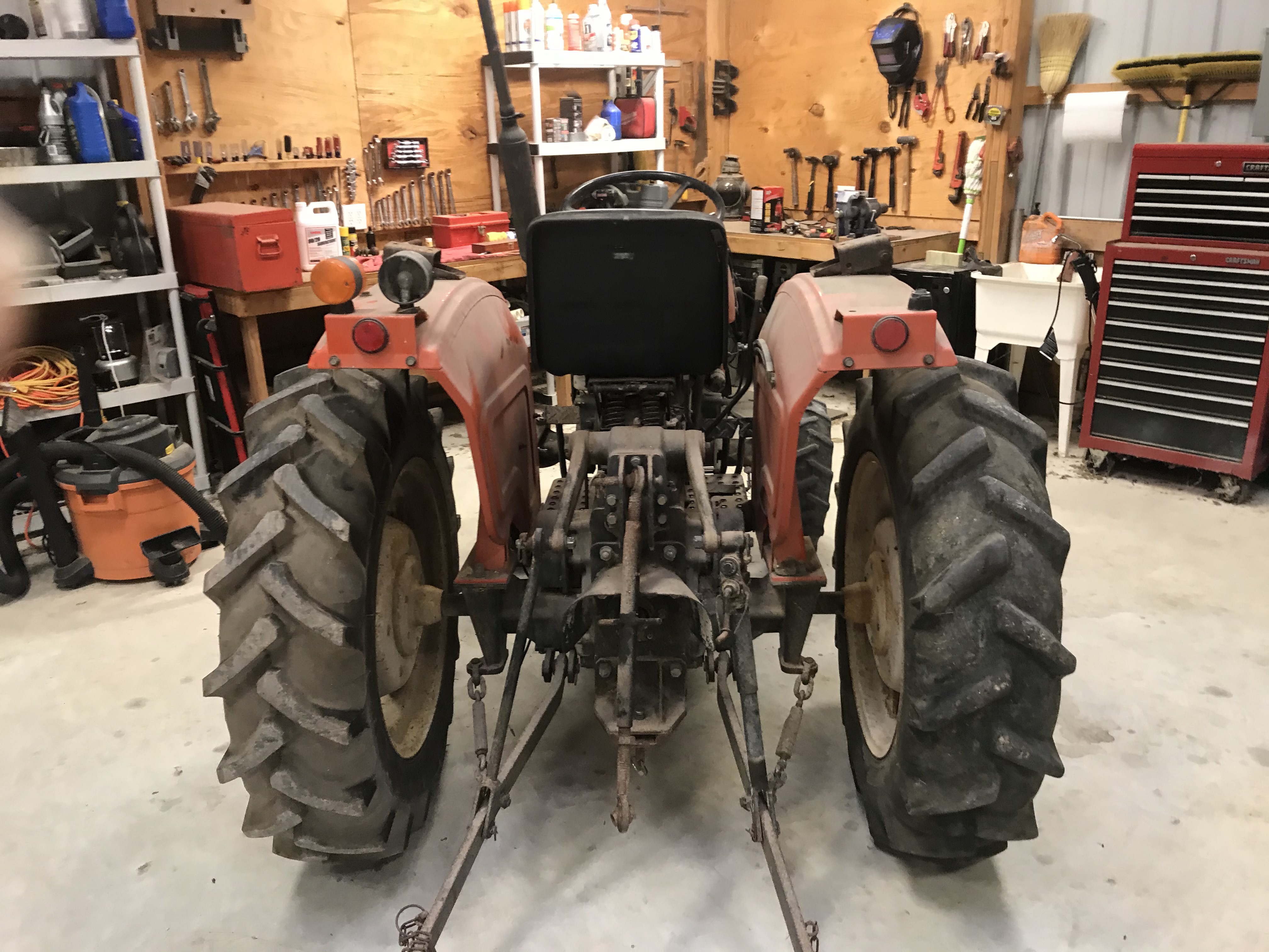

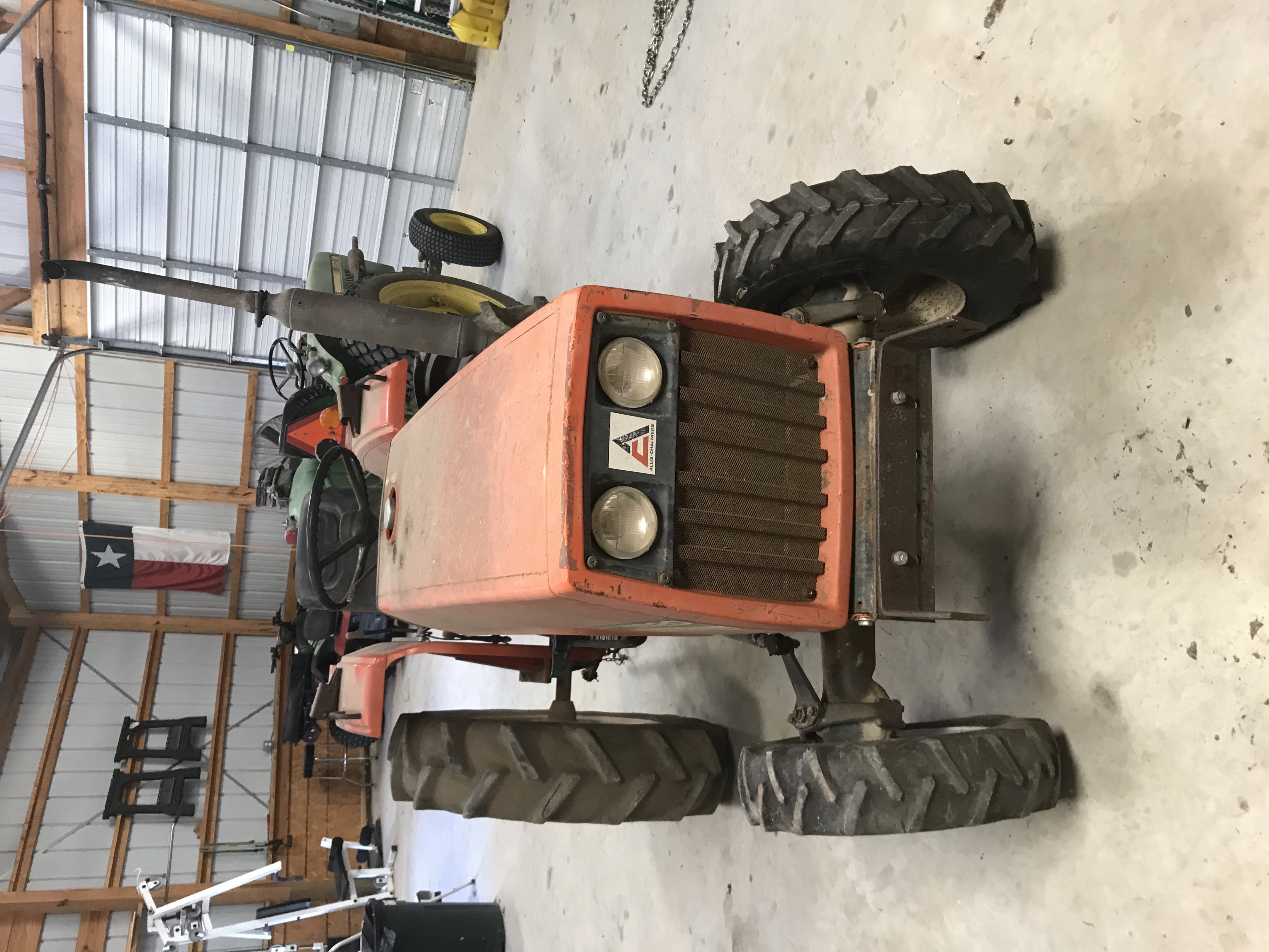

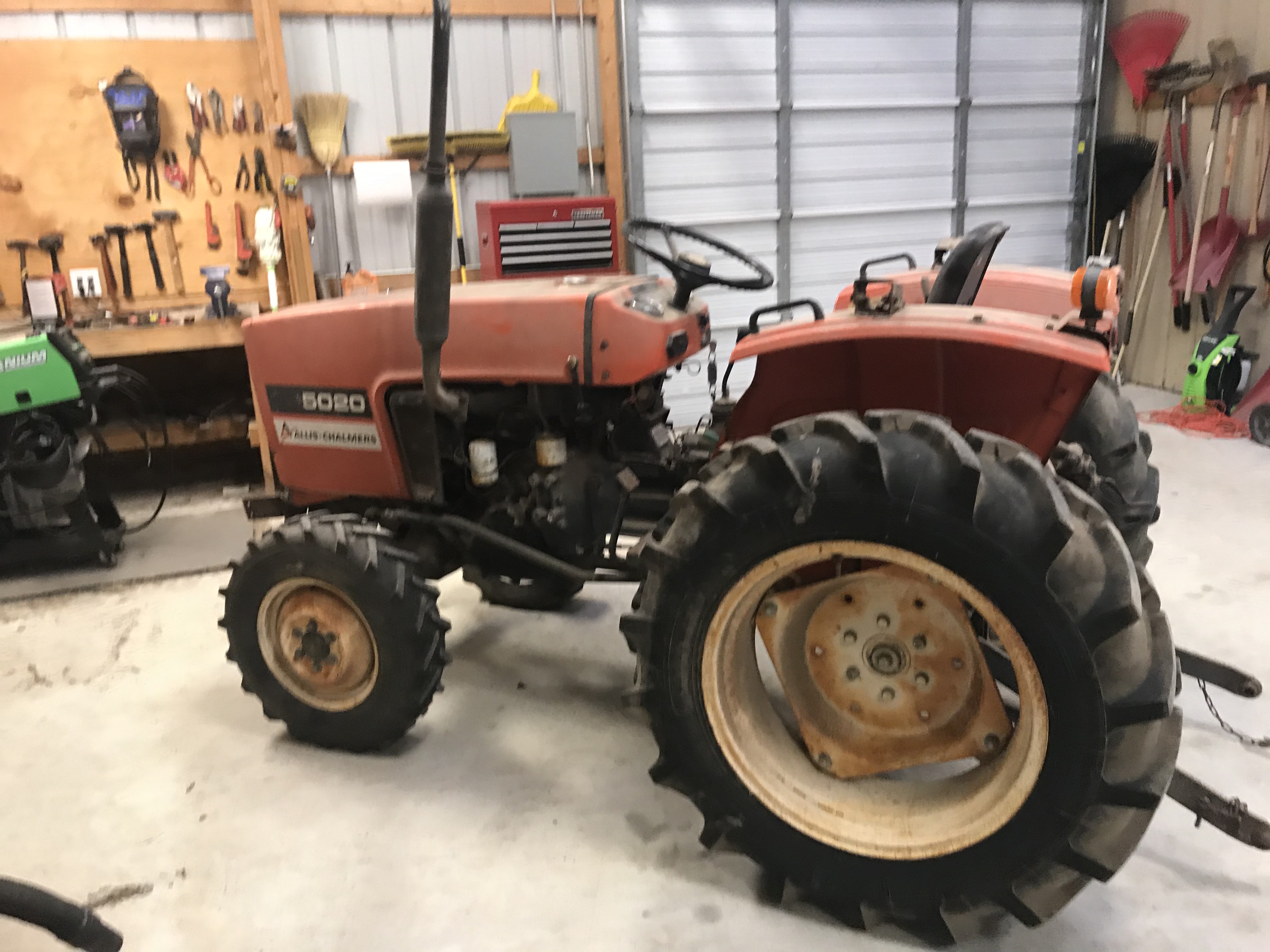

well, I finally got it drug out of the barn it had been sitting in, on a trailer and into my barn. It was not easy. This thing does not roll free even in neutral. Here are some pics. Which links do you want me to measure? 50201.jpg50202.jpg50203.jpg50204.jpg

it looks all original. was it in 4x4? i can push mine when its in 2wd and in neutral fairly easy on gravel.
the link that picks up the 3 point arms, yours do look the same though. good luck. ASAP has some parts availible, i just picked up a muffler, they also have some engine parts.
