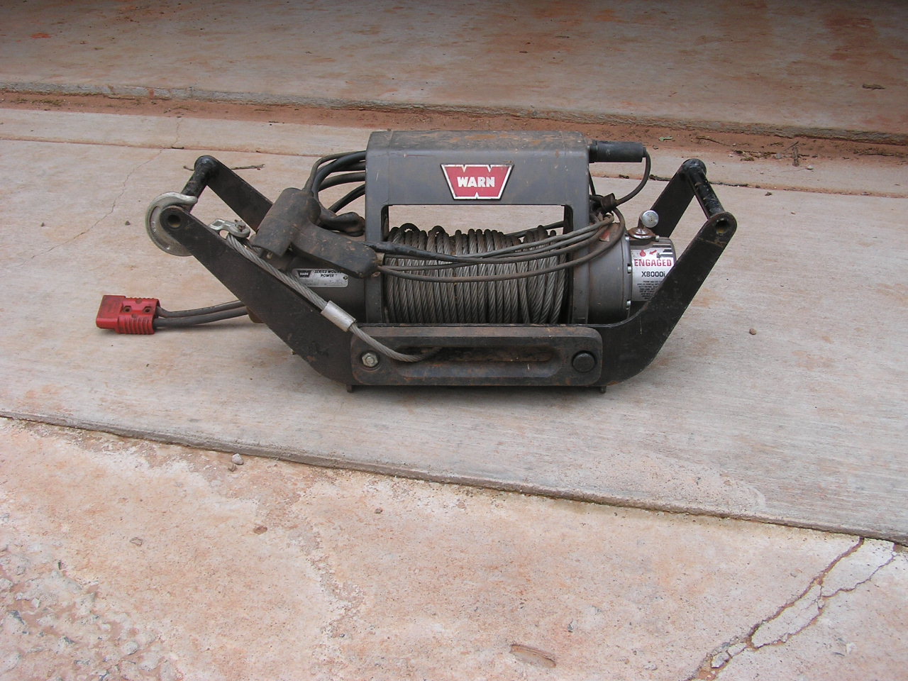

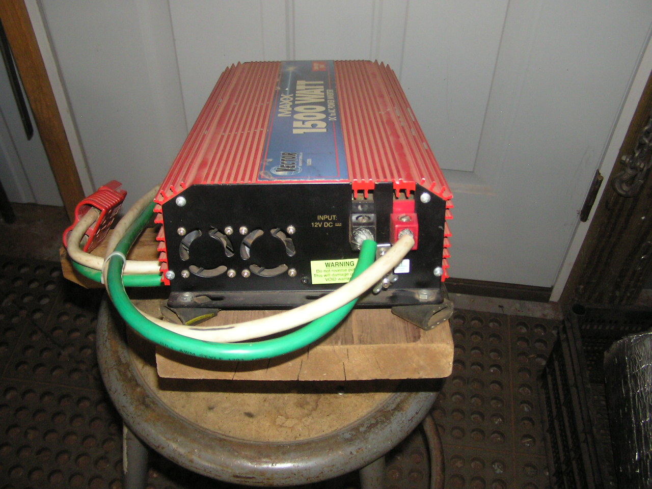

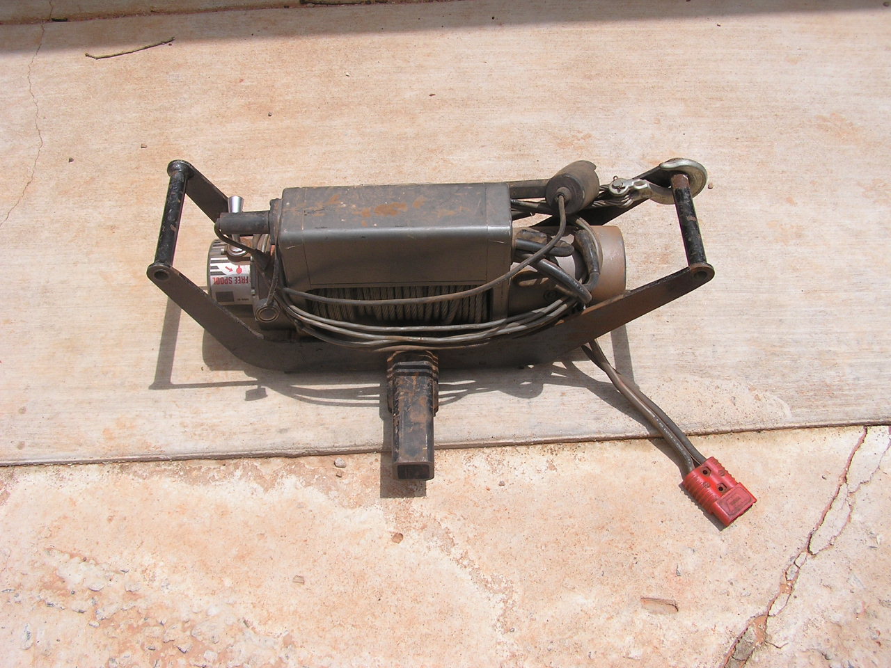

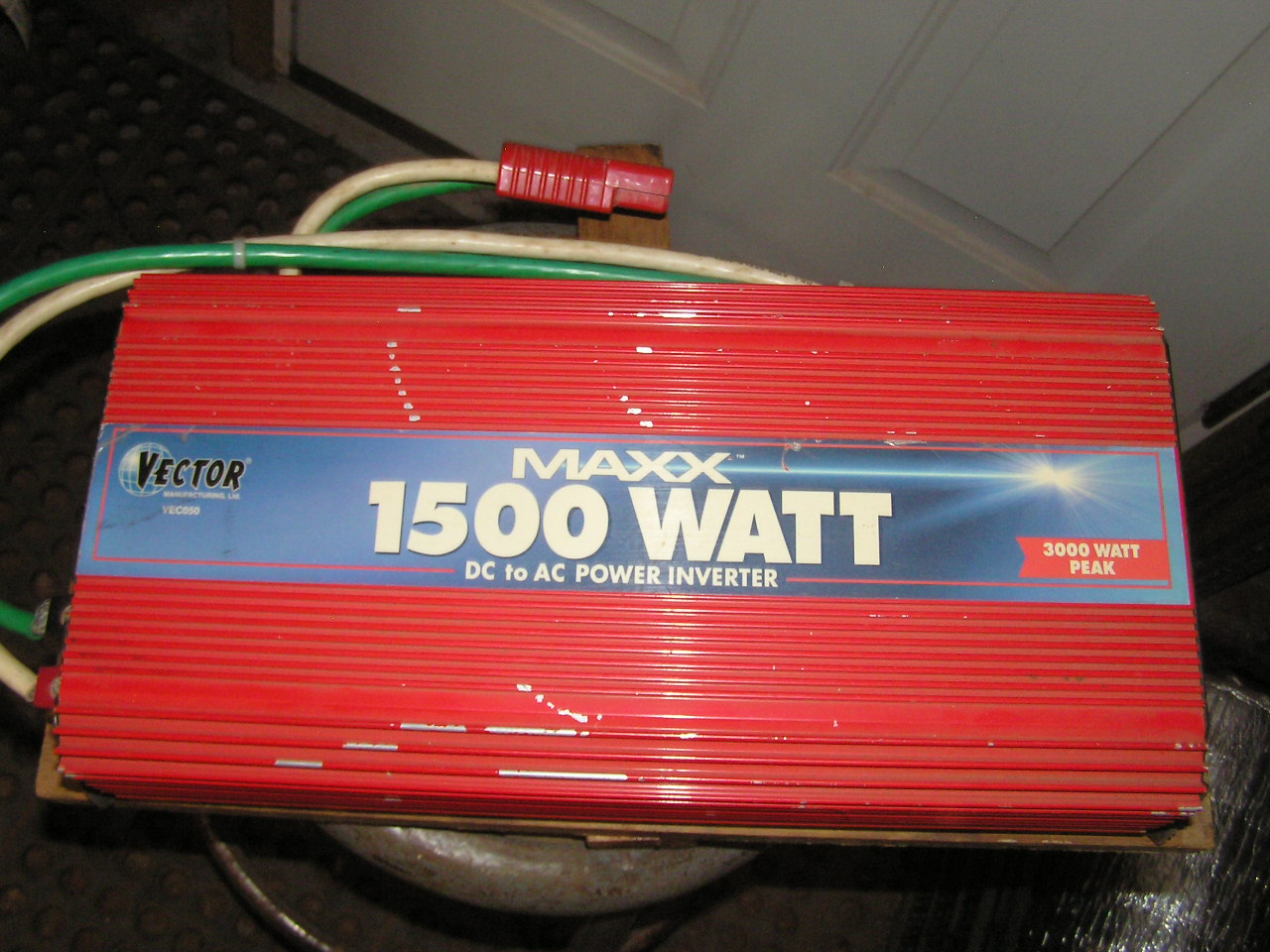

This is what I rigged up with Anderson plugs. It slid into the front receiver hitch on the tractor that I had then:
This came first:

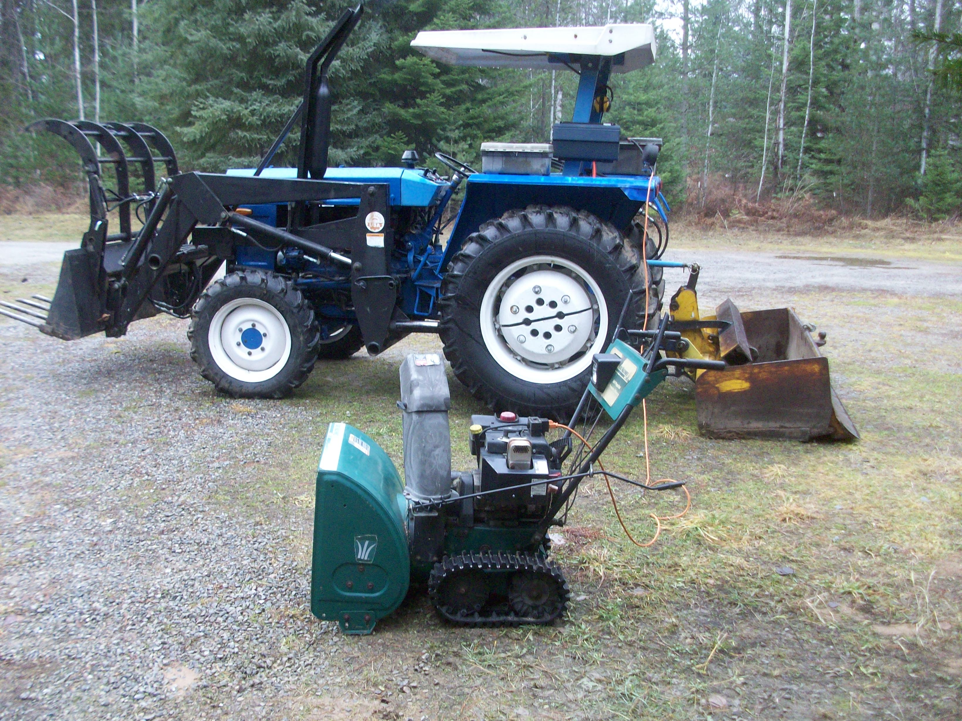

27", 8 horse Craftsman

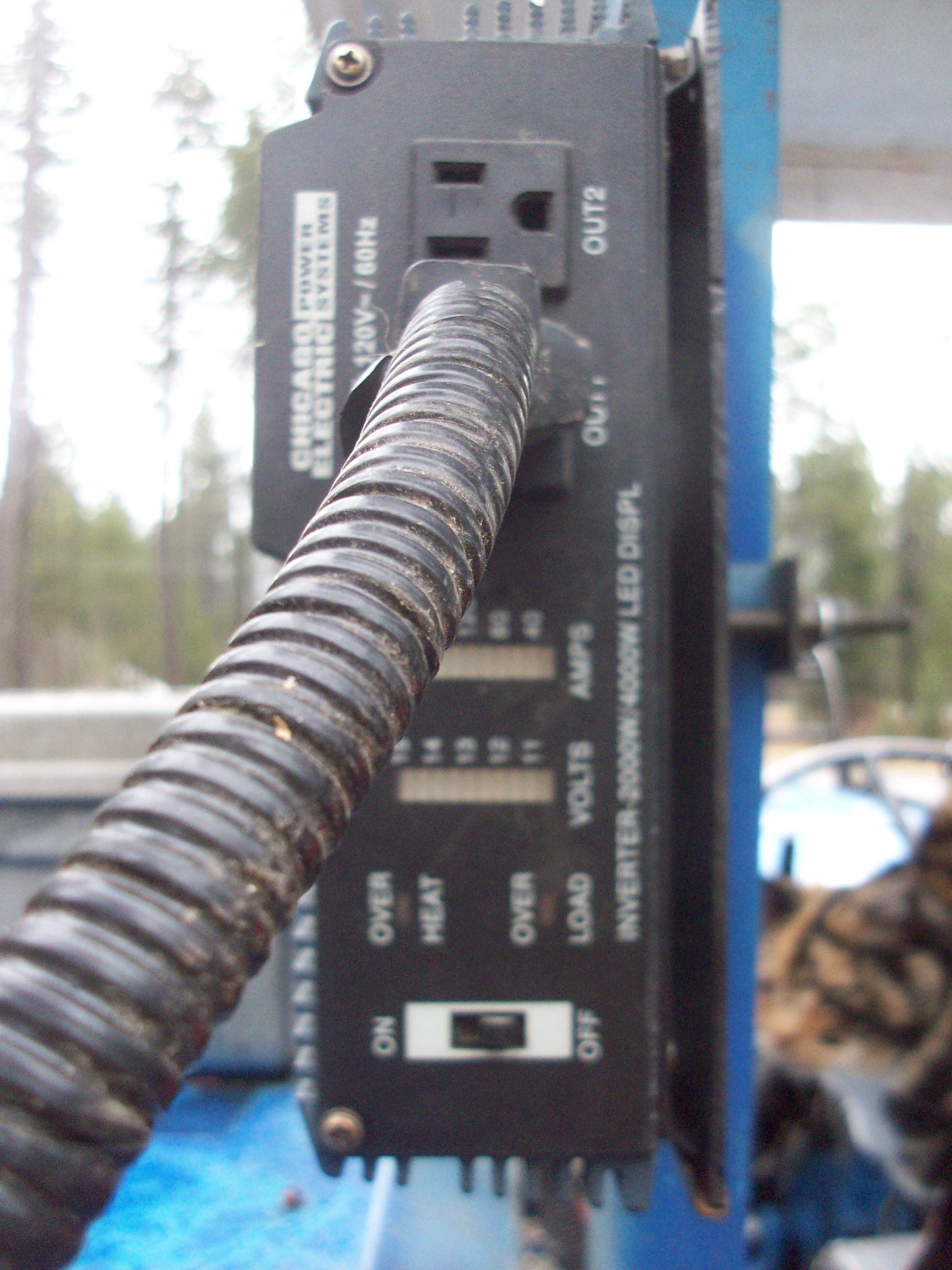

I have a 10 hp Tecumseh MTD/Yardman track drive snow blower with the 120VAC starter and also have a 2000 watt HF inverter I use on my tractor for a 3/4 hp pole saw.- it works fine for that.
If I get a chance I will give starting the snow blower with the inverter a try today... This might be handy extra feature for me to if it works:thumbsup:
I think a 2000 watt rated, not peak watt inverter does work
Will still mount the inverter to tractor and try again- to make sure it is not output overloaded.

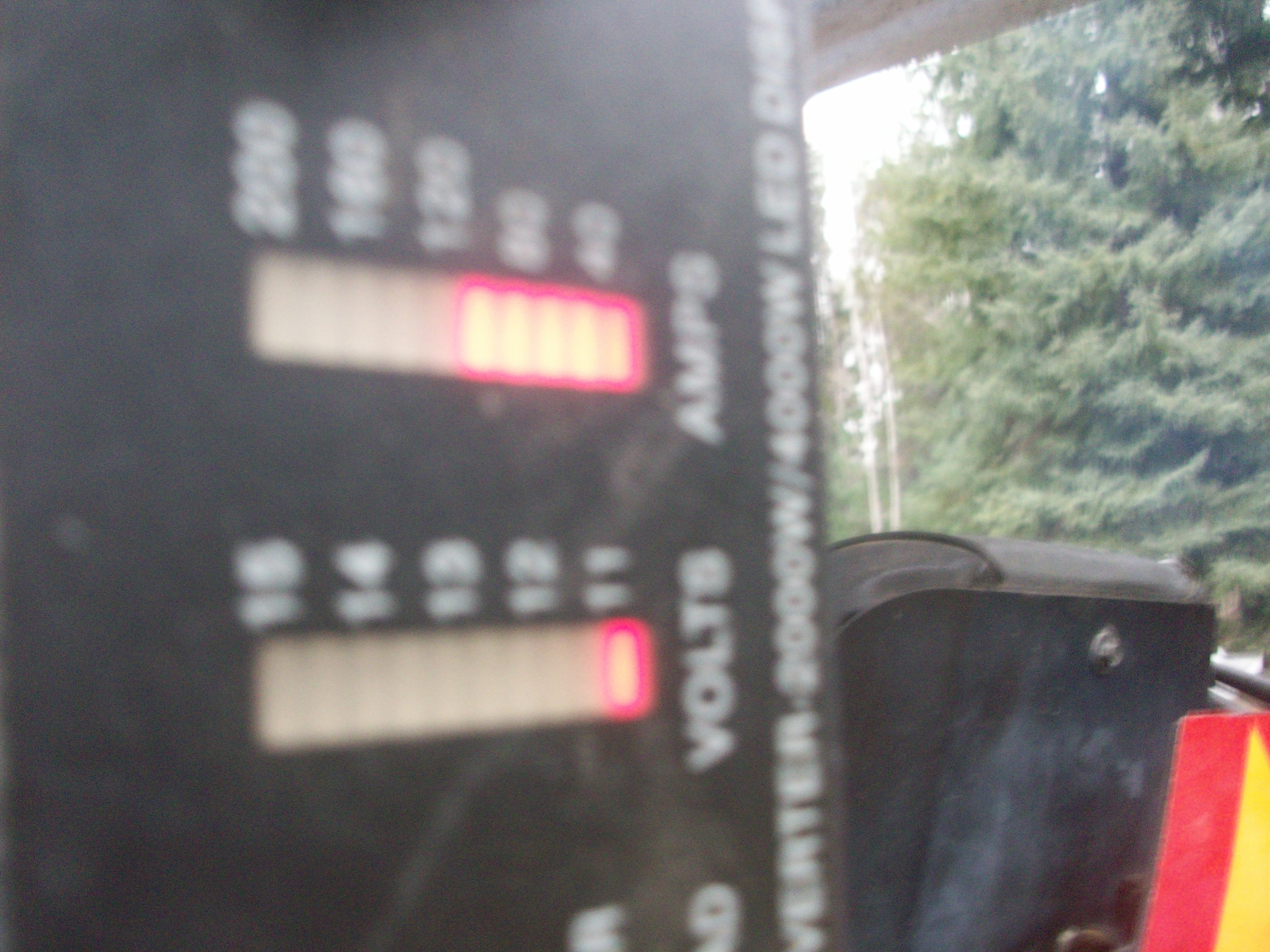

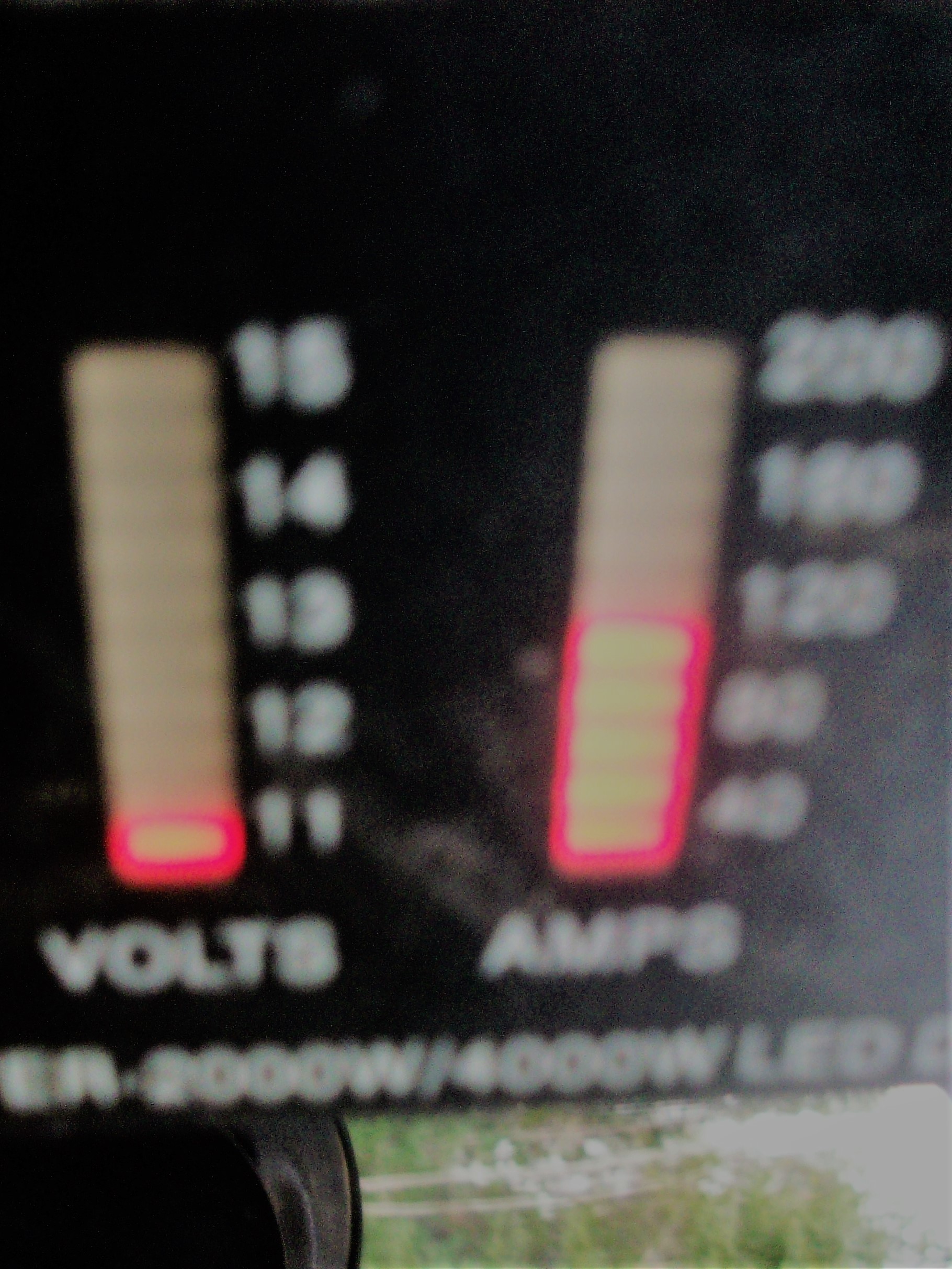

2nd update:
Works perfectly with a 2000 / 4000 watt peak inverter and enough 12vdc to the inverter
Shot of the 12vdc amp draw while cranking with snowblower ignition off:
Looks to be pulling about 100 amps DC current -sorry about the clarity
Need to install real cables for the battery connection

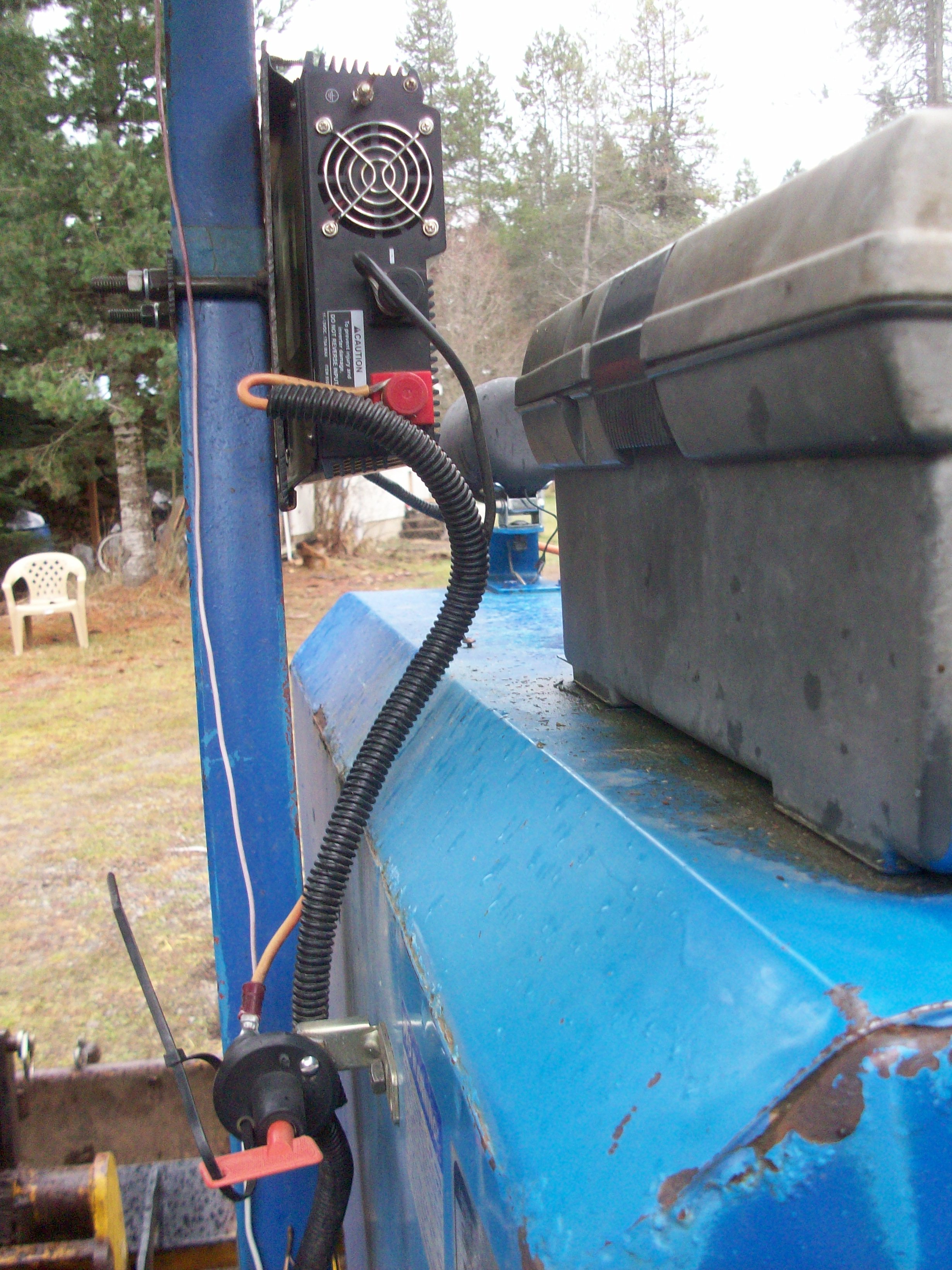

Don't forget to install a inline fuse (or breaker) rated for the line size. If the starter dead shorted you could easily ruin the inverter otherwise. If it will be hard wired, I would also include a cutoff switch for removal or maintenance.
I am installing a 2000w inverter in my 5th wheel, and using 3/0 wire and 200amp inline fuse. A 2/0 wire would handle the load, but a 2000w inverter could draw nearly 200amps. A LOT more in surge mode.
