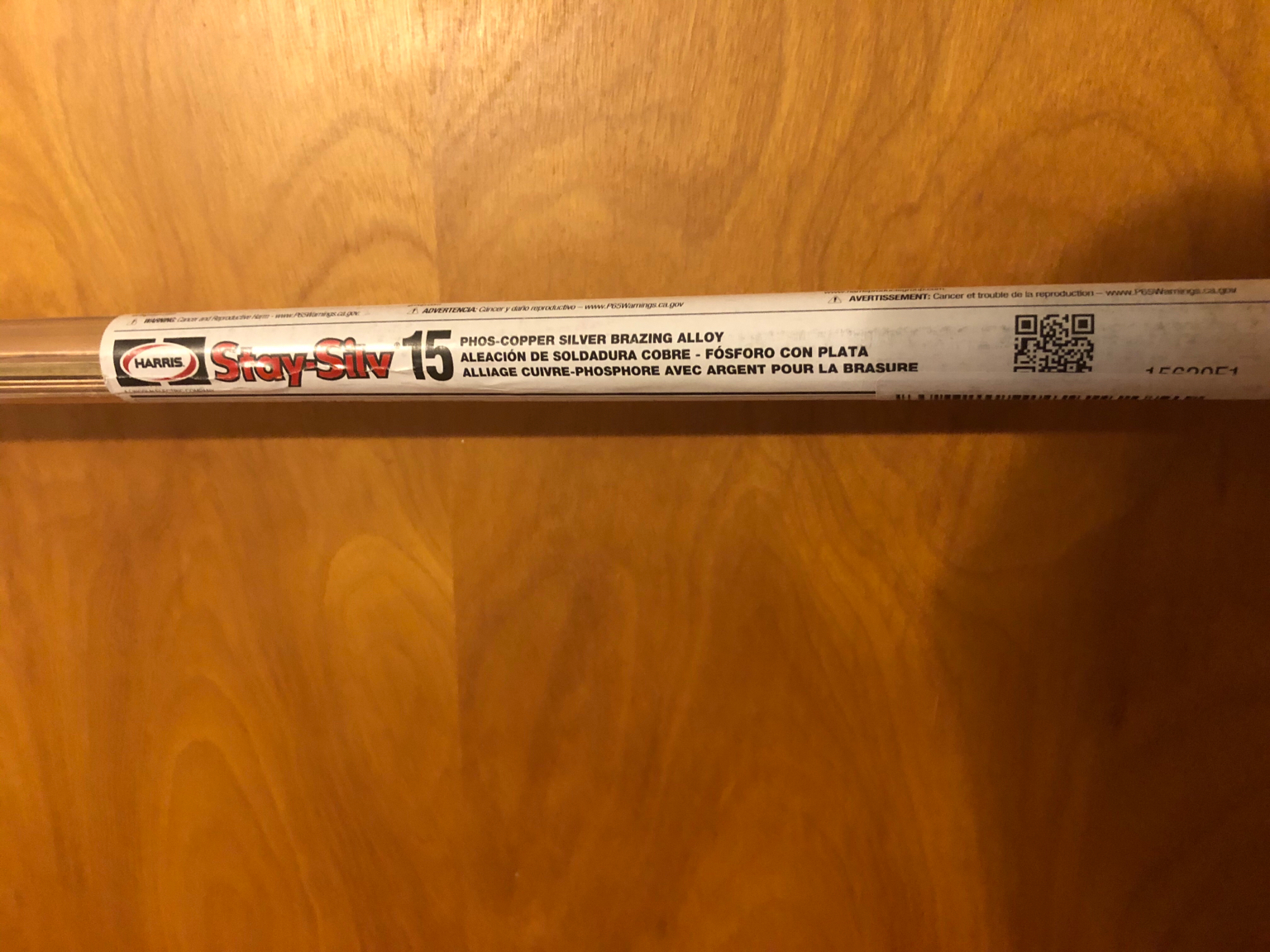

I vote anything with at least 6% silver. Preferably Harris or Weldcote #15 or similar brand. It's an HVAC go to. No flux needed copper to copper. If you want to go high silver, 45 or 56%. 56 has a lower melting temp and both need flux. I suggest the Black flux as it doesn't burn as easy. Good Luck !

For residential solder 15 is kinda industry standard.
I wouldn’t suggest installing a system if you never have before without some guidance first. Best case the system works perfectly and efficiently for 25-30 years, most likely the system sky rockets utility bills or fails prematurely and has to be replaced again in under 5 years.
PM me and I can tell you the procedure, I’m not gonna post it publicly.
But you will need silver solder, torches, nitrogen tank with regulator, pipe bender, vacuum pump and micron gauge etc. Just to name a few tools.
