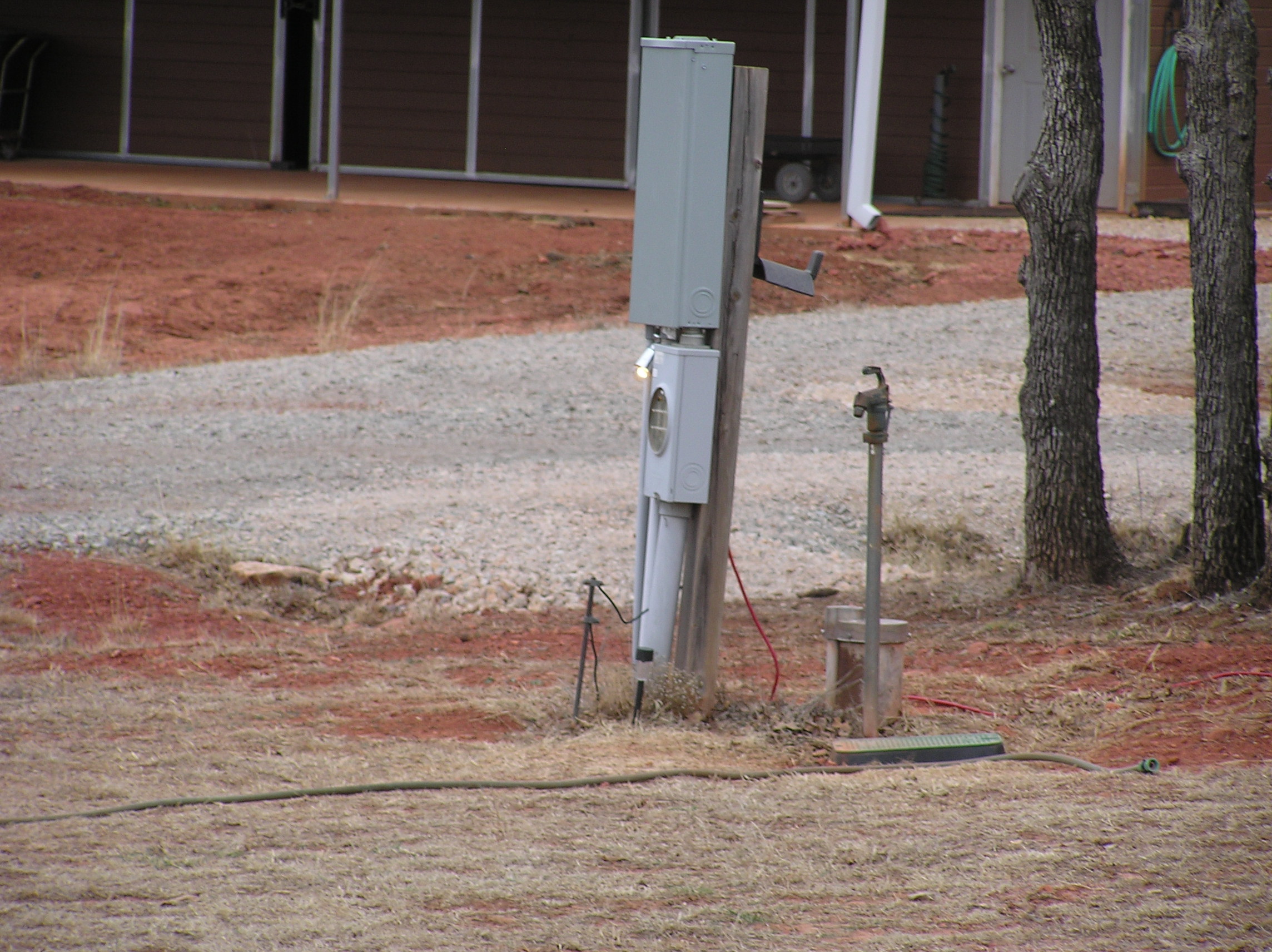

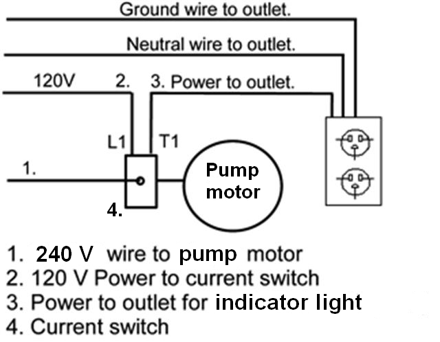

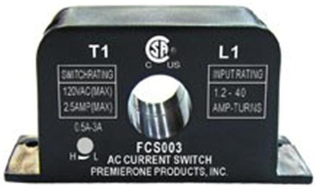

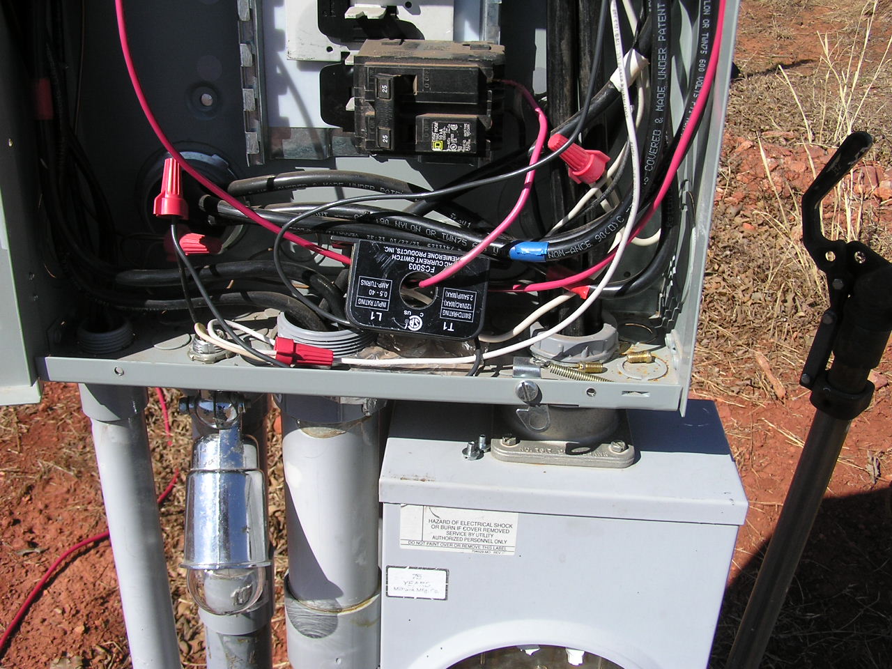

I had the same problem with the horse tank faucet getting left on. Here is what I did, installed an AC Current Switch on one of the two 240 volt wires going to the pump. Whenever the pump is running, the light is on.
View from the house, with the light on.
Inside the breaker box.
Switch and wiring diagram.
Is has been hooked up for over a year now and alerted us to toilet valves not shutting off, toilet flappers leaking and horse tank faucet left on twice! :thumbsup:
