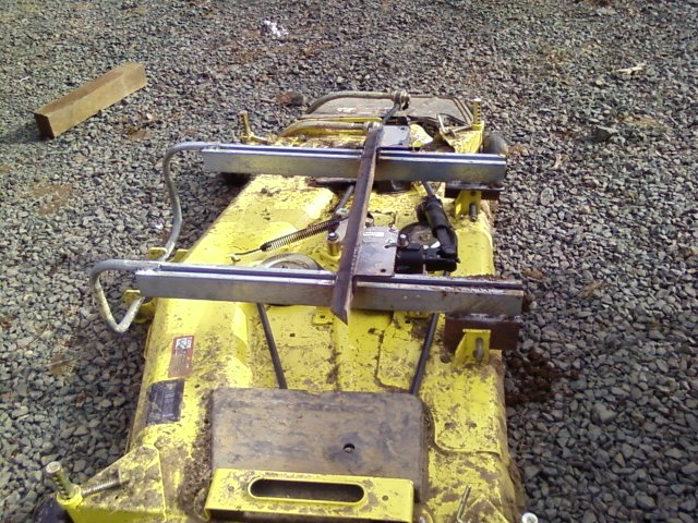

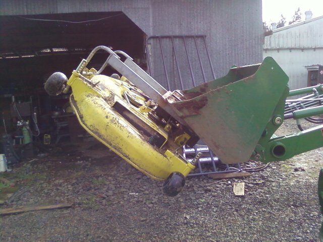

My need was to move the mower. The location to mount and dismount the mower isn't suited for storage. I made a lifting frame out of scrap metal that allows me to easily pick up the deck with the bucket and put it on the storage rack in the barn. Also gives good access to the underside for cleaning and inspection.
Nice idea.
What mower and tractor combination do you have?
   / Accessing bottom of the 62C Mower? #13
62C and 2305 with 200CX FEL.
