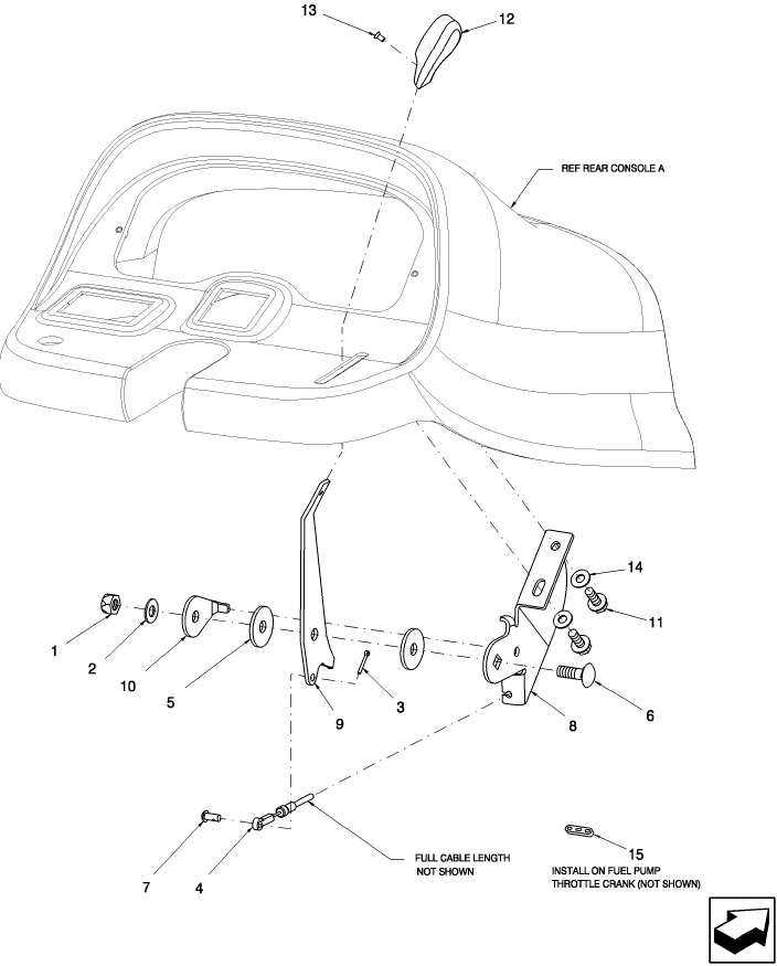

I have a NH T2320 which is basically a TC45. Something has gone awonk with the throttle linkage. The throttle handle is loose and wobbly, can't get the RPMs up to desired setting.
Anyone know the secret to accessing the linkage? Can I access it through the dash panel or do I need to get the cowling off below the steering wheel (and how?)?

To get to the throttle linkage, you have to remove the right side cowling below the steering wheel. There are two bolts directly below the steering wheel and then you have to raise the hood and remove two more on the right side "firewall." Once removed, the cowling will lift out and away from the steering column. The left side comes out the same way, but you have two bolts to remove on that side before you can remove it and expose the relays.
As you remove the right-side cowling, be careful of the key switch electrical wires. With the cowling removed, you will see the toggle at the bottom of the throttle lever and the cable. Then you can troubleshoot why your lever is so wobbly.
As Danocheese mentioned, sometimes the throttle can freeze. I had that recently happen on my tractor and had to manually operate the throttle above the injection pump to get my tractor to stay running when I started it. Once it ran for a few minutes, the throttle cable thawed and everything was normal.
From your description, what I think is wrong with your tractor is the nut that holds the cable to the lever mechanism is probably loose or completely off your lever. I don't believe your problem is down by the injector pump.
EDIT: Here's an illustration of the lever.
Jinman, you ARE the man! :) Just what I needed. Now I need to wait for the high winds to settle down and for a few more degrees of temp. Neg wind chills here tonight, not much better tomorrow. But I digress.
I had taken off the two bolts below the steering wheel but didn't check under the cowling. THANKS again!
And Danocheese, thank you too! I may have to use your method to adjust throttle before I take it apart.
