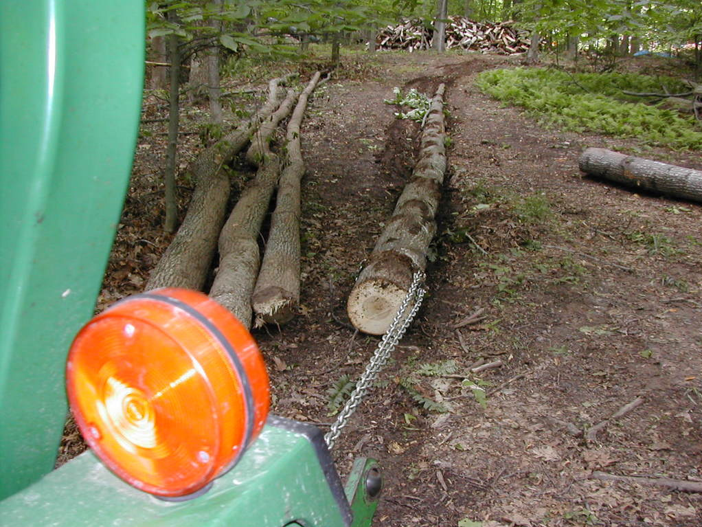

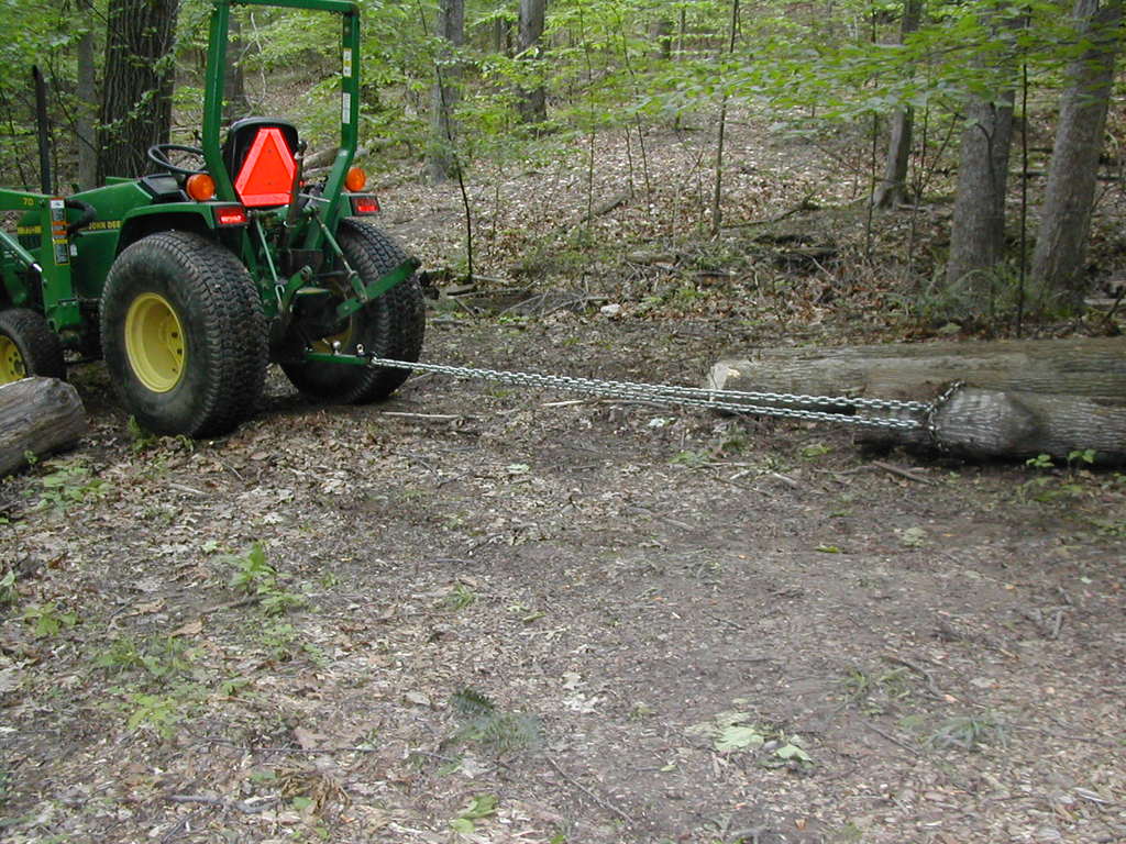

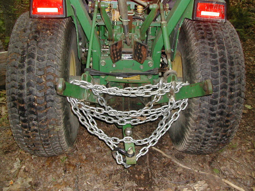

Here are some shots of my clearing task. Skidding tulip poplars - all oak, maple hickory, cherry and maple gets processed for the wood stove.

Nice pics - I have a lot of fun doing that with my 2520. Looks like some good wood. How many acres you working on?

Willl, 'those' is actaully ONE big-*** piece made of plates. It is the bracket for the model 261 5-foot RFM (has rear castors only, front of deck 'hinges off the tractor via chains that hook to this bracket) I use to chop the grass. It also becomes the rear mounting point for that middle link. It stays on my tractor full-time, does not hamper any other uses (so far).

Dead dragging like that with turf treads is surprising to me. I guess they provide more traction than what they look like they can do. Stumps can be a pain especially if you are dealing with one or two and can't rationalize the cost of an operator with a backhoe. I cut the stump as close to the ground as possible, make 1" criss crosses with the chain saw about 1-2" deep on the remaining surface and hog that out with a maddox until below ground level. Works like a real slow stump grinder but hey when you're retired, everything works real slow.
/ Action - 770 skidding
Dead dragging: it works the machine, no doubt. 250 lbs of windshield washer fluid in each of the rear tires really helps tractive effort. But I use LO range, then engage MFWD, and then lock the diff if needed. If the tree gets hung up or otherwise refuses to move (only one did this so far), I break out the saw and make it smaller so it can be pulled.:D
I have no doubt R1's would really pull but the machine does everything pretty well and doesn't harldly leave a mark. My last tractor had 4 ags on it but marred everything all the time and I hated doing anything in soft soil conditions. The 770 pulls better than the last machine (B7100) only by merit of its weight.
