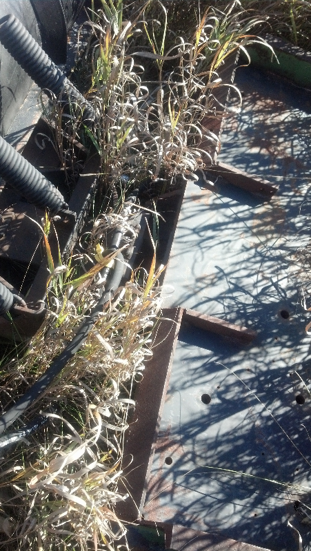

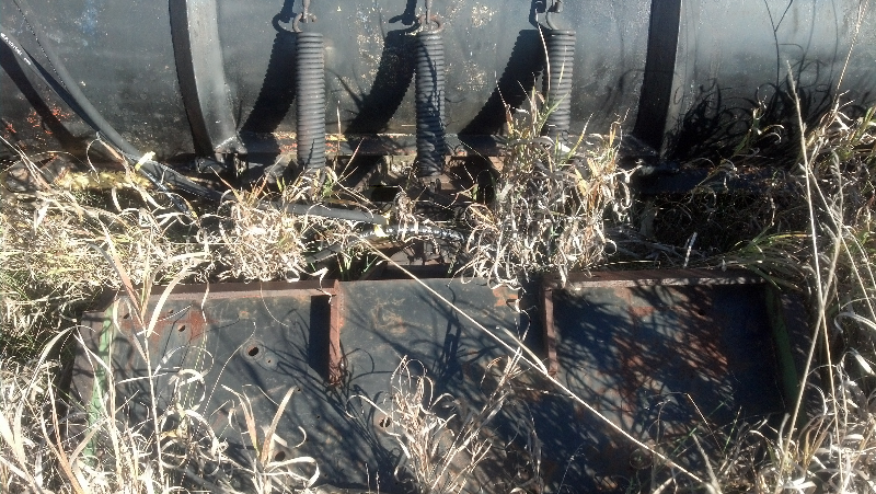

When converting my dads we welded the QT plate flat on the A frame for the plow. This allows him to lift the blade vertical to make more room in his shed. I'll post pics if I can get over there soon.
Wating for the pics........E
   / adapt a plow to a QA #13
Haven't gotten over there yet. Sometimes life just needs to slow down and realize I have things to do.
   / adapt a plow to a QA #14
Sorry about the weeds. Best I could do for now haven't had to use it yet.
