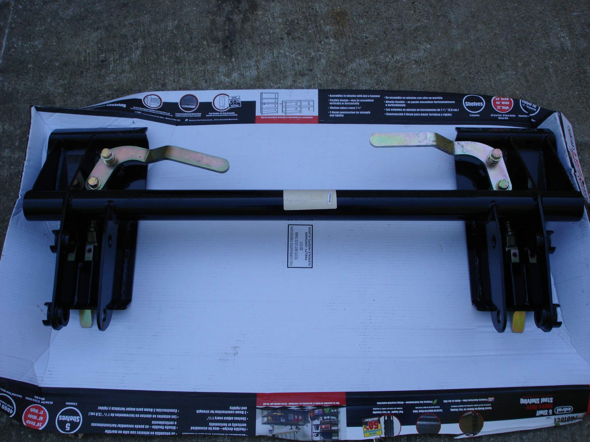

Just picked up my Quick Attach for the older KL130 from my dealer. This setup is made by Kioti, I will post pictures when I get a chance.

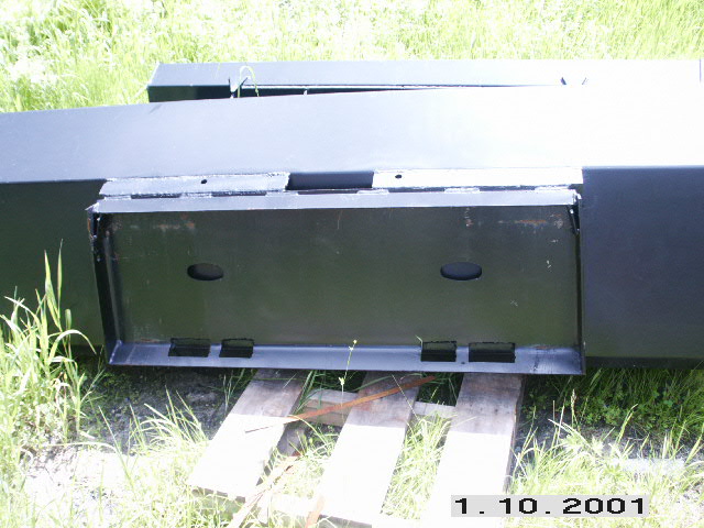

Hi Victor, from looking at the pictures of the new QA and mine, I think it's the same thing. Now...to get creative and convert my bucket... See pictures

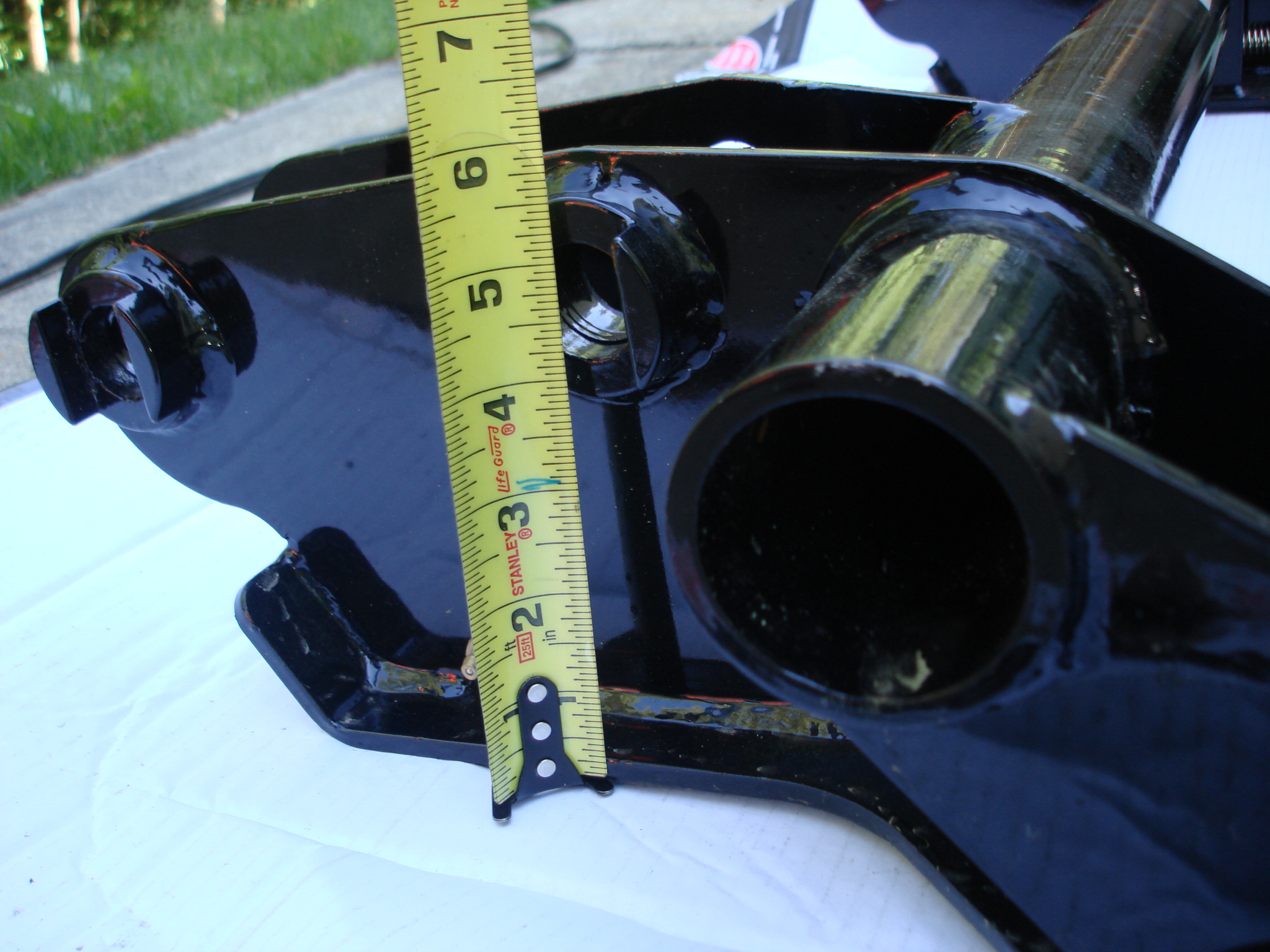

Hi Gus, From the pictures, I think you made the right choice. You're only moving out 5 inches instead of @9 inches and the unit seems to be built more equal to the @1200 lbs. lift that we have which saves weight.
Kioti Dave mentioned a good way of getting things set up for the bucket plate. Once you get the old flanges cut, the worst is done. Or should I say you're beyond the no return point. Just kidding. :) I'm sure once you get started, it will come together without much worry.

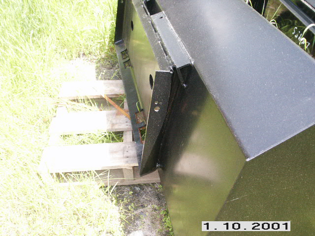

Here are a couple pictures of an 84" bucket we converted with the heavy adapter plate. You just want to make sure you get enough dump angle to empty the bucket, also tilt back to be able to fill the bucket. Kinda have to ride the fence and average it out.

Thanks for the pictures. I still haven't gotten the courage to tackle the bucket, as mine is round on the back and the bracket needs to be welded onto the four ribs after they are trimmed to the proper angle. I have an add in craigslist looking for a used skidsteer bucket. I am presently looking and almost ready to purchase a 3 POINT ATTACHMENT ADAPTER, so I can use my attachments for small jobs without taking off the backhoe. I can visualize all sorts of home made attachments for that thing... like my old cement mixer, snow plow, rake, forks, etc.
