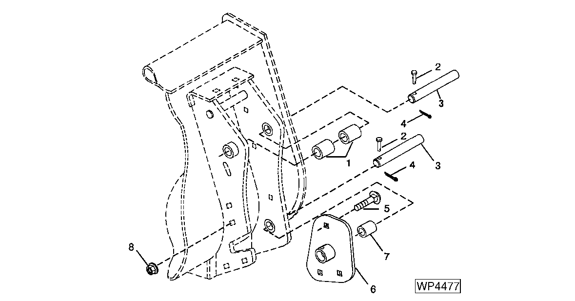

How does the width of your 146 loader arms match up to the 600/700 series bucket? If they match, I would remove the bucket latches and modify the bucket mounts to take two pins like your bail spear. This would not be quick tach, but a lot cheaper and not add a lot of weight to loader. I think JD parts has sells a piece that replaces the latch plates with a side plate for the cross pin. Not all loader buckets were quicktach.
For Hooks, I got some steel plate 4" x 5", welded a hook in the center and drilled bolt holes to match the two slotted holes a the top of the bucket mounts and bolted them on with grade eight bolts. this puts the hooks inline with the loader arms so you are less likely to bend the loader masts or spring them.
   / Adapting a JD series 600/700 quick tach loader bucket to a JD146 loader? #14
kennyd, would you post the picture from JDparts of the pinned bucket attachment?, that might help show how he could use mount pins like his bale spear to mount the bucket. Just replace the latch plates with the part for the mount pin and get a piece welded back in where it's cut out on his mount for the top pin.

I am thinking if he gets the part that goes in place of the quik latches and fabs up what got cut off so he can mount a top pin he could make it work only it would not be quik tach. That's if the width of his loader matches that bucket mount spacing. If it's close, maybe just play with the spacers on each side of the pins.
